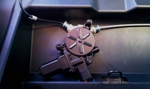

    Does anyone know where to get those 90 degree plastic pieces for the cables?

    You can only get that piece if you get the actuator from a Honda Rdigline.

    Perfect thank you

    The Impala motor I used came with a similar piece, but I couldn't find a secure way to mount it so I ended up scrapping it and making my own.

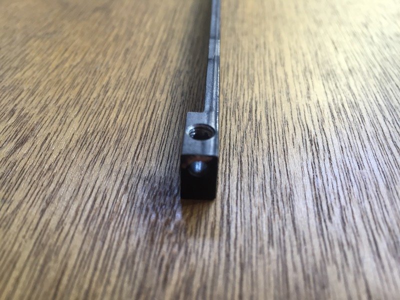

    I think I may go with the impala motor since my local scrap yard sells it for $10. Now I just need to find out who can make the window bracket for me. Does anyone have a good picture of how the cables attach to the bracket? I looked at the design sheet for the bracket but couldn't really tell

    From what I could tell of the drawing BenWa provided there is a clearance hole in each end of the bracket that the cable slips into and then an intersecting threaded hole that you use a set screw to lock the cable in place.

    So, we build a new bracket. It sits in a channel. The glass sits on the new bracket. The bracket slides back and forth.

    The glass doesn't sit on the bracket. Bracket fits around the glass.

    Much better... The drawing I have shows a mislabeled view.
