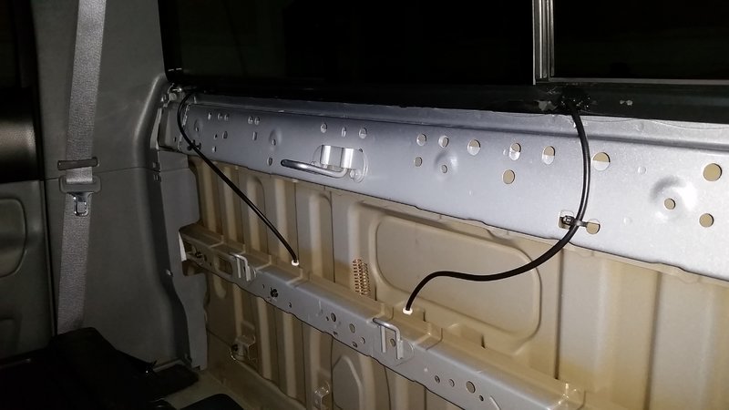

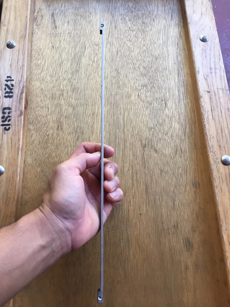

    You talking about Benwa's bracket?
    It sits between the glass and the trim, pretty much in the channel.
    Did a test fit. This thing fits snugly. I got this one from him when he was selling off what he had left.

    Good pics.. How far back is each cable end supposed to be stripped?
    Around 13"?
    Thx
  4. Feb 12, 2016 at 5:35 PM
    #1604
    adio
    adio Well-Known Member
    Sep 11, 2008
    #9165
    2,637
    HI
    2015 INFERNO TRD PRO
    In regards to how far that back glass travels?
    I don't think it matters, that back glass can only travel left/right at a certain length, but you do have to put enough tensions on those cables though.
  5. Feb 12, 2016 at 5:38 PM
    #1605
    amkaos
    amkaos Well-Known Member
    Sep 6, 2015
    #163583
    357
    yeah, it has to be stripped back the same distance as the travel, right?
  6. Feb 12, 2016 at 5:45 PM
    #1606
    adio
    Sep 11, 2008
    #9165
    2,637
    HI
    Technically you don't need to get those cable at an exact length. Give it enough slack to where you can put tension in them.
  7. Feb 12, 2016 at 5:52 PM
    #1607
    amkaos
    Sep 6, 2015
    #163583
    357
    But each cable end has to be stripped where it enters the channel and attaches to the new bracket?

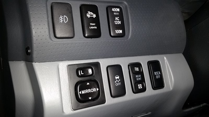

    Wierd request. Does anyone have a picture of the Sienna vent switch without the rocket cover on it? I ordered one and it arrived as a "some assembly required " kit. I have these 2 little metal connection tabs and I'm not sure which way they go in the switch. Thanks for any help!

    How did you wire that switch up?
    Does it fit well?
