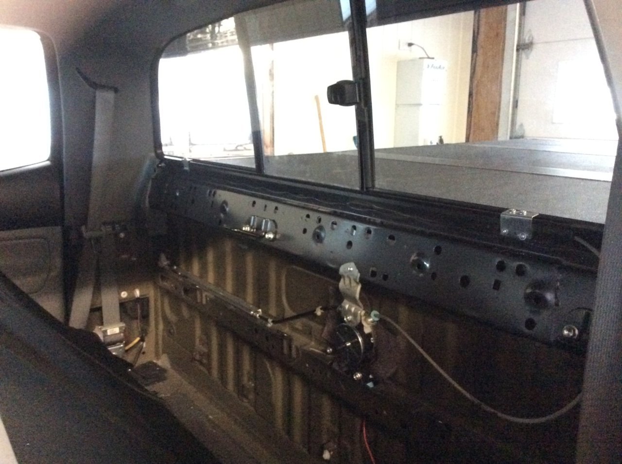

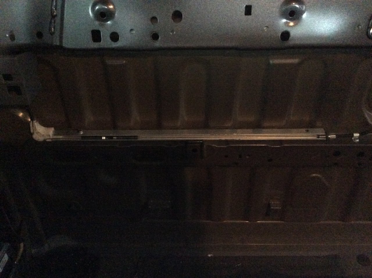

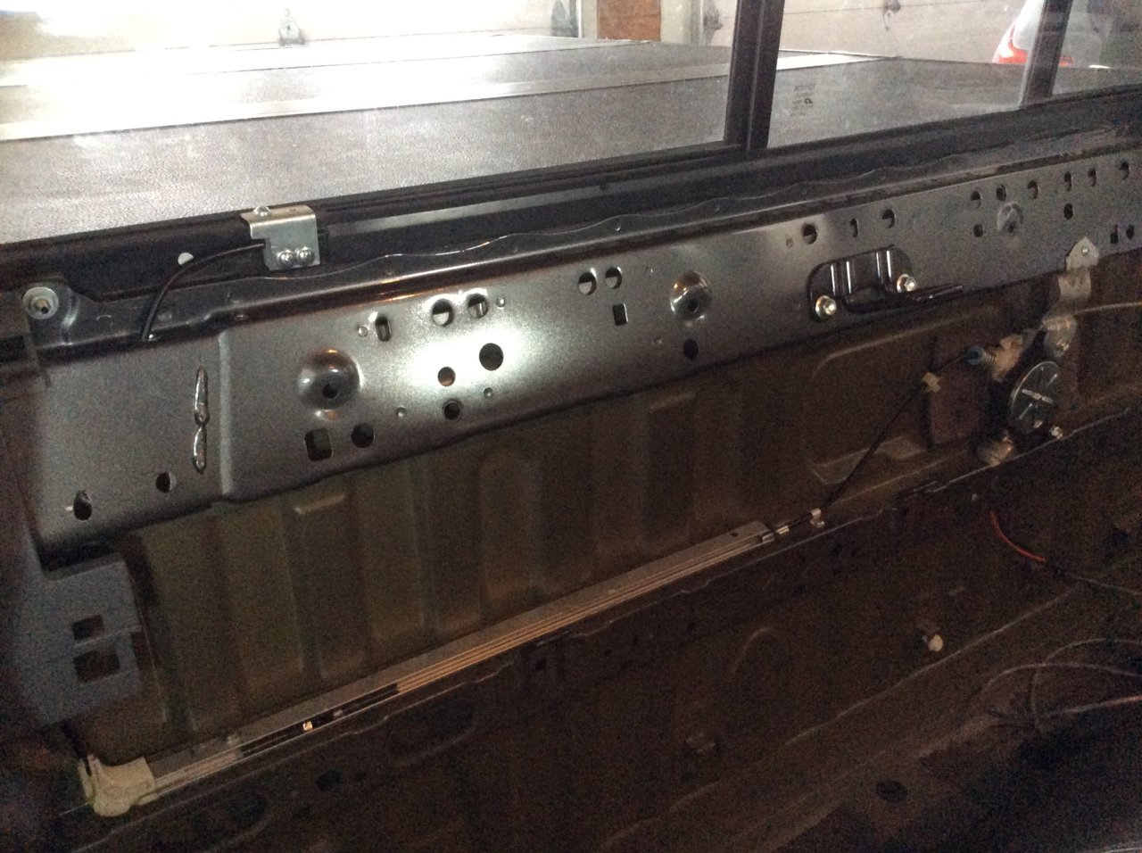

    If anyone interested....i was able to complete this mod completely hidden using all the parts (including the track) from the honda ridgeline motor. All without modifiying the cables from the motor

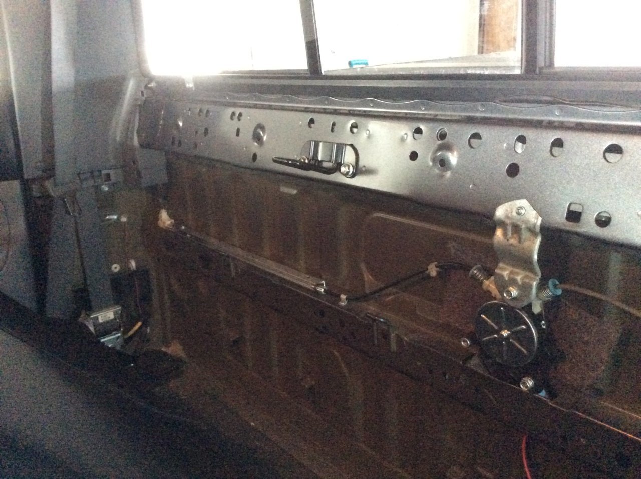

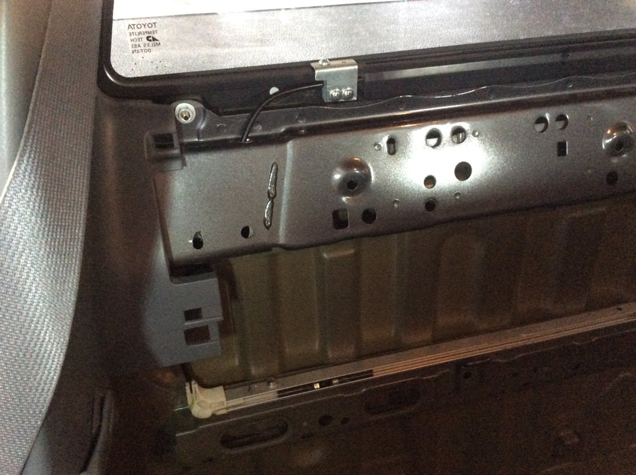

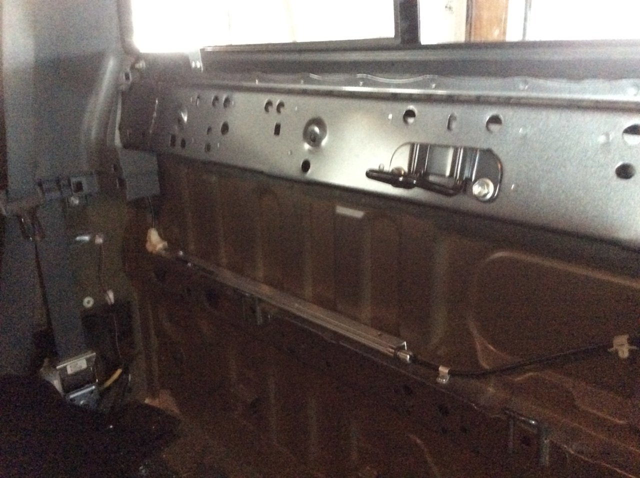

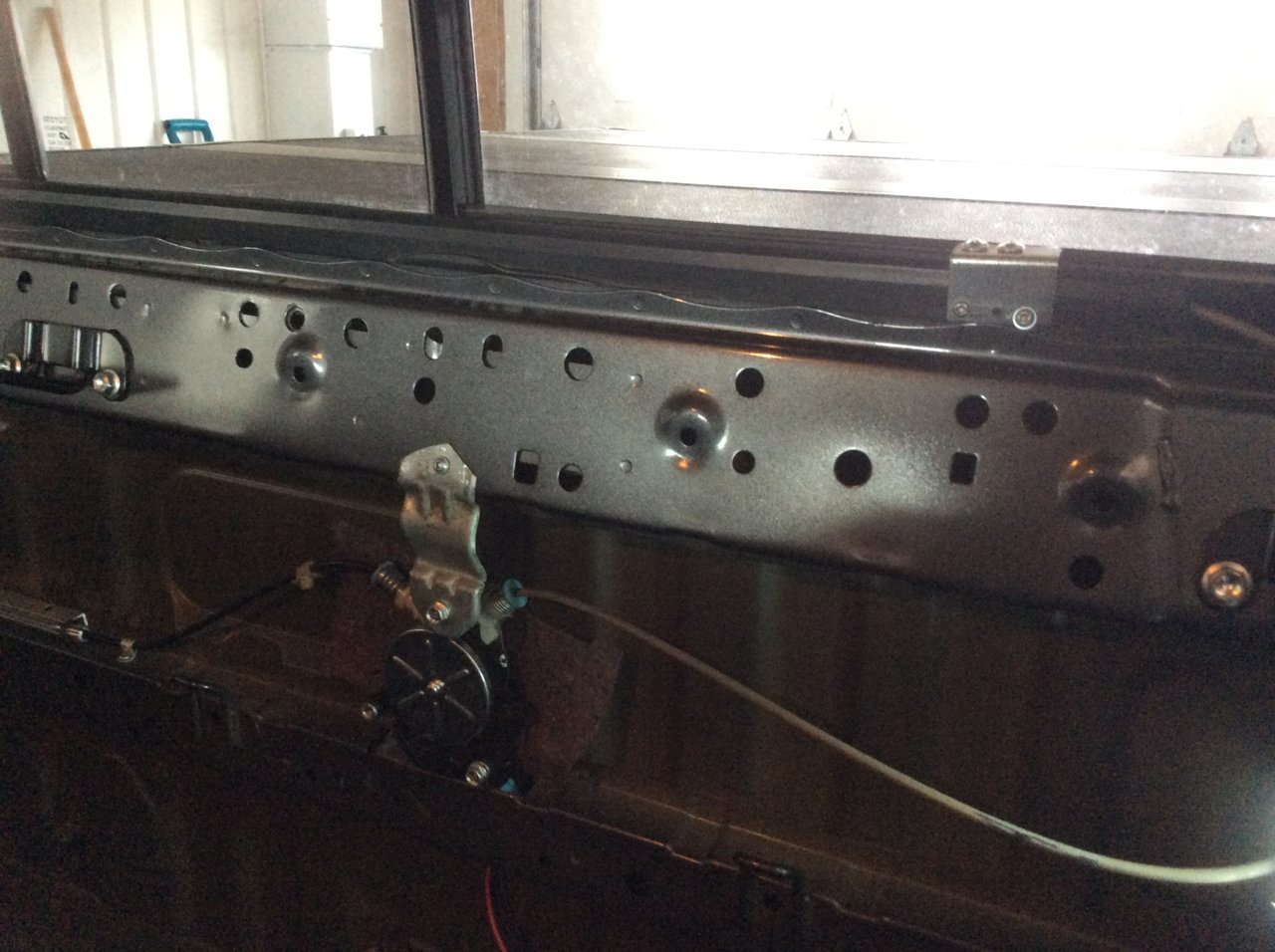

    Check these out

    This is nothing new here guys I did not re invent the wheel .... ALL the hard work has been done by the founder...BenWa..... And others who took his idea and modified it. I just read ALL the posts and took some ideas here and there. The one thing i did create was comming up with a way to hide the motor using the existing alluminum track without having to open the motor and mess with the original cables. The alluminum track acts as en cable extender so that the passenger side cable is long enough considering where the motor is placed.

    Only thing needed is an extra good quality cable about 32inches long ( Motorcycle throttle cable stainless and flexible)

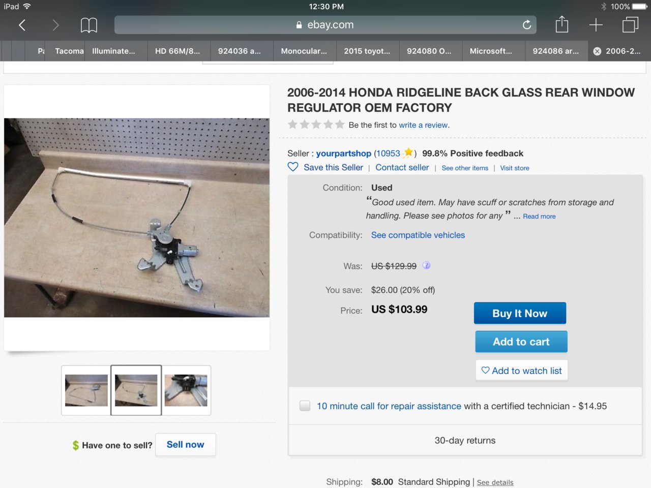

    @Poitrasbh Do you have a part # for the ridgeline motor you used? Did you use a motor from a 1st or 2nd gen Ridgeline?

    @Toy4me Mine came off a 2008 Honda Ridgeline but the ebay posting said it 2006 07 08 09 10 11 12 13 14 Honda Ridgeline Back Glass window regulator (interchange part Number 185-50102)

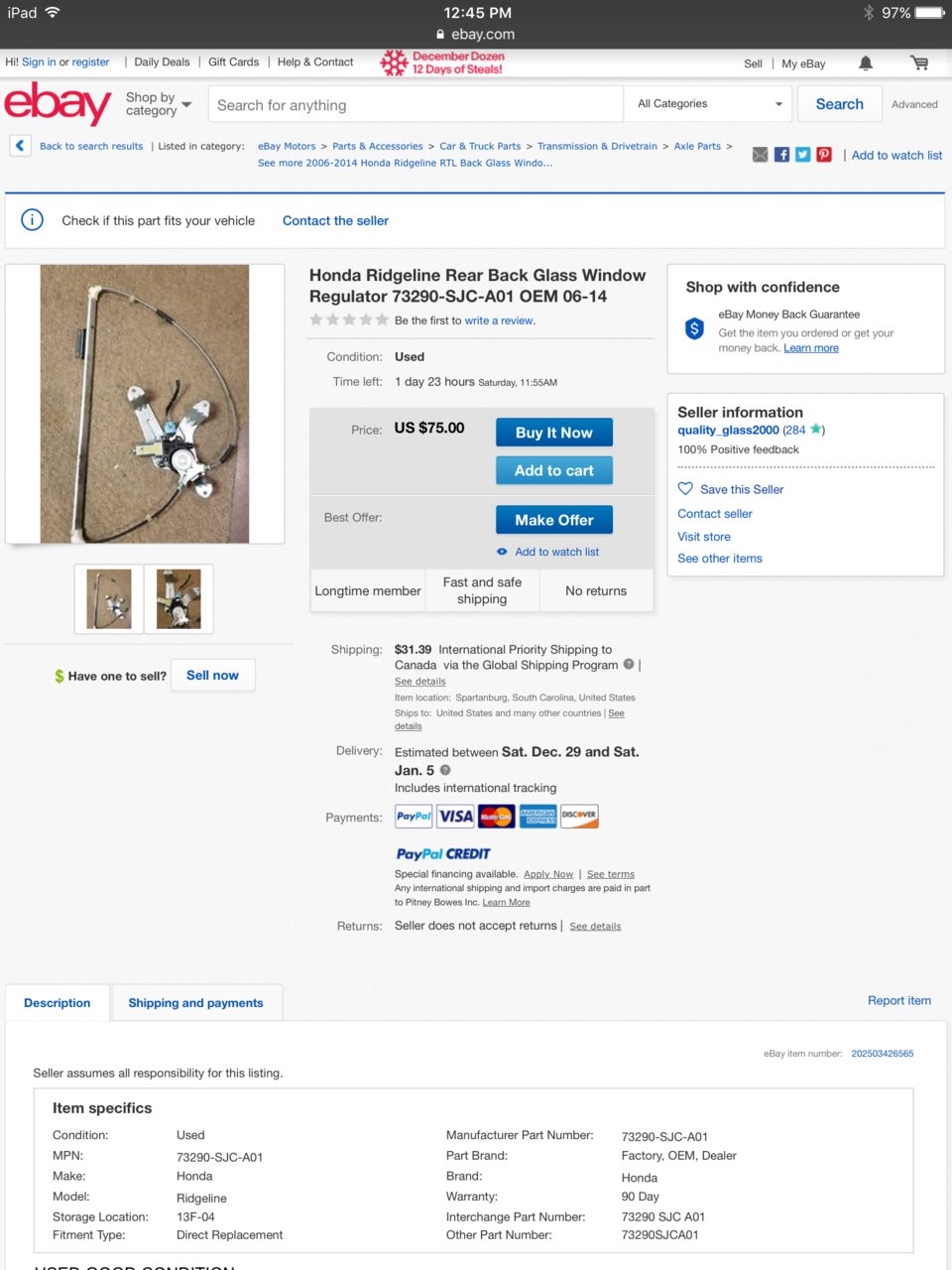

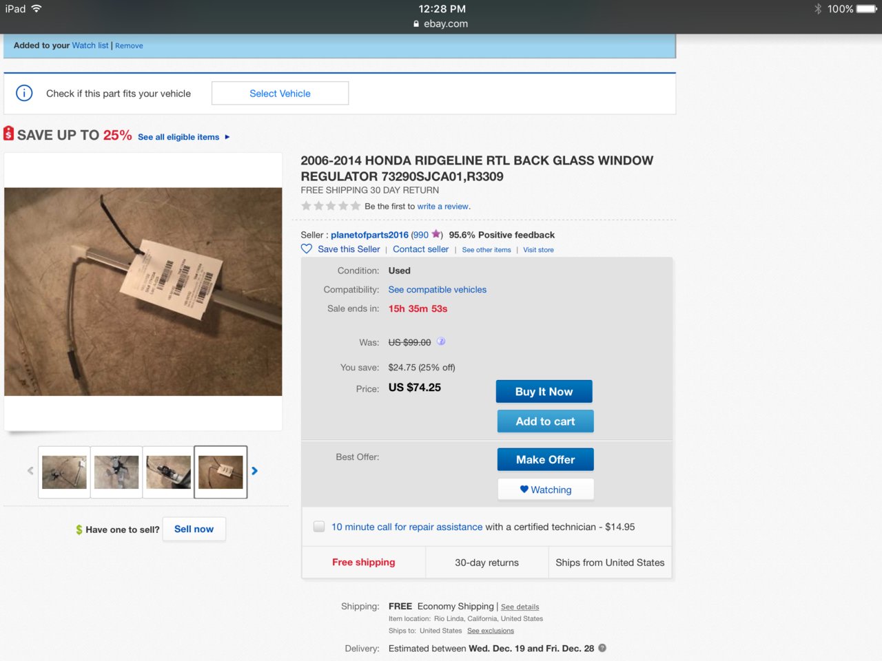

    @Toy4me check these out
  18. Dec 13, 2018 at 8:52 AM
    #1798
    Poitrasbh
    Poitrasbh Well-Known Member
    Oct 7, 2018
    #268628
    77
    2015 Charcoal grey Tacoma TRD
    @Toy4me @Toy4me
    I had to search for some time to find this specific motor regulator. I just entered into google the following: honda ridgeline back glass regulator and was able to find a lot mor than just doing the search on ebay.
    This pic has the item # listing at the lower right hand corner and it comes with the plug in

  19. Dec 13, 2018 at 8:55 AM
    #1799
    Toy4me
    Toy4me Well-Known Member
    Aug 19, 2012
    #85061
    3,738
    Tom
    NNJ
    '10 DCLB TRD Sport MGM
    Thanks so much. That’ll make searching easier. I just kept finding regulators for door glass. Just paid @kgarrett11 for a bracket (thanks for making these available Kyle). Gonna get all my parts bought and ready for a spring install. Can’t believe the switch is like $50. Guess all in this will be about a $250 mod and worth every cent.
