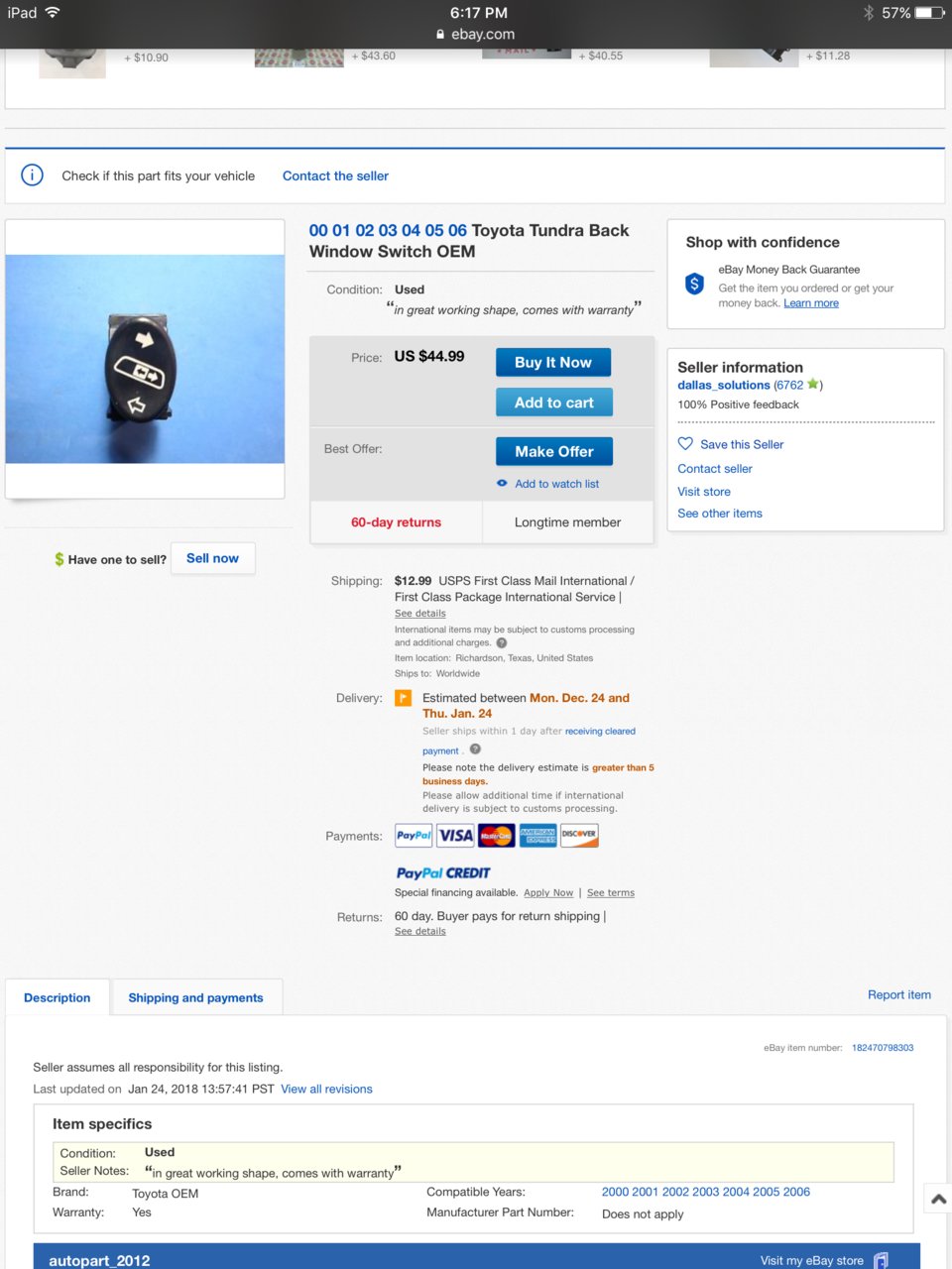

    I wouls check and check for the swith... i saw many for 50 $ but was able to find one for 20

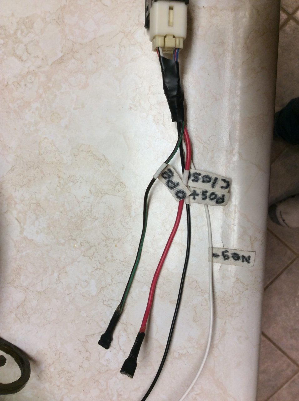

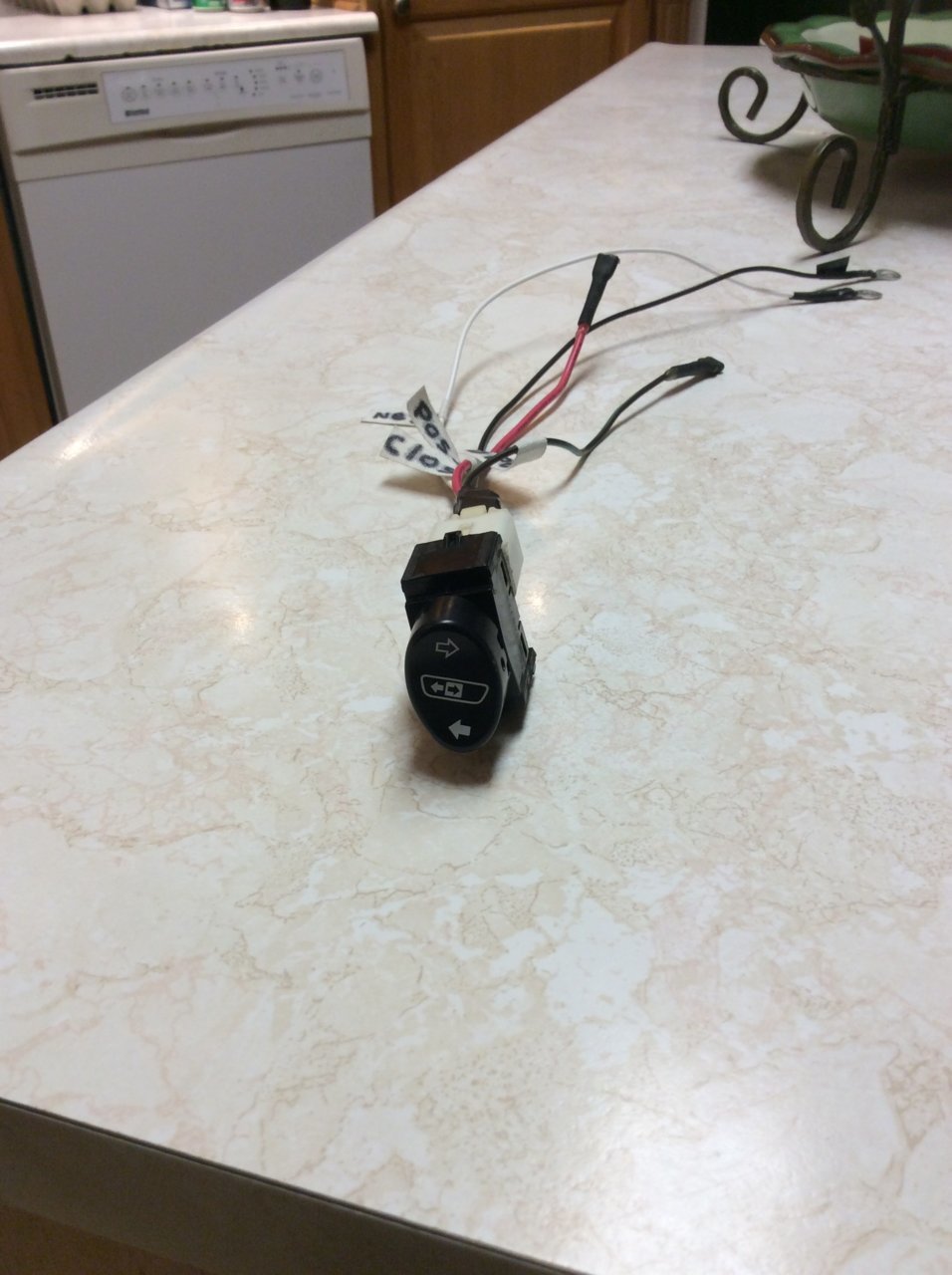

    Here is the switch i got and how i wired it. The green wire is to open window. Red is to close. Blue is positive. White is negative.

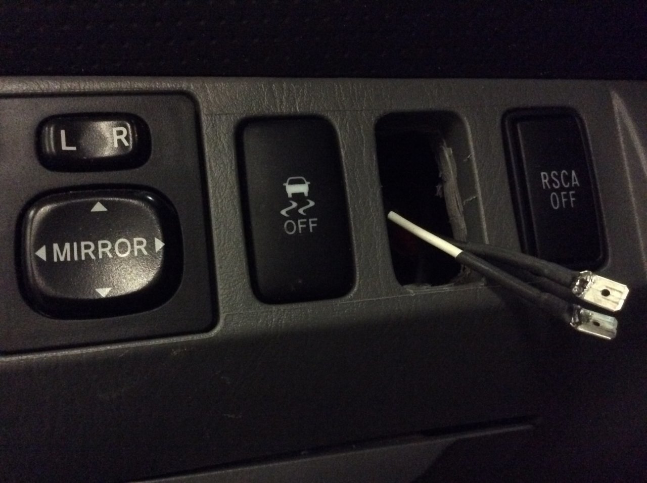

    @Toy4me @ACEkraut this is where i installed my switch. Only catch is that you need to trim the switch using a utility and or a drimmell. Plus i used the drimmell to make the slot bigger as you can see in this photo

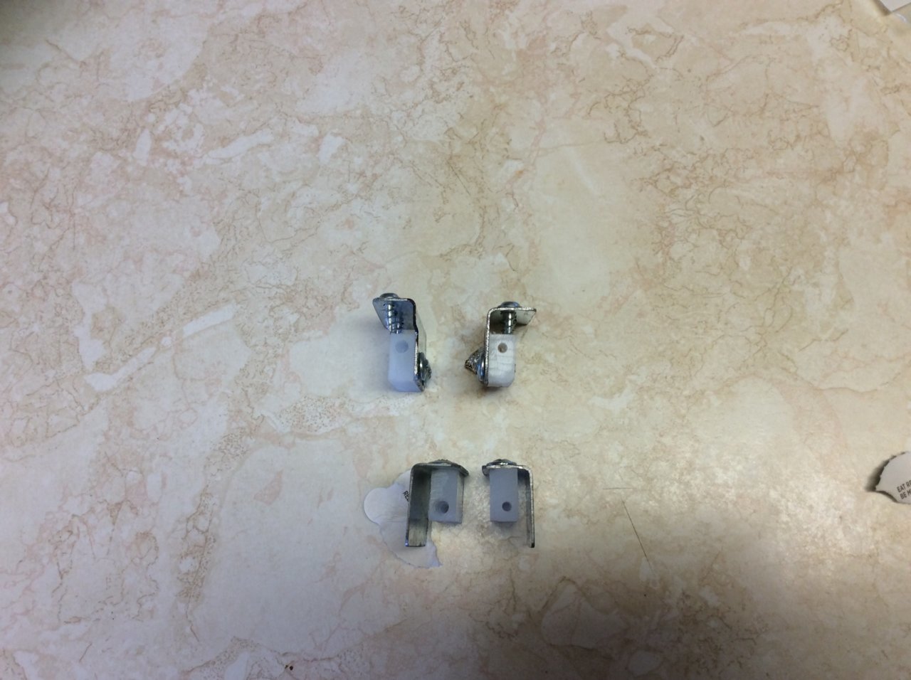

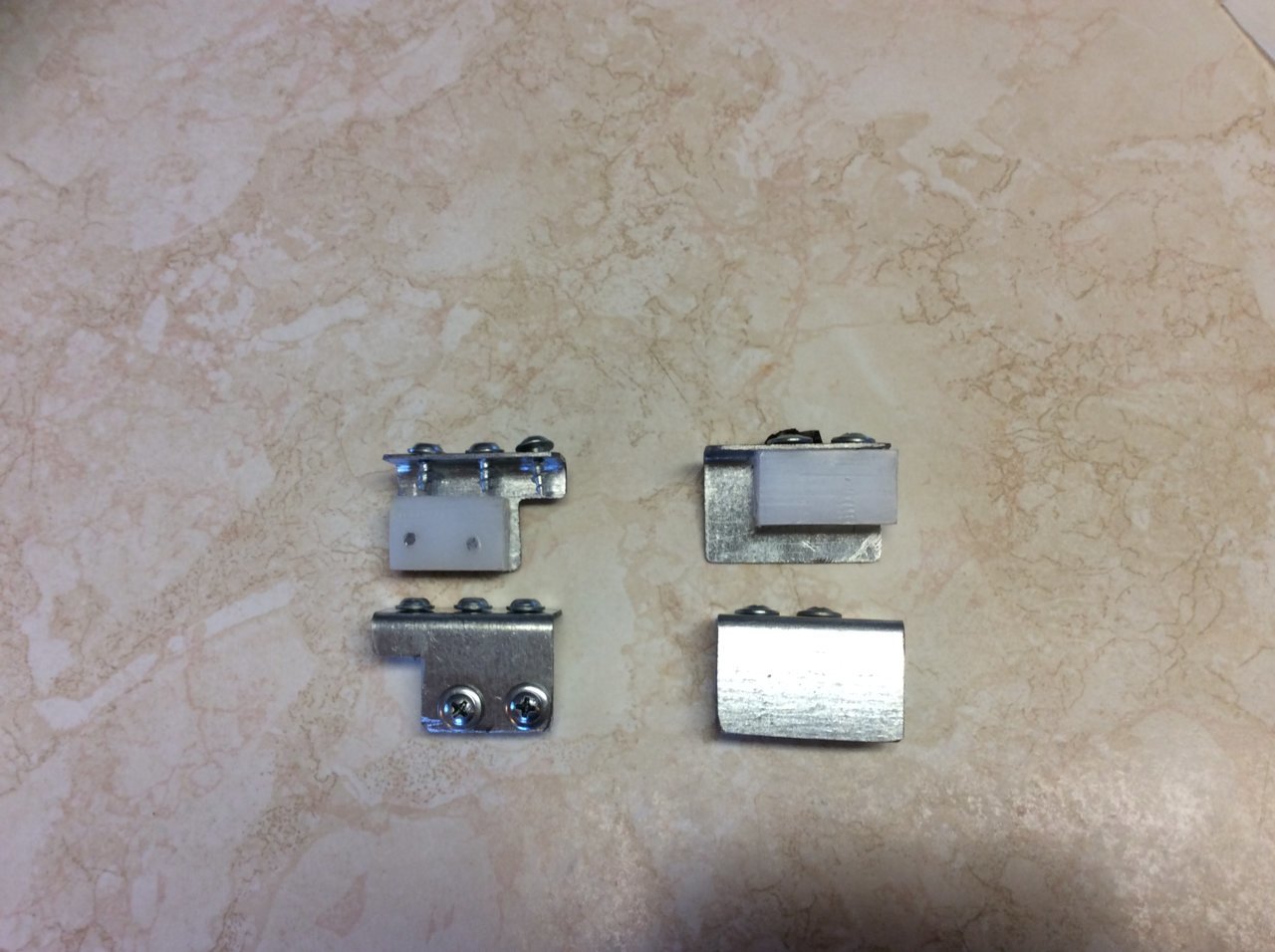

    I have 2 spare sets of anchor brackets that I made and would sell them for 35$ US each shipping included. Any takers

    Hey...quick question, how many anchor brackets are needed to complete the power sliding window?
    I thought you needed just 2, one on either side of the window, but you show 4 per set?
    Also, Which set would you use for the 08 Access Cab?
    Thanks for any help, and I WILL purchase whichever set you think are appropriate for the project.

    Sorry for the confusion.....A set is only 2 brackets. In the image there are 2 sets just to show different views for both sides of each brackets.
    The 2 upper brackets in the first picture are both for the passenger side. Only need one. I just wanted to show the that the hole where the cable passes through was different in size and location of teflon block. Same thing for the 2 bottom bracket in the first image. There are 4 brackets also in tne second picture just to show both side of each brackets.
