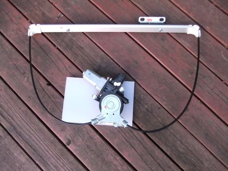

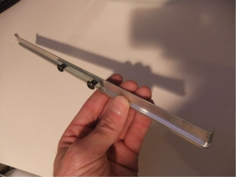

    Okay, so I took Lurkin's suggestion and did some thinking, and a little research on parts availability, etc.
    Wondering how many people would be interested in buying a fast-build kit that includes the re-sized window regulator/motor assembly (such that it will fit the Tacoma), plastic motor mounting plate, and also the window mounting bracket that I fabbed. I'm thinking price for the kit would be around $150-175, not including the switch, wiring, add-a-circuit/fuse.
    Basically you would be getting this:
    And this:
    So as an official feeler, who would be interested in spending that much on a fast-build kit? The more interest I can get the cheaper the kit would be, because I could fabricate them in runs, assembly line style. All those who are interested say I.

    mSo my question is, i have the stock storage compartments behind the seat and want to keep them, does this fit behind the storage compartment? The motor that is.
  11. Jul 14, 2011 at 9:00 PM
    #51
    BenWA
    BenWA [OP] Well-Known Member
    Feb 23, 2009
    #13977
    1,647
    Boston burbs
    '06 Double Cab TRD Off Road 4X4
    Unfortunately, the motor won't fit behind the storage compartment as far as I know. The indented part of the plastic storage tray mounts flush with the corrugated metal of the cab's back wall, and that's right where the window motor mounts to. The bin would have to be cut out so that the plastic would fit over the motor. That's the one main drawback of this mod, as far as I'm concerned. :(
