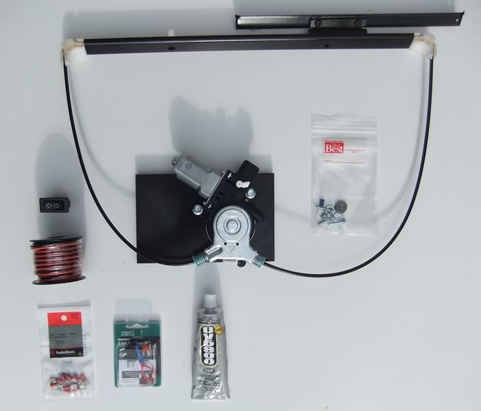

    Quick-install power sliding window kits are now available -- accepting orders, deposit required. Expect 2-3 weeks for delivery.
    Includes everything needed to complete the installation, including window bracket, motor mount, shim, adhesive, switch, add-a-circuit, wiring, hardware, and installation instructions.
    As of now, I'm not sure if the kit will work on an access cab.
    Installation instructions in the attached pdf:

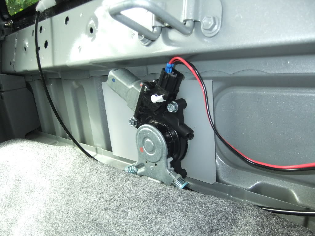

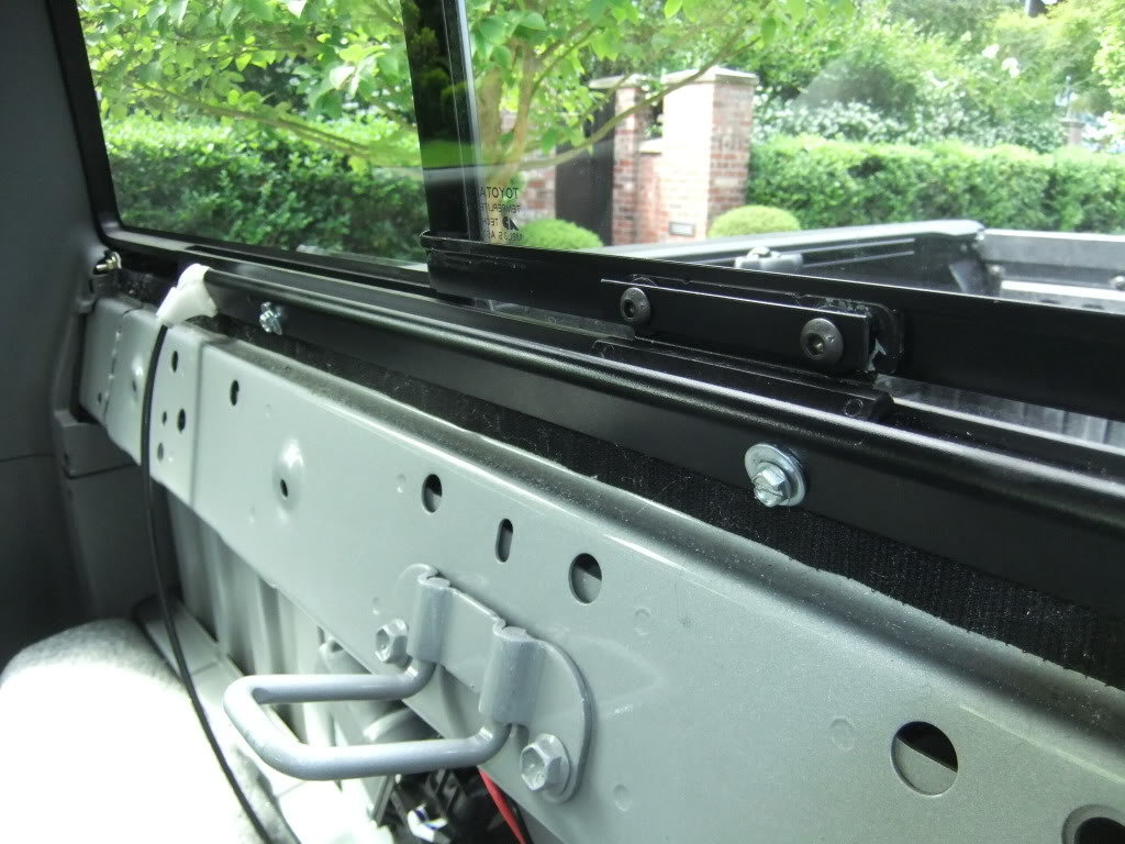

    Hey primer or somebody else who has an AC: is it difficult to remove the rear seatbacks in your AC's? If not, is there any chance you could remove the passenger side seatback and take a pic of the backside of it so I can see what it looks like back there? I'm really trying to figure out if I can make this mod work for an AC. Any help would be hugely appreciated, by me and by anyone else who has an AC who wants this mod!!
  14. Aug 15, 2011 at 5:56 PM
    #74
    BenWA
    BenWA [OP] Well-Known Member
    Feb 23, 2009
    #13977
    1,647
    Boston burbs
    '06 Double Cab TRD Off Road 4X4
    Here's a couple close up pics of the installed unit...can you tell whether or not it would work with the AC rear seatback based on the pics? I'm sure the top of the seatback would need to be trimmed where the regulator track mounts to the window frame, but what about the motor?

    I really think that it will have to be trimmed where it mounts to the window frame. Hopefully that's not a huge deal.
    Never had my seatback all the way off. I'll bet it's not too hard (someone let me know if I'm crazy). I probably won't have time before this weekend - but I can try to do it and take a pic then. I was out messin with my truck yesterday. Shoulda done it then.
    If it can be done with limited trimming I'm in for one.

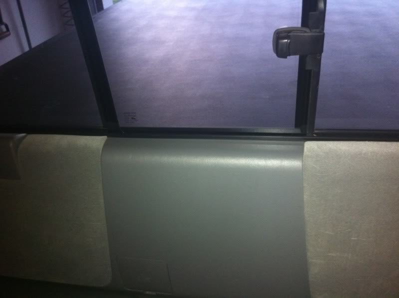

    I'll go take a look at my truck right now and post back.

    This could be a reach, but what about adding some kind of spacers (perhaps about 1/2") between the seatbacks and the wall of the cab to set the whole seatback forward 1/2"? That might eliminate the need to trim plastic. Would spacing the seatbacks forward 1/2" be too goofy? It may not even have to be 1/2", maybe less would do the trick. Just trying to think outside the box.

    I think I understand what you're saying. I think it will depend on how the plastic attaches to the back of the cab. I think it snaps into multiple spots back there if I remember right. I'm guessing it would be easier just to trim, but I'll try to take pics so you can see.

    I think the trimming would be limited to just the hard plastic at the top. If the motor won't fit I'll bet the trimming there wouldn't affect that material either - but that's probably a bold statement for someone who hasn't removed anything completely yet...
    I should have time this weekend to do some demo/recon work.
