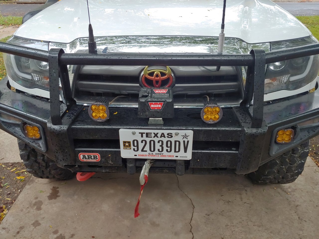

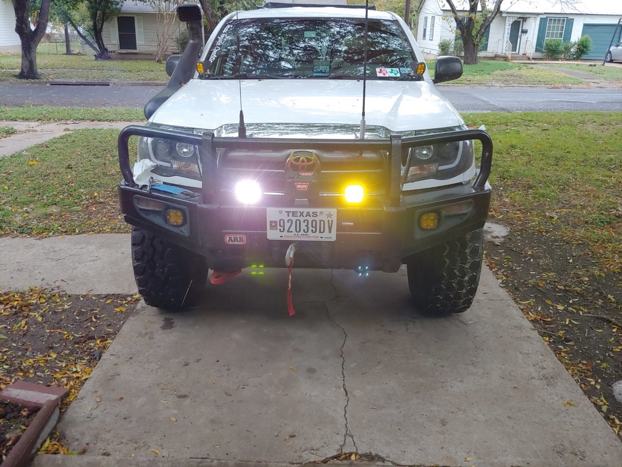

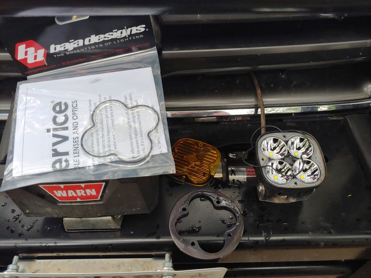

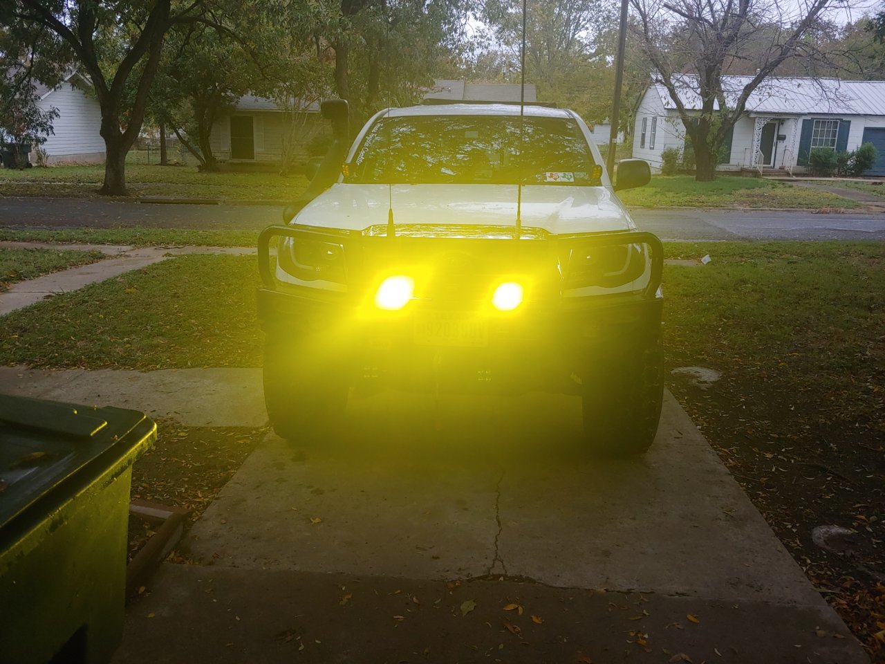

    Today I swapped lenses on my bumper lights to clear spot lenses. The original lenses were Amber Wide/Cornering.
    The swap was very straight forward and easy. The key is to orient the housings facing upwards to keep the o-ring from moving out of its groove. The only tools i needed were a 2.5mm Allen key for the lense covers and an Allen key for the bracket-housing bolts. The instructions were short and very easy to follow.
    After installation, I checked the operation and daylight performance versus the ambers.
    Pictures don't do it justice, but the new lenses are much brighter and more focused than the Wide/Cornering lenses. (Compare to the above amber lights)

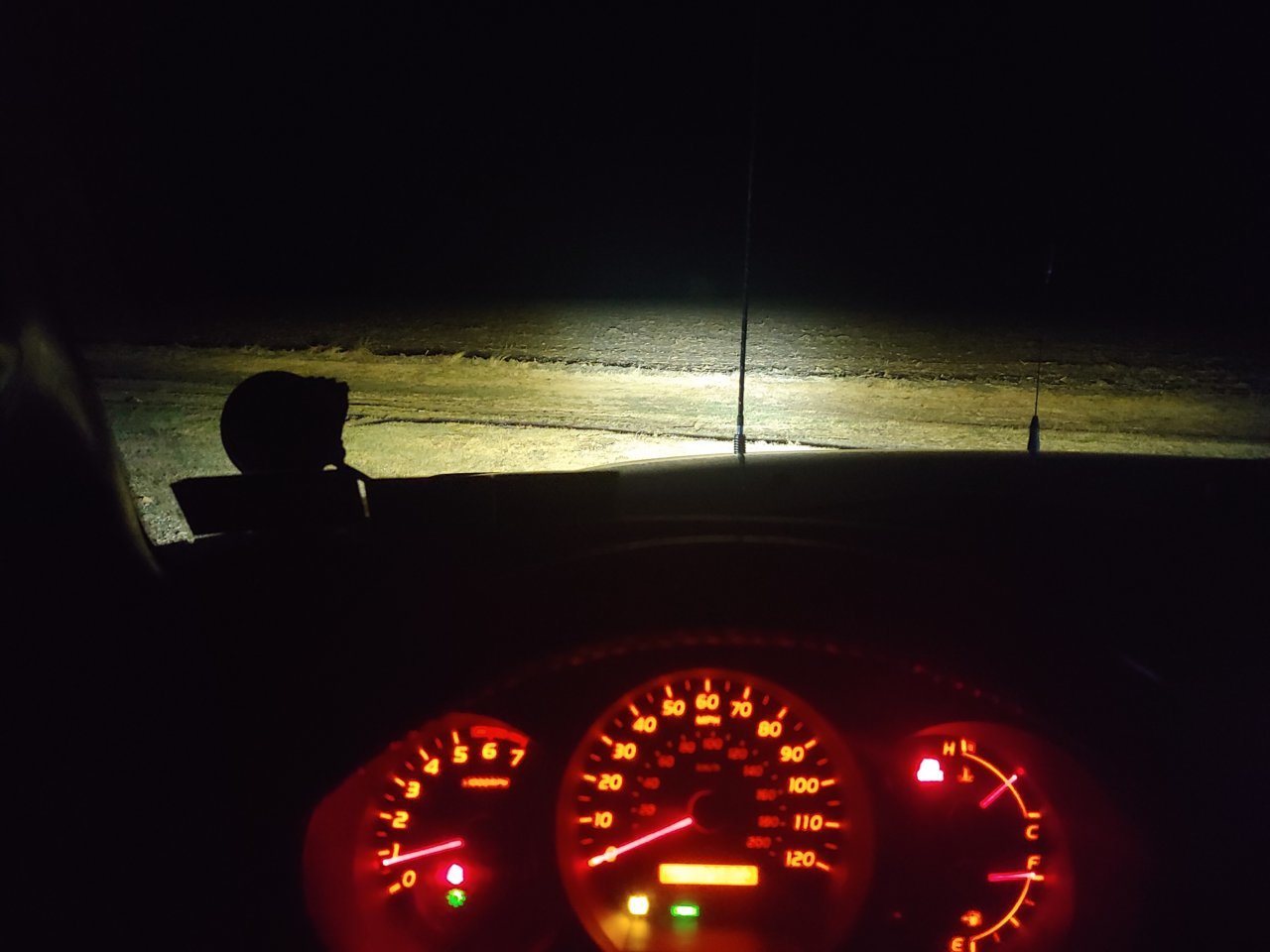

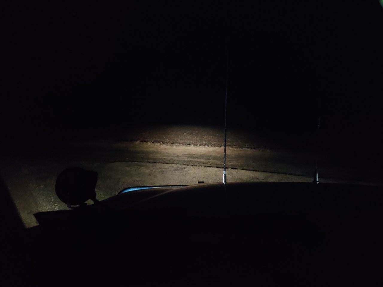

    Low beams and fogs
    High beams
    Low beams, fogs and bumper lights (might not see it in the picture, but there's a bush I couldn't see with my high beams)
    Ditch lights, bumper lights, low beams and fogs

    Yeah I’m digging the amber. Are your ditch lights amber too?

    Yep, my ditch lights are the Baja Designs Squadron Sport-R amber wide/cornering.
