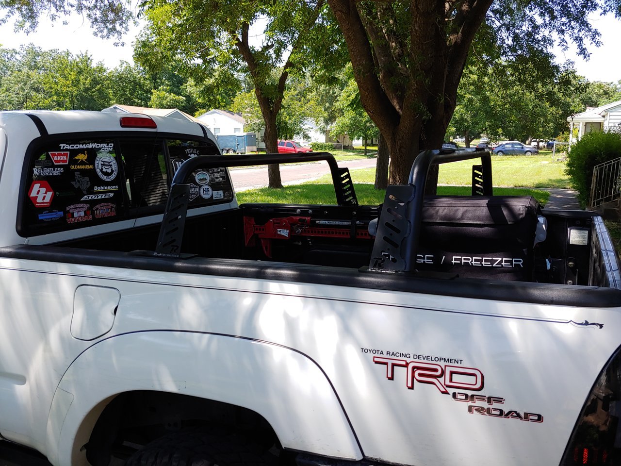

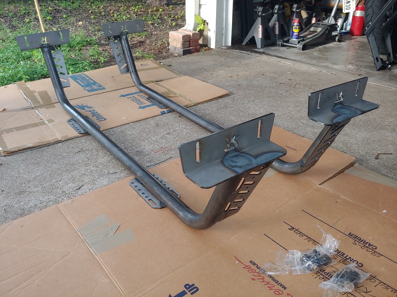

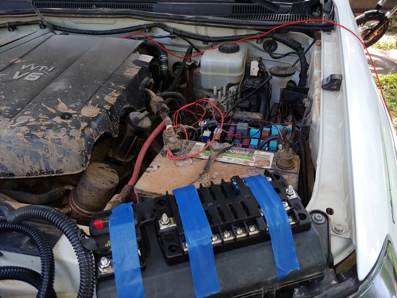

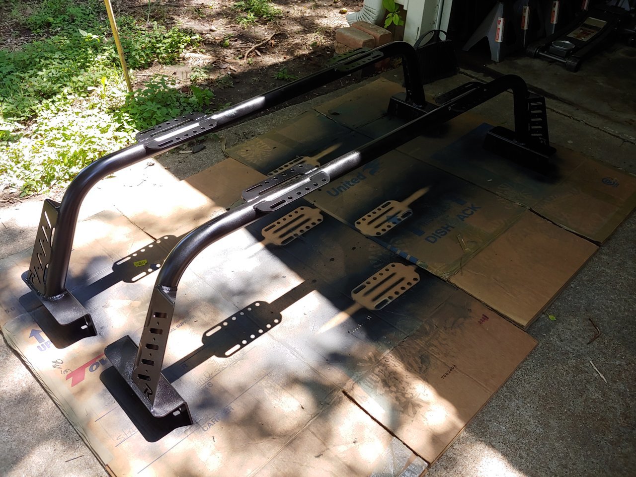

    Whew, it was a warm one today. It hit 92 at around 60% humidity today. I decided to go hard and get all my planned projects as caught up as possible. First was cleaning up the rats best under my hood...
    Then I painted and installed my Rago Modular Mid-height Rack Bars

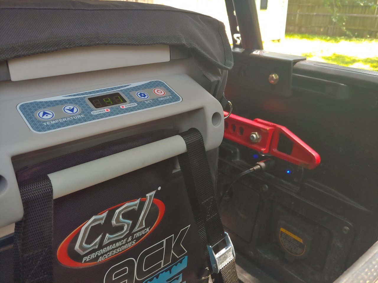

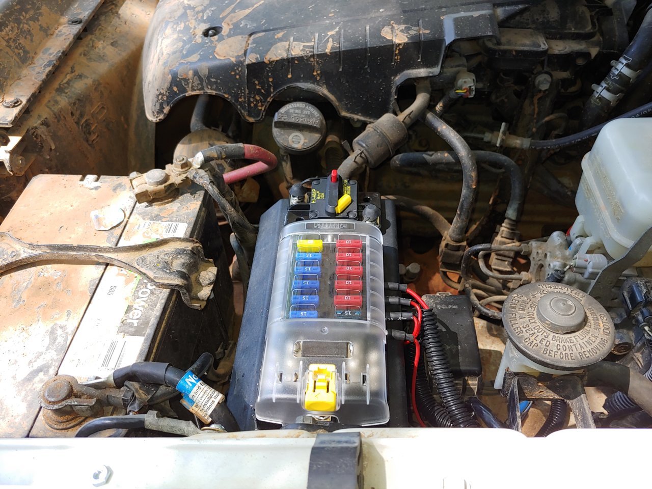

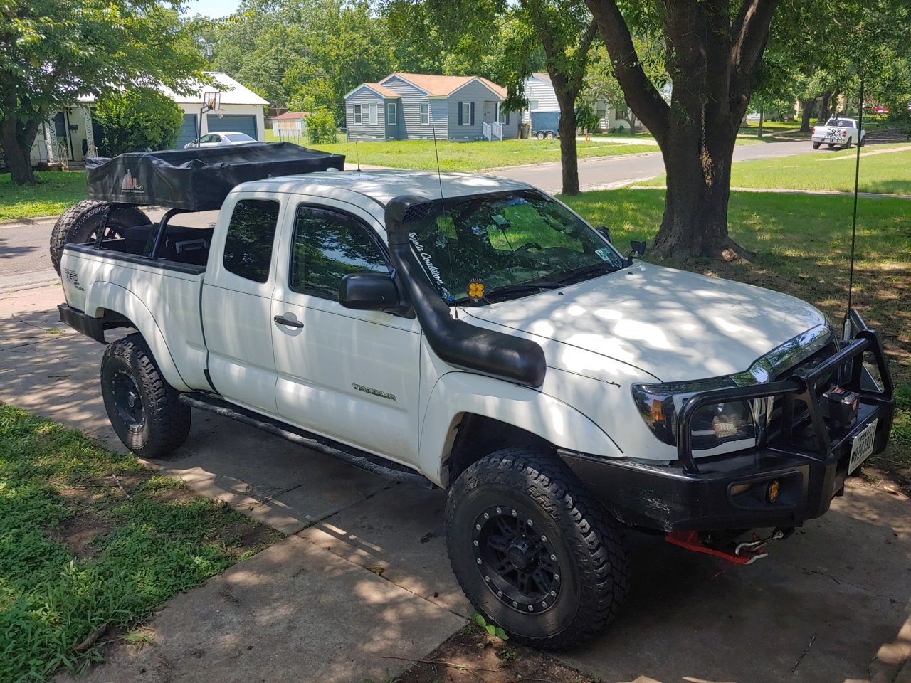

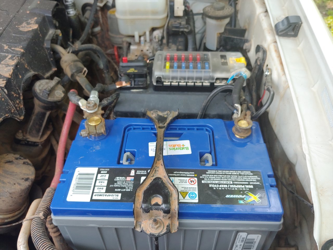

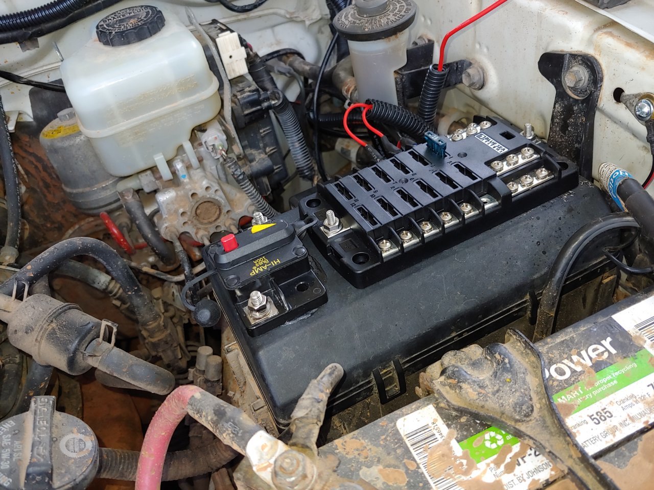

    Got my wiring finished, fridge is dialed-in (hopefully), tent mounted and battery upgraded.
    Wait.... Battery upgraded? That's right, the crappy lead acid battery would fault the fridge constantly and couldn't keep up with the amperage load. The battery would drop way low on draw and only maintained 12.5V when off with no draw. So it had to go. I exchanged it for a North Star 24F AGM battery. Now, I don't have an issue with voltage/amperage supply.
    Time for pics...
