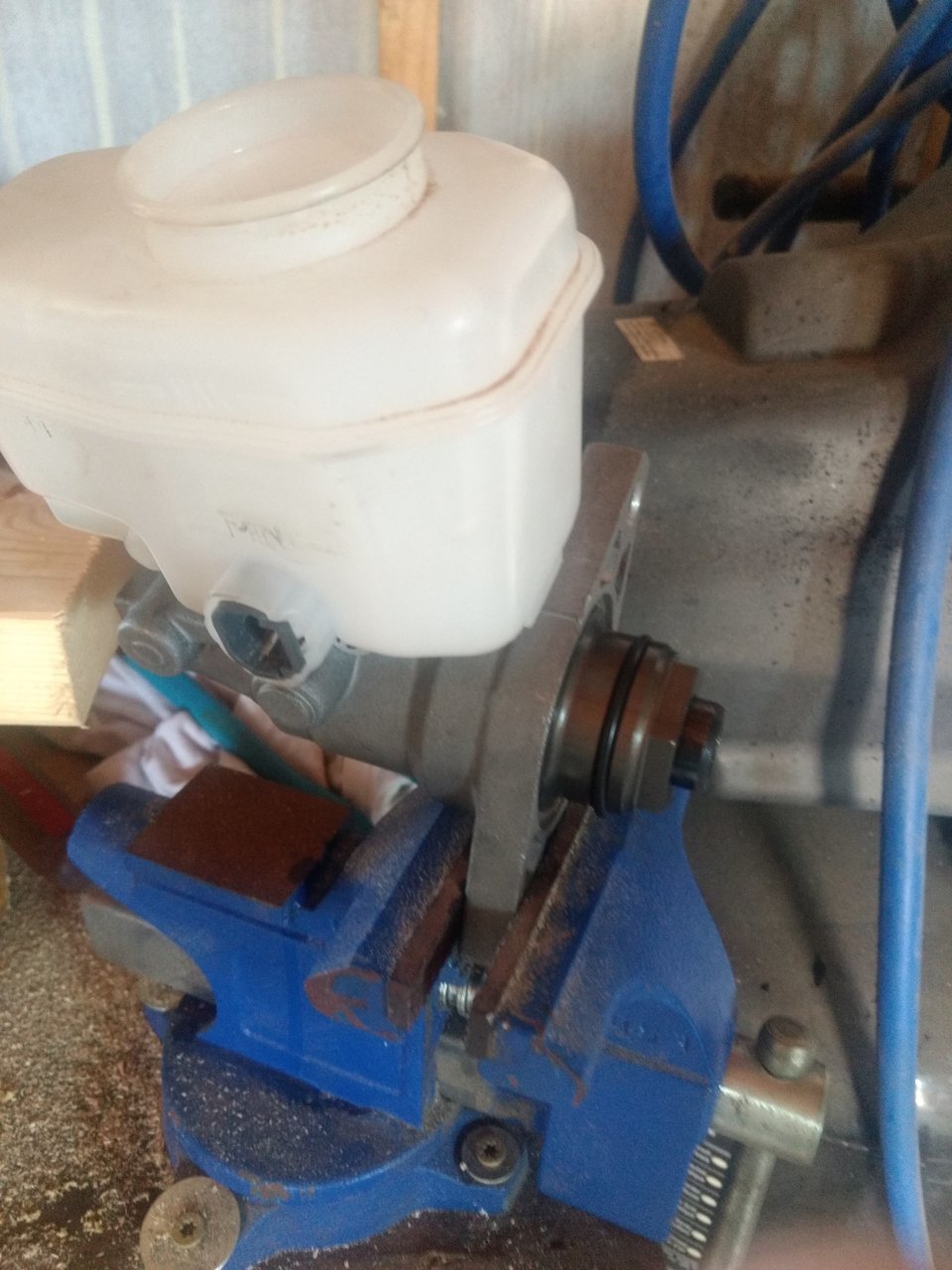

    Took my brake master cylinder off and the plunger stuck in the cylinder supposed to be like that
    BassAckwards and Bigdaddy4760 like this.

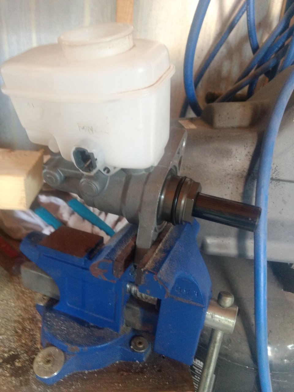

    IMG_20190717_141006069.jpg I would think supposed to be like this but it stays like this 15633907551115135735540162364793.jpg
    Bigdaddy4760 and b_r_o like this.

    That plunger suspose to come back out I would think
    Bigdaddy4760 likes this.

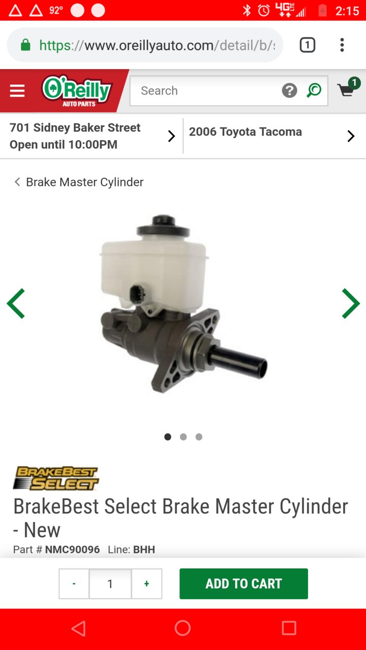

    See even in this pic of a new one the plunger is out Screenshot_20190717-141536.jpg

    The plunger doesnt spring back when you push it in
