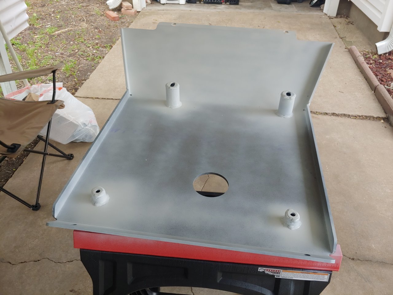

    And it's here. Started with Rustoleum Self etching primer, then Rustoleum Rust inhibiting primer then Krylon Bed Liner

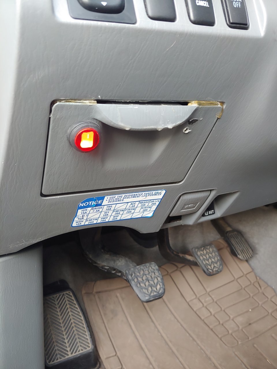

    Wired up the ditch lights and used my already FUBAR'd interior fuse panel/coin pocket to mount a 2-position switch. I had to cut out the rear of the pocket to fit the harness. I used the included harness from the Paranoid Fabrications fog light kit to wire it up and used a metric Step-up drill to drill a hole of about 16.5mm/17mm to fit the switch. It is very Low-profile and doesn't come close to my legs. I also moved the fuse panel diagram to just below the storage pocket

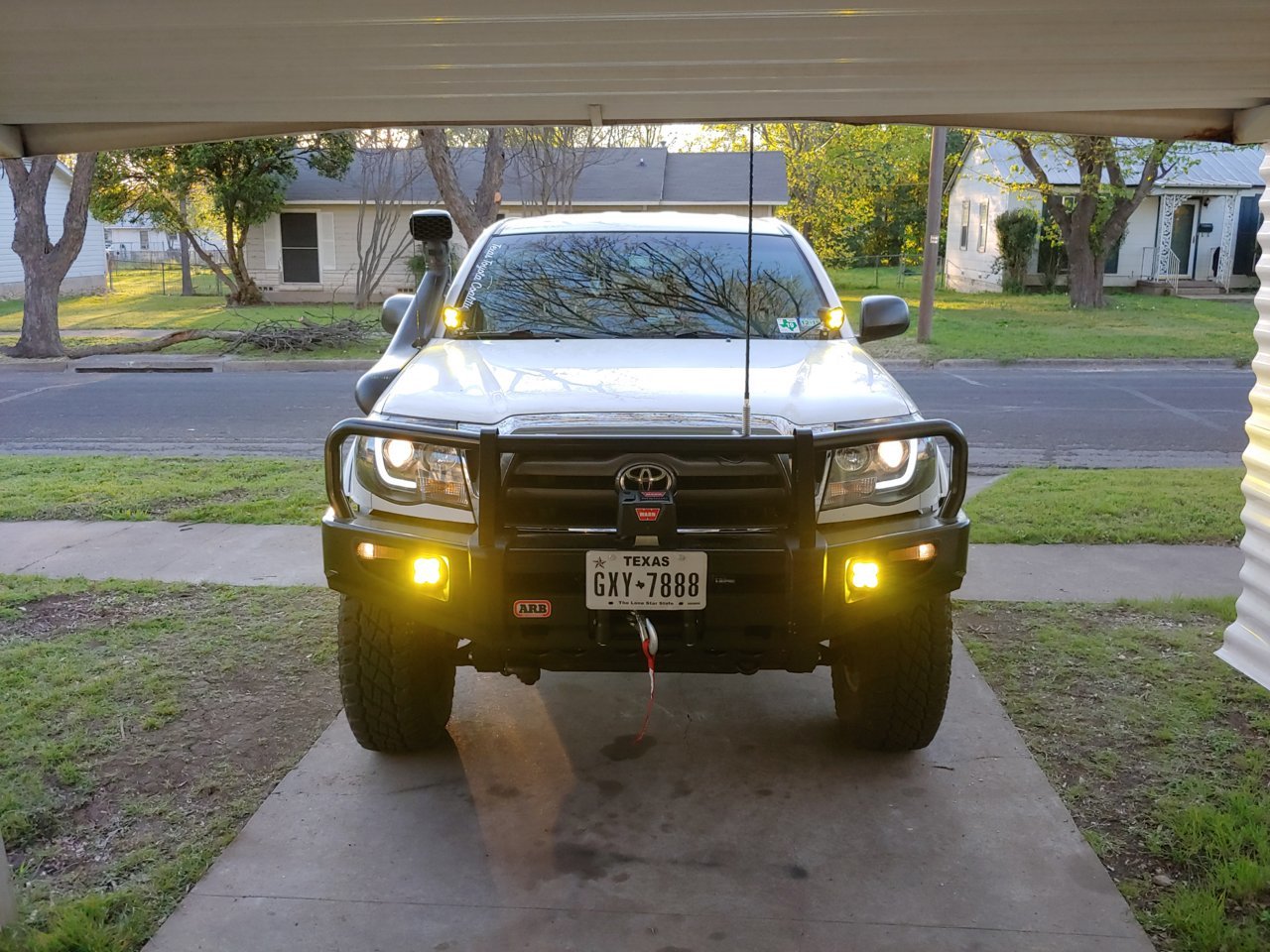

    That front end be looking dayum good. The fog lights with headlights is beautiful looking.

    Hell, yeah. It's sexy and man! There's so much light now lol

    Thanks! I love these lights. Plenty bright, good throw and wide spread. (Wide cornering lenses)
    I think I'll be using the exact same lights when I get a roof rack to use for side lighting as it's not blinding at night like white lights are.

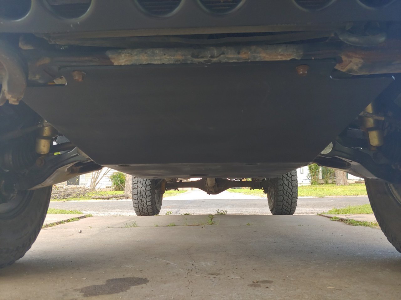

    I'm waiting for the FedEx guy to deliver my transmission skid today and I have all the parts together for my ECGS solid bearing upgrade, too.
