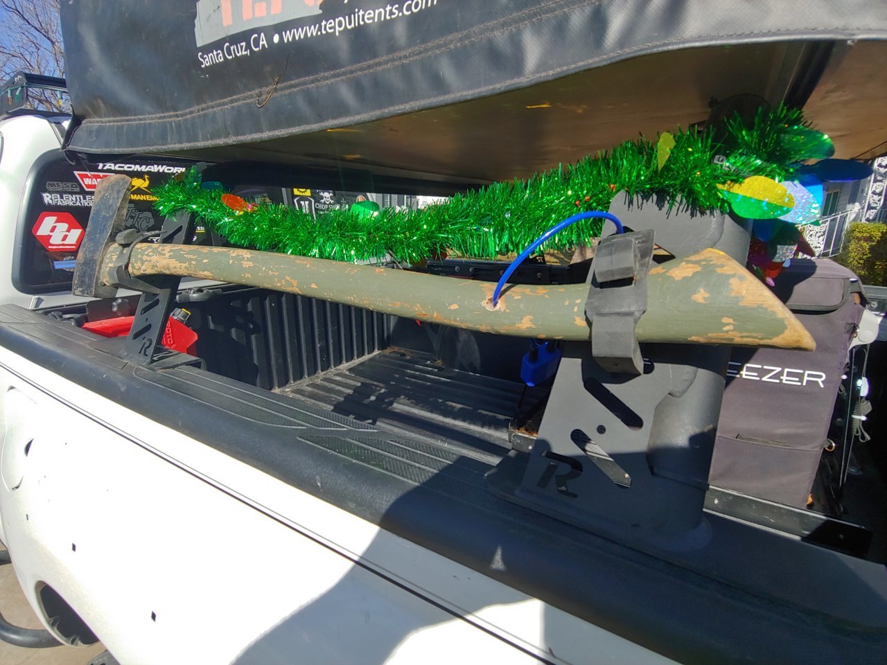

    Today, I did a little work. First, i mounted the other pair of quick fists to my Rago bed bars. This is to hold my axe (which needs to be sharpened, btw). I also drilled through the handle (I was a little leary about drilling into my axe handle) to use a gun lock in order to secure it to my bars.

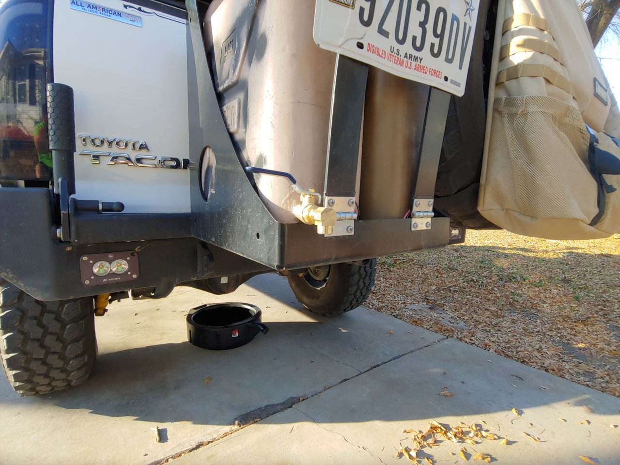

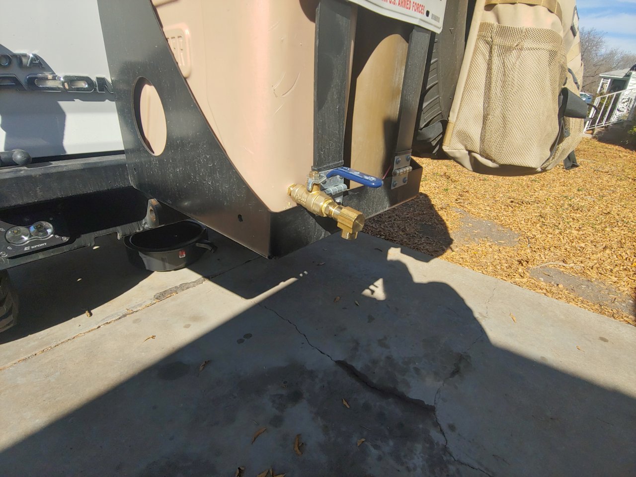

    After that, I began work on my gravity-fed, spigot/faucet setup on my military surplus 5 gallon Scepter Water Can.
    The first can I tried it on was very thin in the walls of the actual can. It would flex and nearly pull-out just from using the lever.
    The second can was much better made. The wall thickness was equal to the base thickness, making it very rigid.
    To do this mod, I set it in the swingout can holder, drilled it with a 7/16 drill bit and tapped it with a 1/4"-18 NPT tap. The reason for the 1/4" was because if I messed it up, there are still two sizes (1/2" and 3/4") available, locally, I can go up to at Lowe's for drinking water-rated valves.
    I used a 1/4"-1/4" threaded, brass adapter on both sides of the valve and a 1/4"-1/4" 90° brass elbow to assemble the faucet/spigot. On the first attempt, I used this pipe thread sealant...
    And it sucked. I went to clear silicone RTV on the second attempt. The problem still remained of movement and thread tightness in the can do the brass pipe threads. Using a 15mm, I tightened it (with help from my wife) as far as it could go. There was still to much movement, so I coated (heavily) the outer joint of the brass fittings, where it meets the wall of the water can.
    I am now waiting for it to cure, then I can test it's water retention and functionality.
