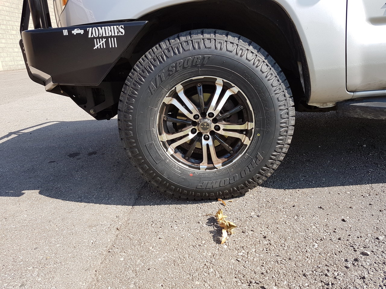

    I've done the 16x7's with 225/75R16. The aftermarket rims (intended for early 2000's Jeep Liberty/Wrangler) have an offset of +40.
    They are tucked in, similar to the +45 of the OEM 15x6's.

    I am replacing my tires shortly to 235/85R16. I have a set of 1.5" hub-centric spacers on the side to deal with any wheel-well issues that may crop up. This will bring the effective offset to the equivalent of +2mm - by my eyeball guestimate, flush to the fender side.

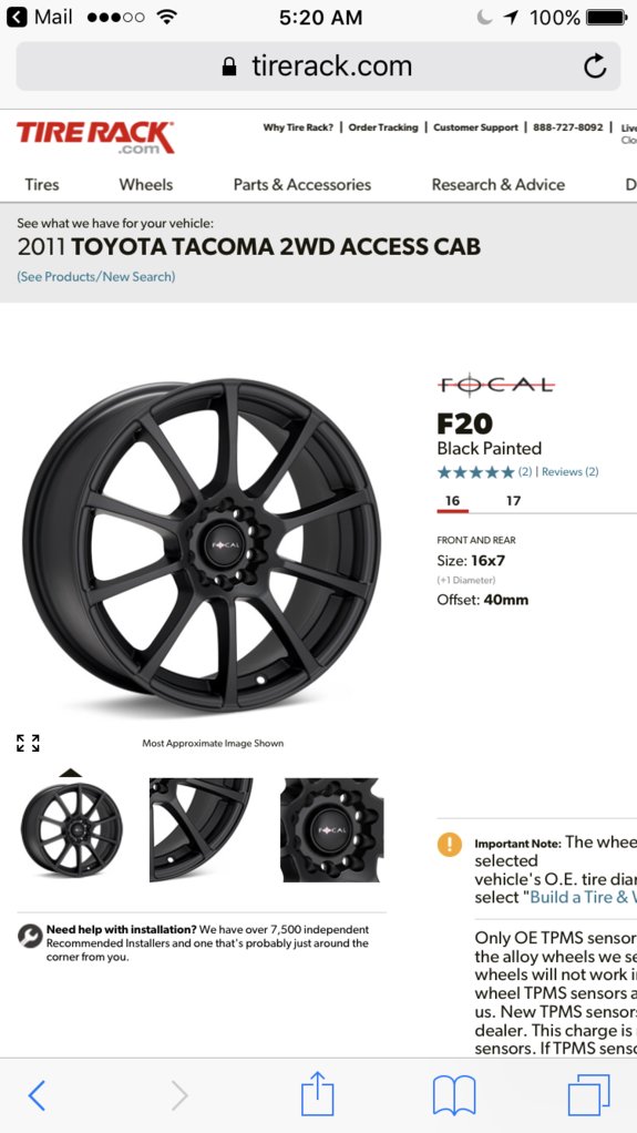

    Nice. I wound up with a set of Focal F20's (16 x 7) with 235/60-16's. I had considered 235/65 for a tad bit of extra height, but it was not a TireRack option. My son and I finished installing them last night (ordered Sunday, delivered Tuesday pm!). Look great, ride great, nothing too radical. 40mm offset.

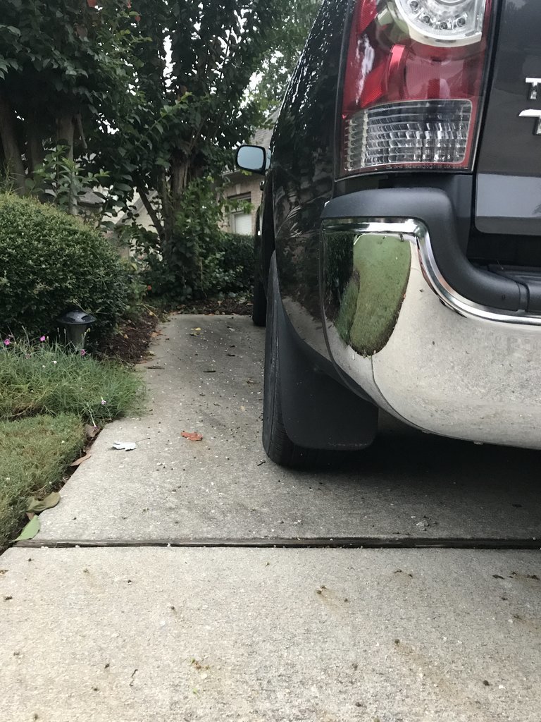

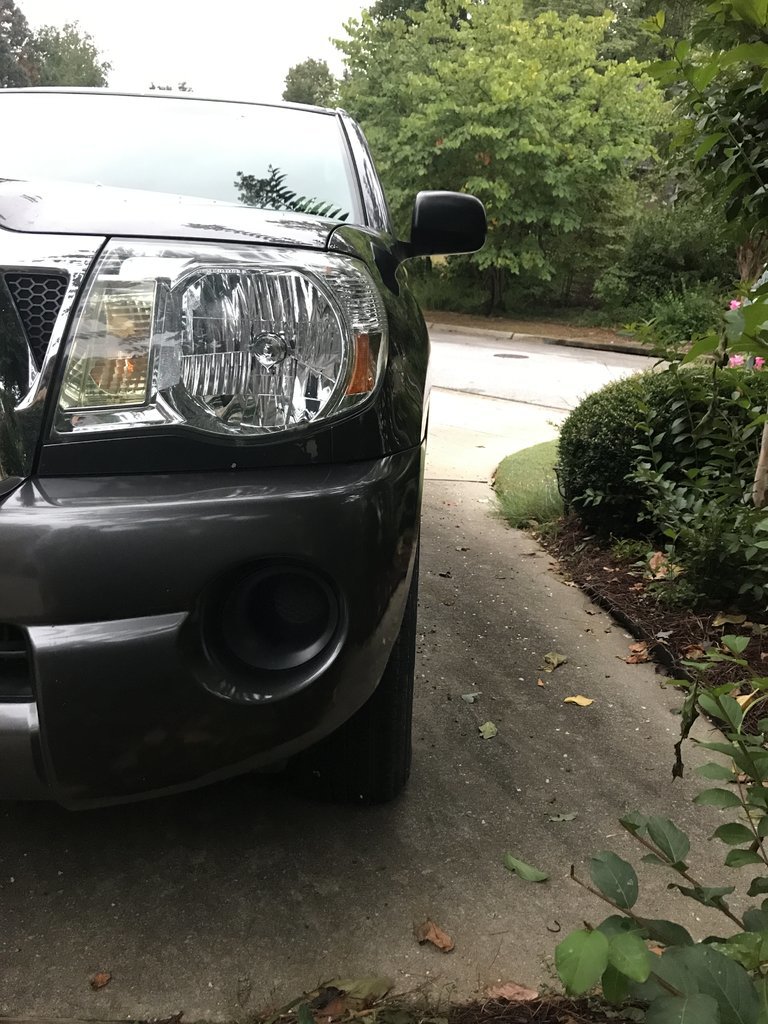

    By the way, this setup is flush to the fender at the rear, and almost there at the front. I measured 45 mm offset on my steelies. Even though the Focals are a cast design, we wound up saving 6.5 lbs per wheel! (51lb with stock steel and 215/70-15 vs. 44.5lb this setup).

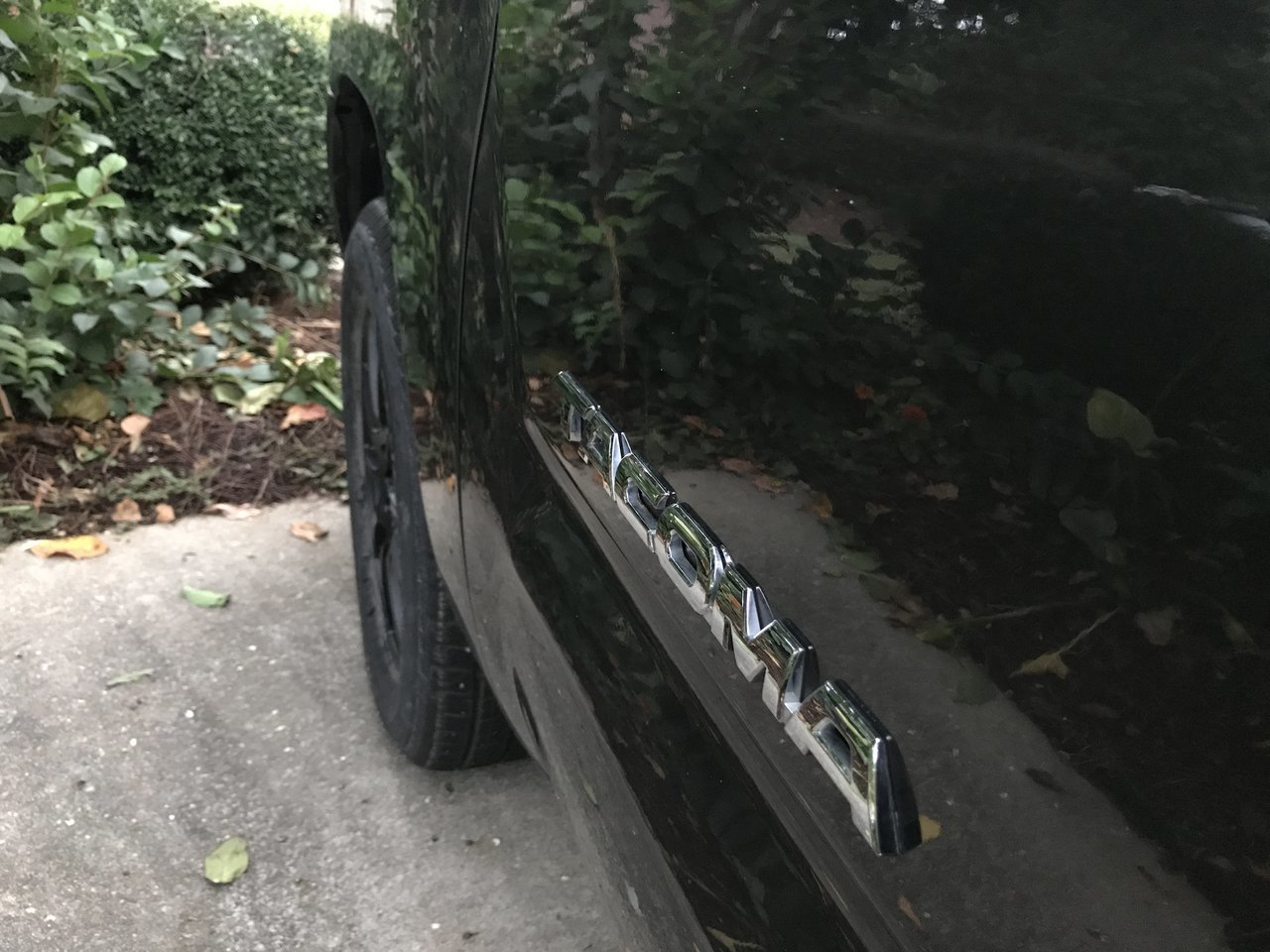

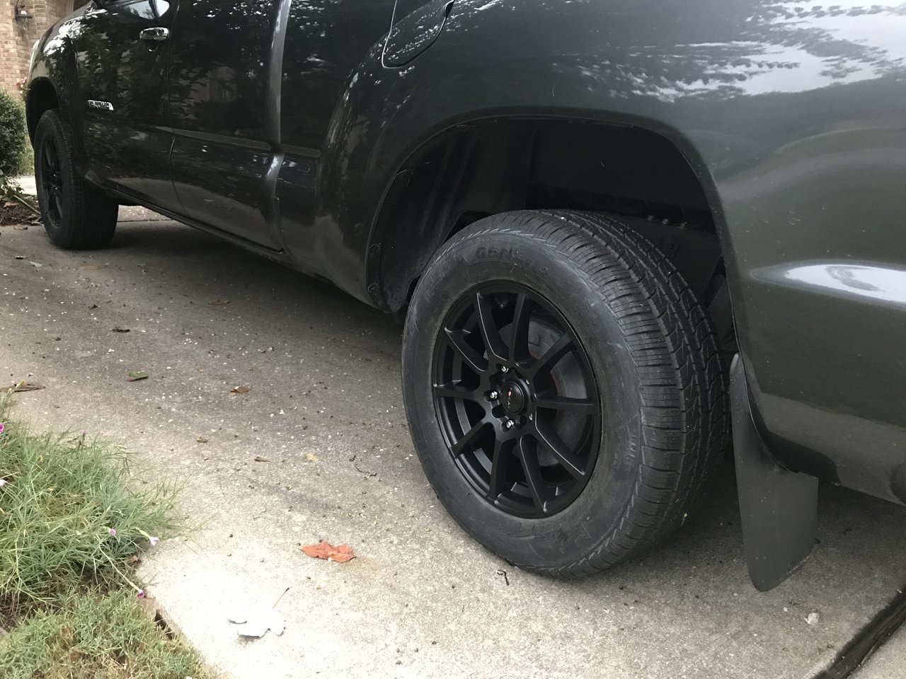

    IMG_6047.jpg IMG_6046.jpg IMG_6045.jpg IMG_6044.jpg A few installed photos

    About the same, relative to the fender lip, as mine. Good choice in an alternative rim.
