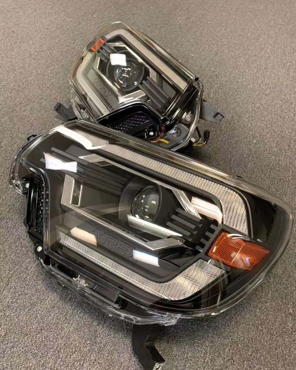

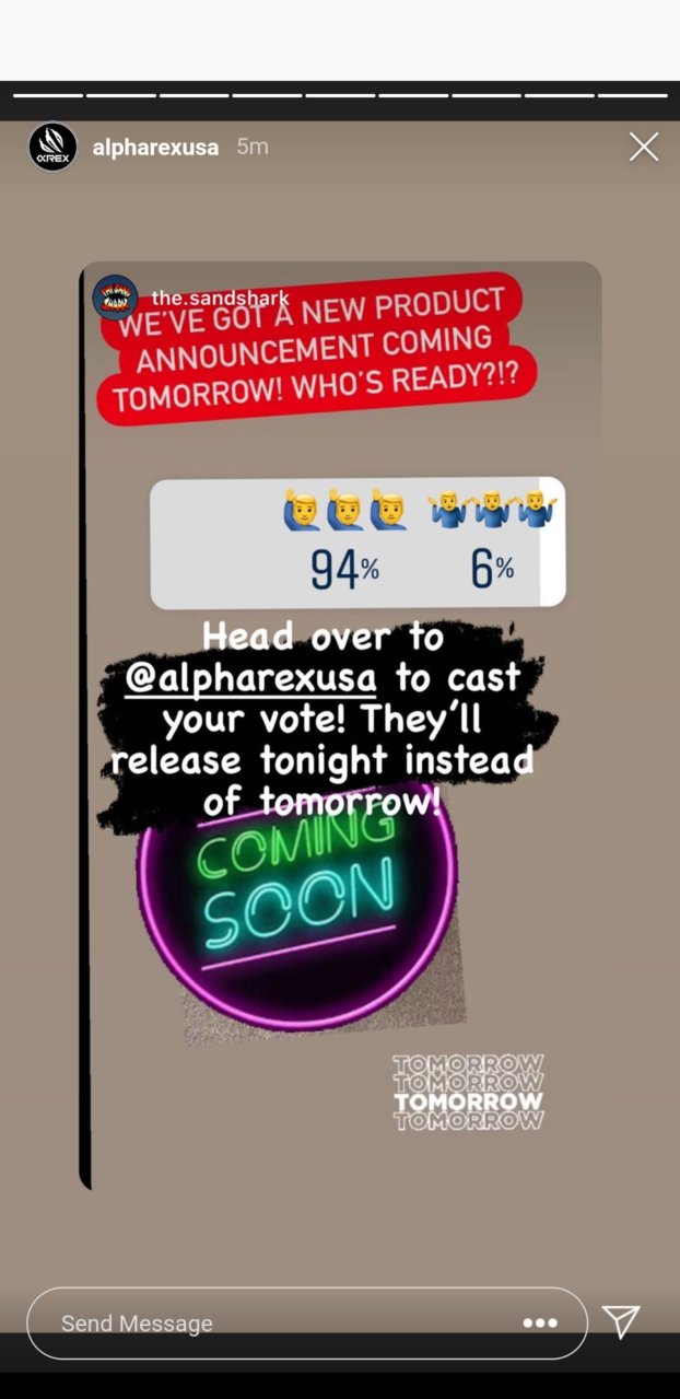

    New Alpharex Toyota lights releasing tonight, pray that its for 12-15

    Mmm true but I already have a pair. And nothing out there comes close to how these look. Also, if all aftermarket headlights perform poorly, (maybe not fact but generally assumed) why not at least get the best looking one?

    Here you go buddy, this is the best pic I can get at the moment. but 100% thats a 12-15!!

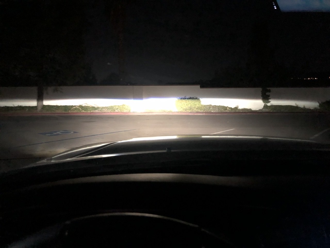

    Did my own Morimoto retrofit conversion. Lighting is like butter and my headlights project farther than the car’s headlights in front of me LOL.
    The sharp cutoff looks cool, but the downside is that everything above the line is dark and hard to see at night.

    Definitely a disadvantage to the hard cutoff with a high intensity light source. The sharp difference between extreme light and darkness at the cut off does make it challenging to see beyond the headlights illumination to where you can only see what the lights are illuminating below the cut off. In a halogen projector, there is uplight above the cut off which helps blend that extreme contrast better.

    The Alpharex Gen 2.5s lights look pretty good IMO. I’ve seen the light output and cut off on an earlier Gen 2 Alpharex model and the cut off was clean and light output was better than stock but nowhere near retros which isn’t fair comparison.

    Clean cut offs are the case for any projector. What is overlooked on the AlphaRex lights is the pattern is bad, it is all foreground light and no distance light. The headlight light output is literally designed wrong. Headlights should minimize foreground light and maximize the distance light. I haven't seen the output of the latest light, but their previous relabeled Vland products have been pretty poor.
    This was covered in more detail with examples here:
