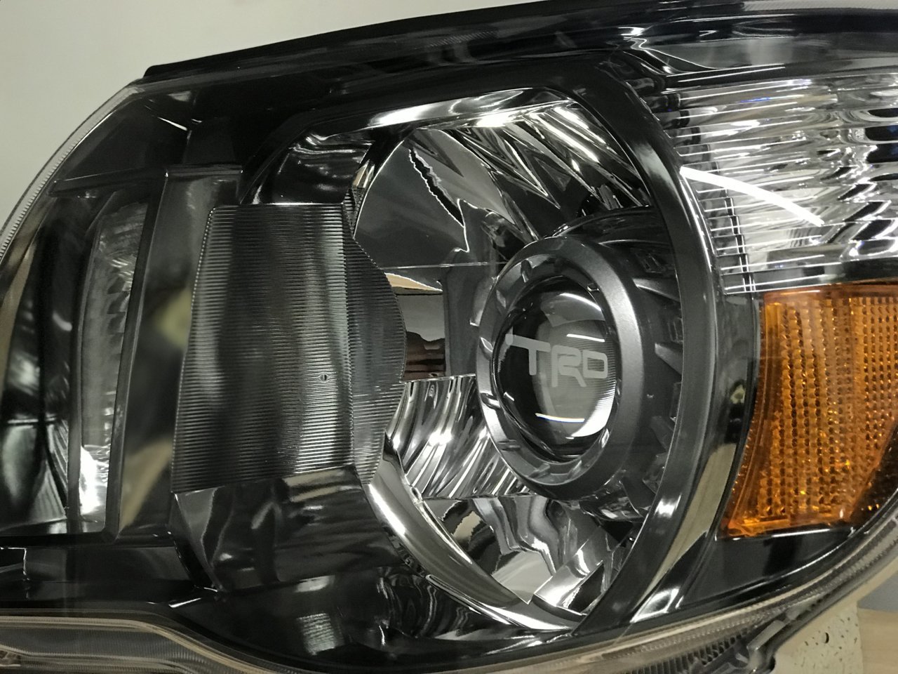

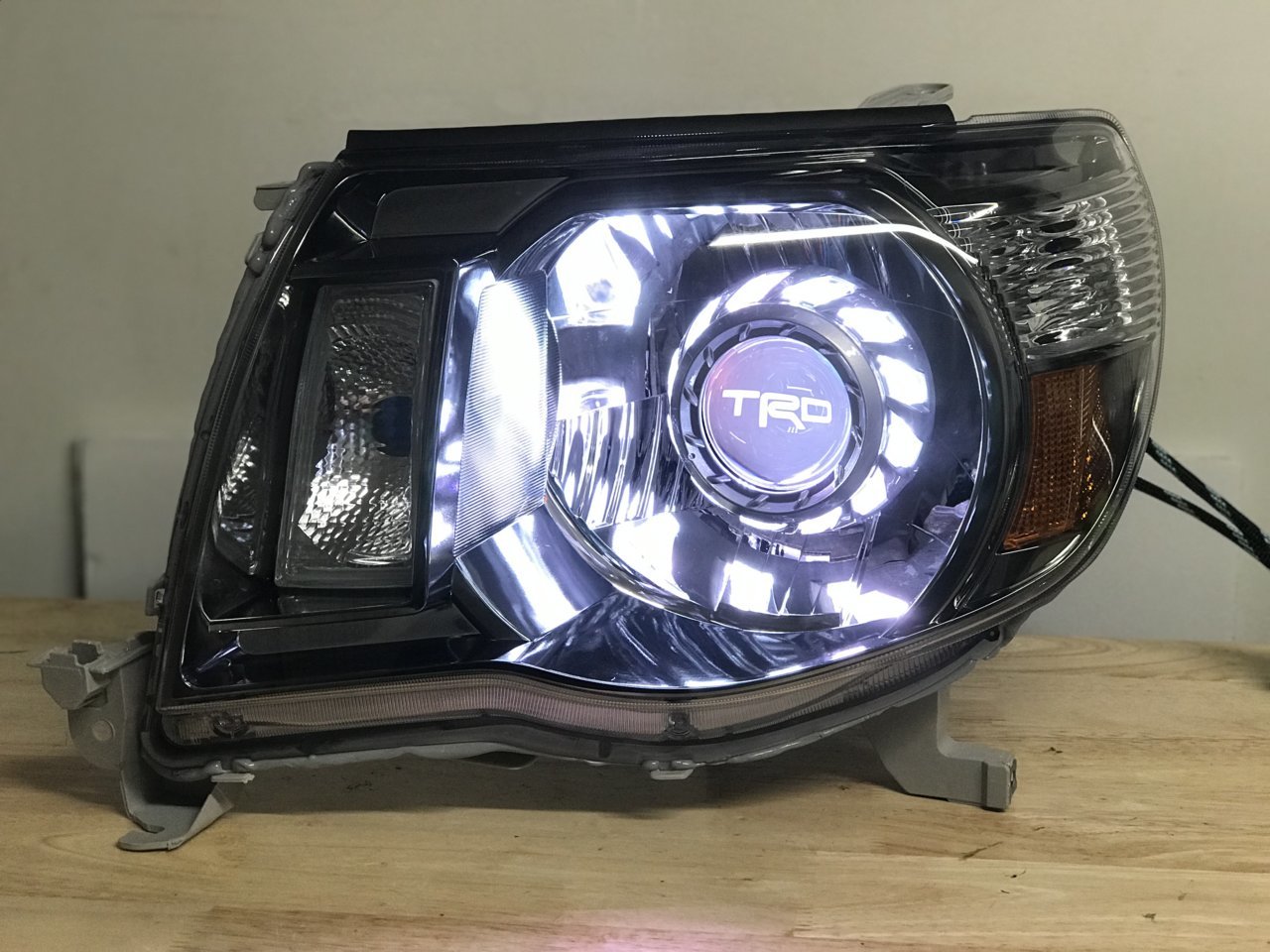

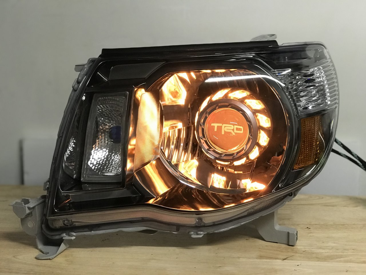

    Retrofits

    Those look great.
    Plan is to retrofit OEM Pair. Know where to get OEM at reasonable price?

    How do you control the colors?
    That's so tempting...

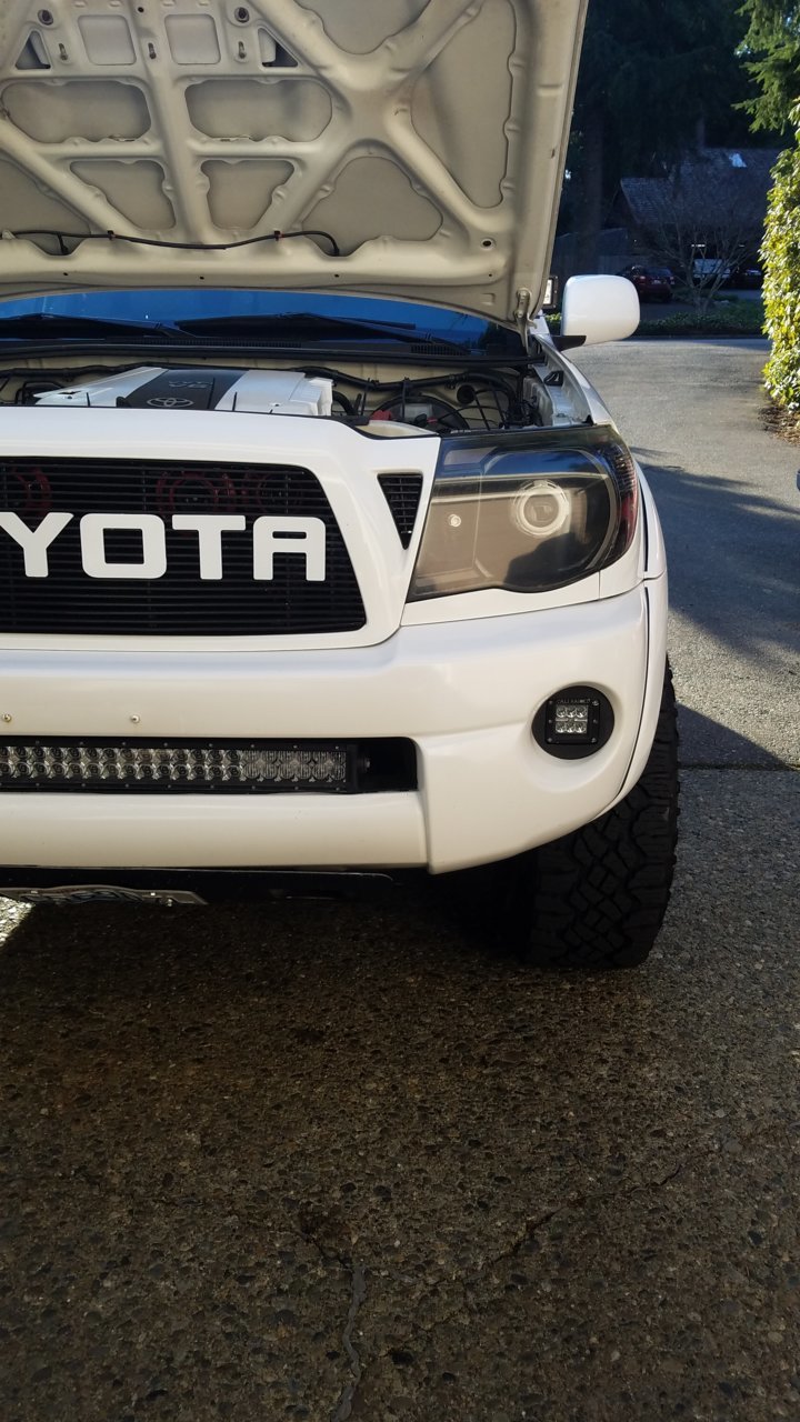

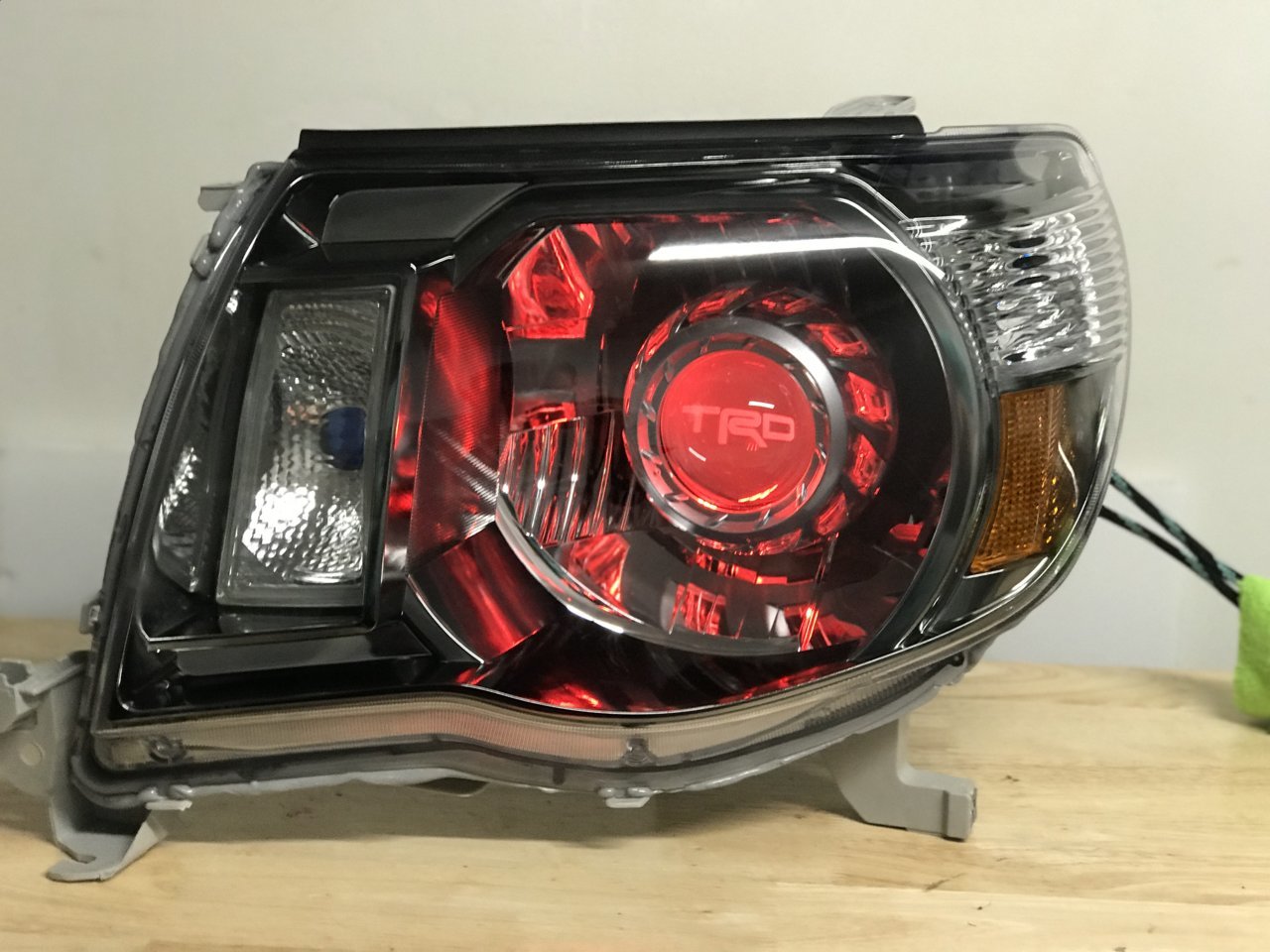

    Here's my set, mini h1s with rgb halos

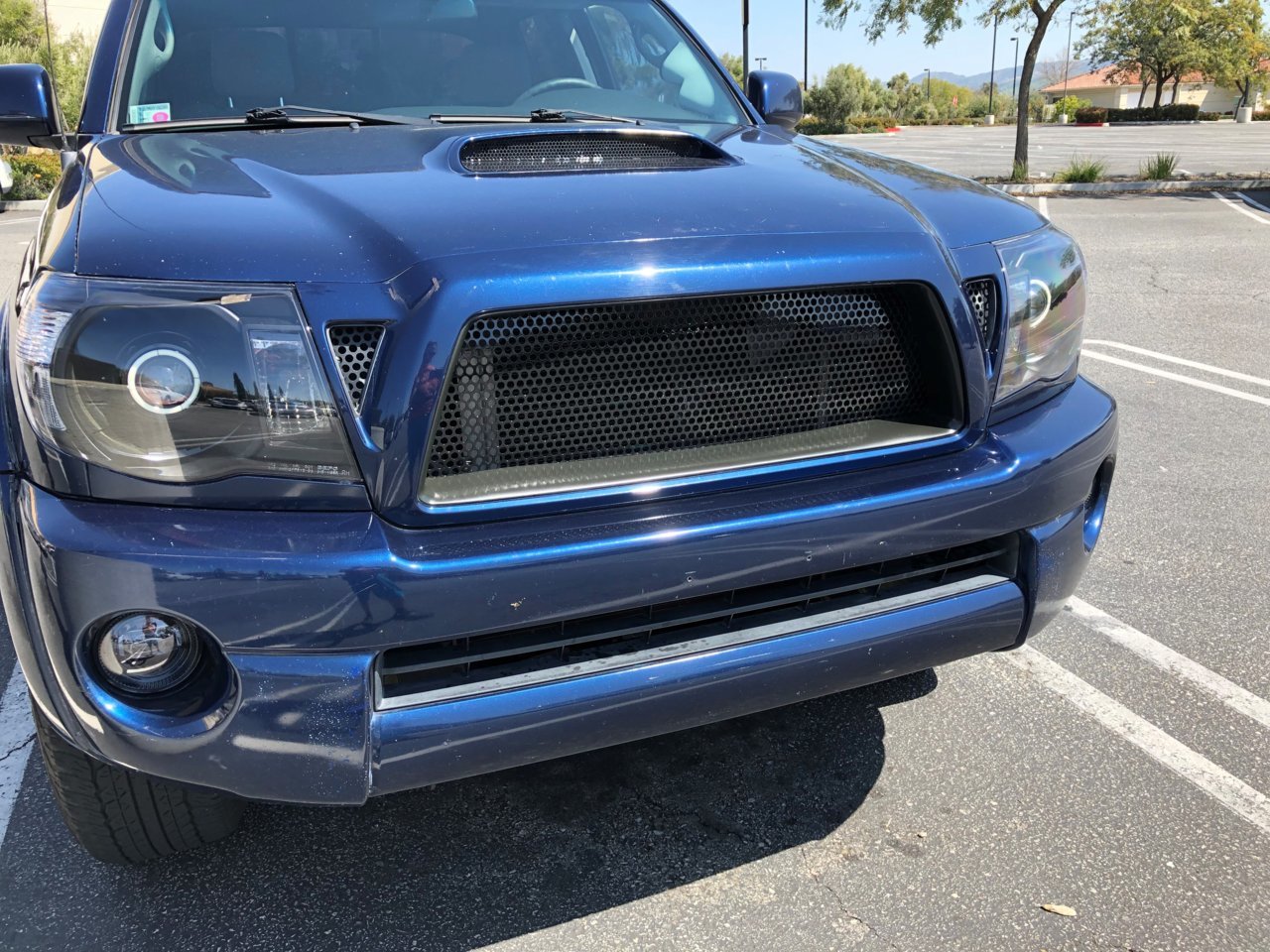

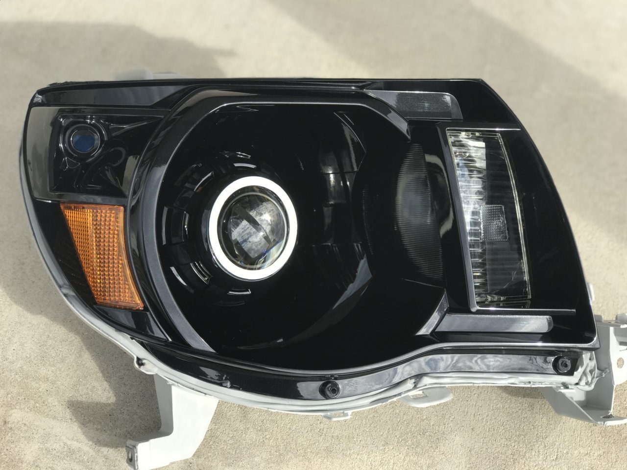

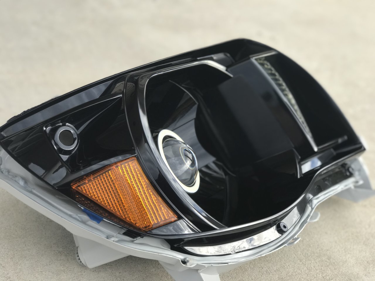

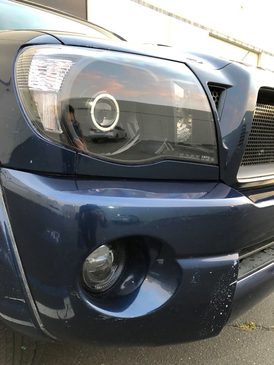

    I recently completed the full projector retrofit on mine. I used Depo brand headlights in black which has the internal panels already blacked out, aside from the reflector bowls of course. I painted those during the retrofit.
    The quality of the Depo is good, especially for $80 for the pair. The only area I notice discrepancies with the non OEM lights is where the grille sits into the the tabs on the headlights, and the passenger side headlight seems to sit farther back than the driver. The difference are very minor and overall very livable considering the low cost.
    And the projectors (and halo's I opted for as well) are fantastic and produce better light than my wife brand new Flex, so now I'm spoiled on light output.

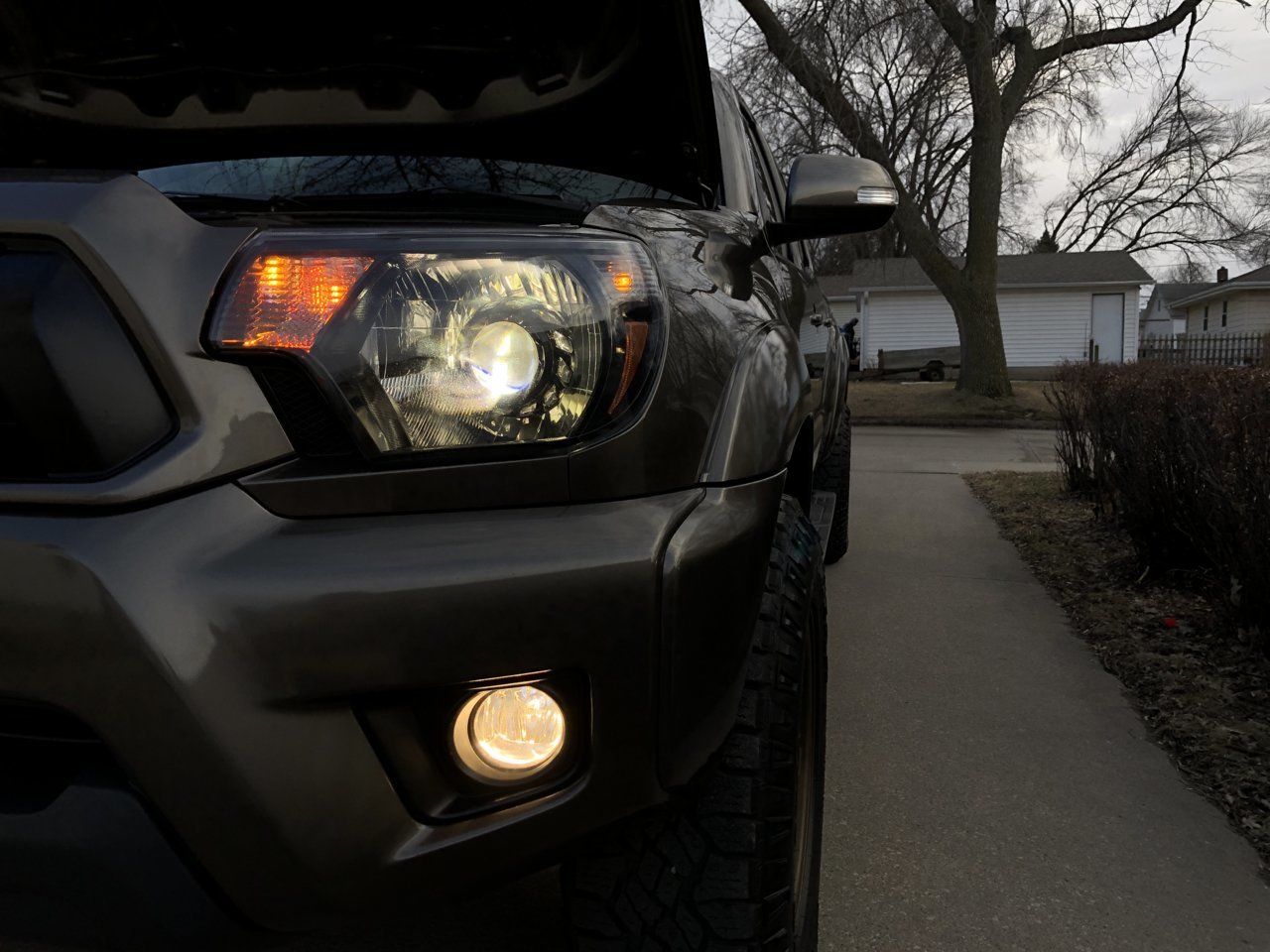

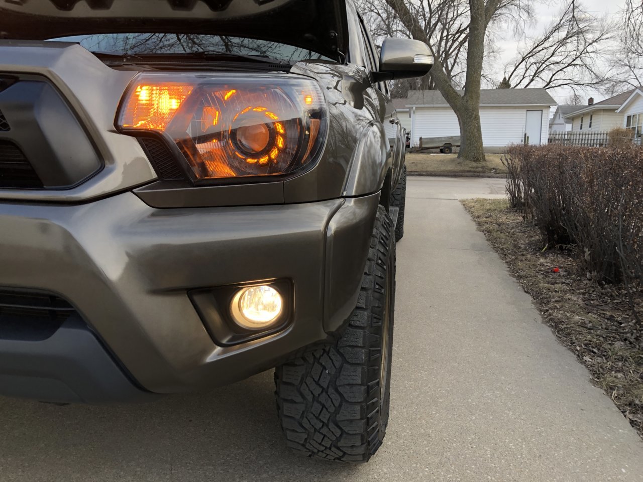

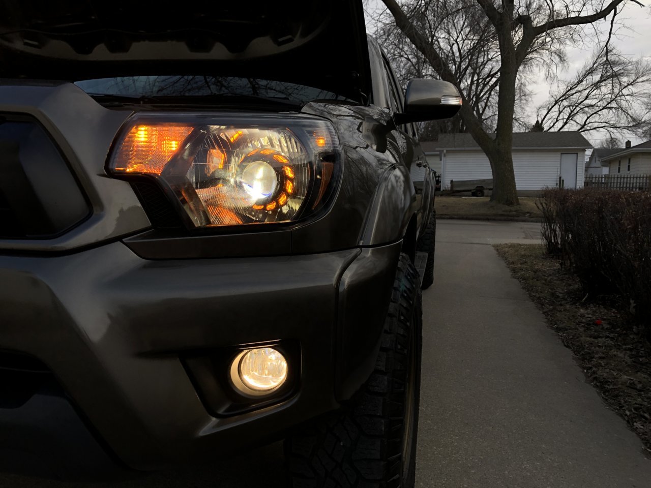

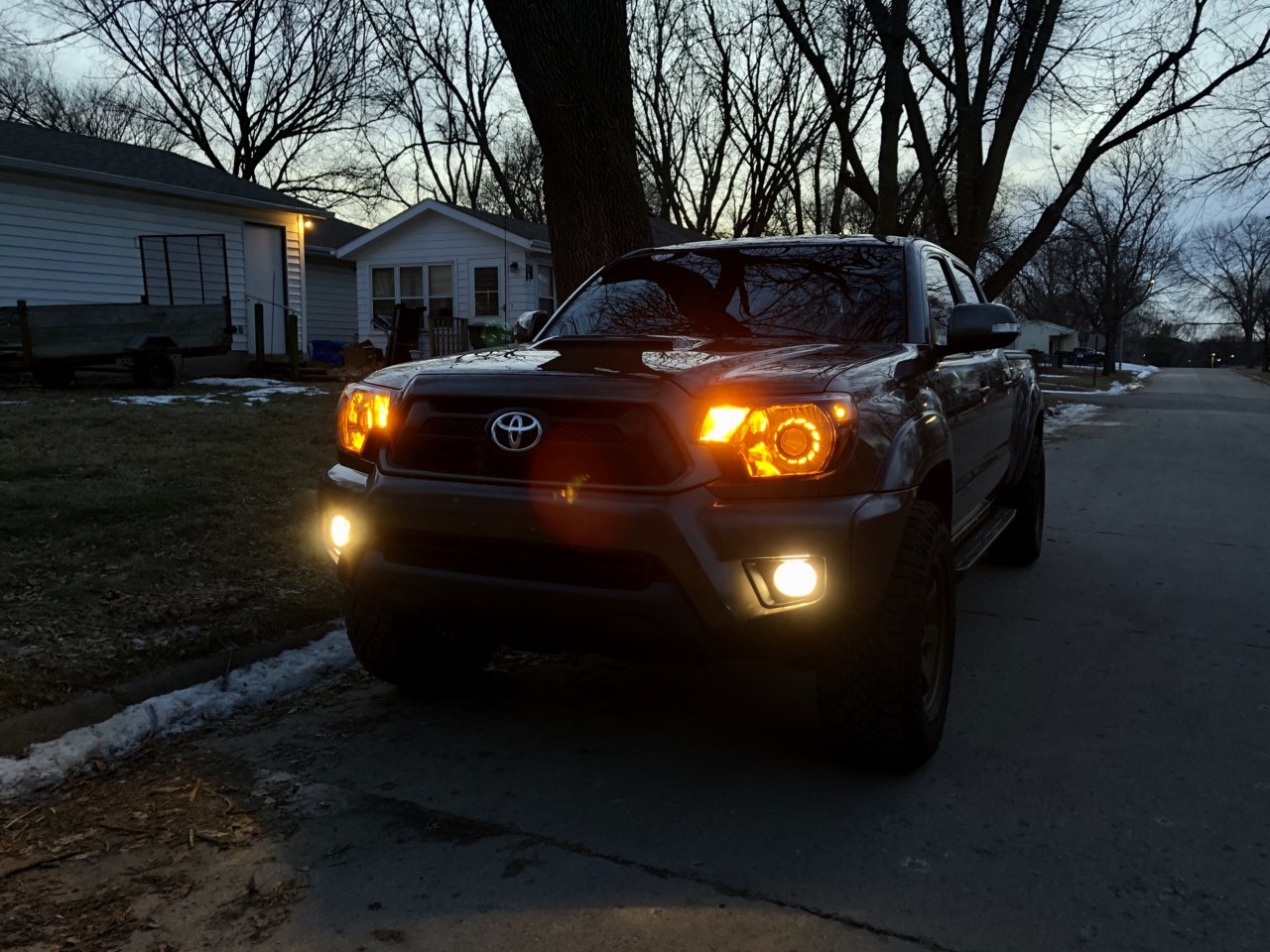

    I did a retrofit on my OEM headlights. RX350 EU projectors with clear lens swap, Osram Nightbreaker Laser bulbs, Hella Gen III ballasts, Turbine shrouds and Profile switchback halos (white not hooked up at this time). My running lights and blinkers are Sylvania Silverstar 3357A bulbs (neochrome look, a slightly deeper amber color and higher wattage making them brighter). I had the H4 Philips Racing Vision bulbs before and those are absolutely fantastic! Truth is I had most of the retrofitting parts for almost 2 years for my Tacoma. But it was the last personal vehicle to get retrofitted as it had the best factory output. We have 3 cars and one motorcycle, all of which are retrofitted!!!
    The wall is about 80-100 feet away and this is the low beam. The light spread is very nice! The only thing I think is lacking on these projectors is a good hotspot, otherwise they are almost unbeatable for width.
    Low beam on/running lights on. I have the projector shroud and headlight trim painted in a metallic black, but you can't really tell it's metallic unless you get really close.
    Low beam/blinker on. The halo turns on with blinker/DRL function and DRL brightens.
    DRL on. I actually prefer the look of the amber over white. Everyone does white running lights and I feel like it's a bit over played now.
    DRL in a little darker lighting. You can see just how bright those DRL bulbs are. Very noticeable without being blinding, a safety win win for sure! I have the same bulbs in the rear blinkers as well.
