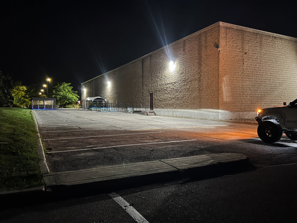

    TegoTaco
    TegoTaco Well-Known Member
    Sep 29, 2016
    #198555
    7,371
    Ontario, Canada
    ‘13 SUPERCHARGED DCLB TRD SPORT
    I almost went for the Morimoto headlights, decided to build my own set of lights for about 1/3 of the price!
    Lights were aimed a little low here.
