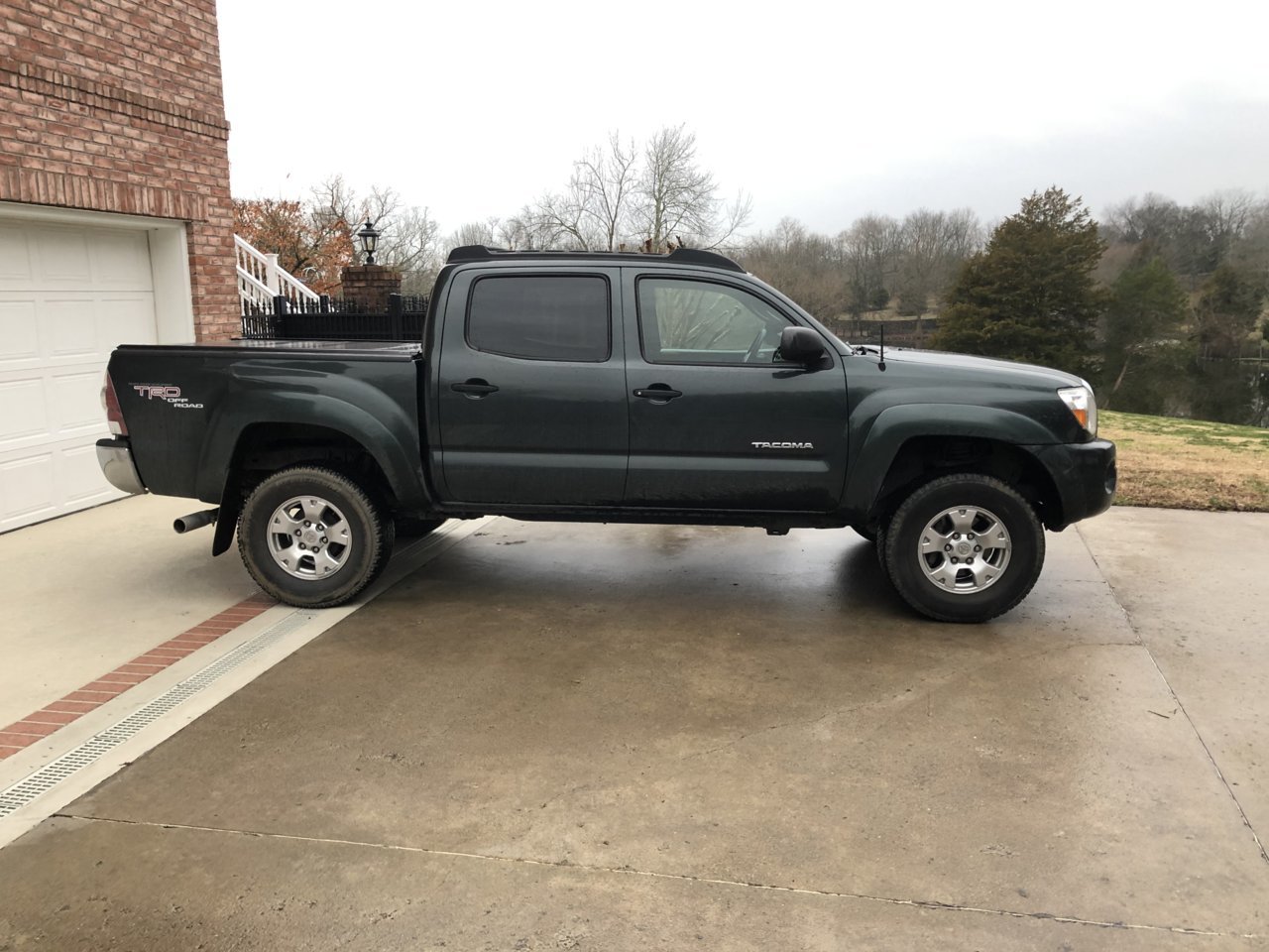

    Just finished the lift 5100s @ 1.75 and 1.5 add a leaf.

    On my Truck I didn’t have to. Also I appreciate all the advice you guys gave.

    Looks good. Were the alignment cams seized?

    Surprisingly not! There was no major issues with installing them and thank god there was no extra things I needed to replace.
