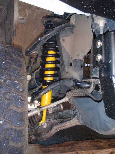

    OME. Make sure you get the proper coils. 884, 885, or 886. Also get new UCAs , and extended brake lines to the rear axle. I went with 886 coils. The coils are too stiff, even with a winch/bumper. Didn't get the UCAs or brake line extensions so those are all getting ordered.
    *Lots of people say to just get the lift and you won't need those other parts. Don't listen to them. If you want to do it right don't short yourself.
    Can't comment on the rim situation, my truck came stock with black rims.
