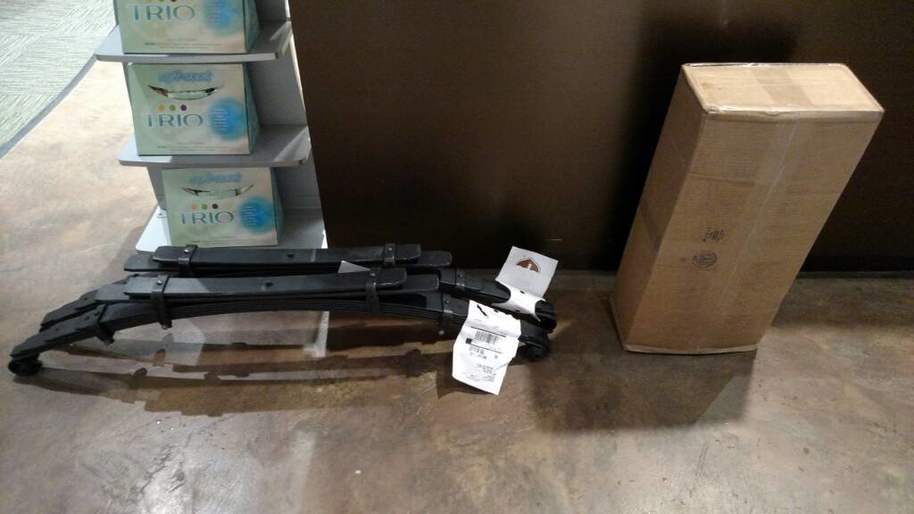

    Got my OME kit via UPS yesterday.
    Dang those dakars are heavy!!
