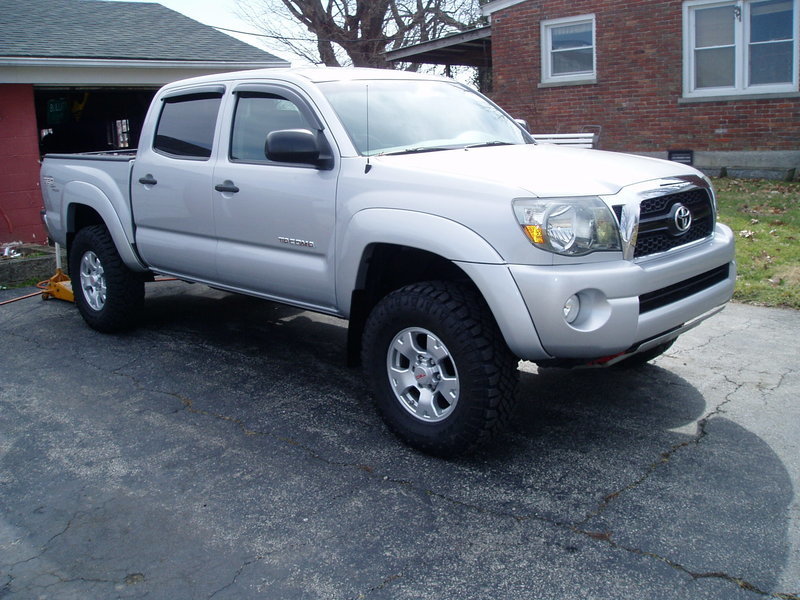

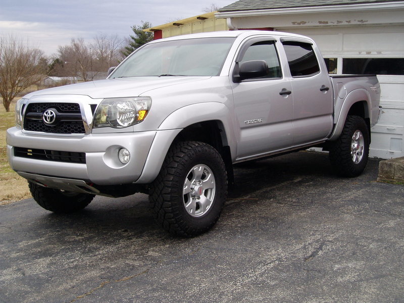

    Diff drop is a waste of time on 2nd gen trucks....Just that simple....It will cause more issues than it could ever solve. . Go with what works..... In this case, it's leaving the diff drop in the box.
    The best bang for the buck lift is available from Headstrong Offroad..... It's Bilstein 5100's and OME coils. I like 885's for 2-1/2(+) lift. (set @ 0") get them to assemble the struts...Then (at minimum) Deavers 2" AAL. (If you really want more weight capacity, go Dakar leaf pac) For $80 more, have 'em include rear U-bolt flip lit. If you really want the full 3", go with 887 OME coils. This will most likely require the addition of aftermarket UCA's....which will add $400 to $1000 to the cost of raising the truck, depending on brand/style of UCA you choose.
    With the 885's, it's UNLIKELY you'll need aftermarket UCA's to get in good alignment. I got splendid numbers and stayed in the middle of adjustment range on my alignment.
    The "kit" comes with 1/4" lean spacer. For some unknown reason, my truck needed a 1/2" left spacer to get level side to side....I make my own poly spacers, so this wasn't a big deal.
    I ended up with 2-5/8" front lift and 2" rear, a MUCH better ride (firm, but compliant) A good look, and great off road performance. I personally do NOT like preloading stock coils (setting shocks to "higher settings" while using stock coils) Harsh ride compared to longer coils.....AAL is far better than blocks because stock rear leaves are too soft. There are various versions of AAL's available, and several complete leaf pacs. Depends on amount you want to spend.
    Since installing this lift, I've logged just over 20,000 miles, several off road "adventures", and hauled a few heavy (for a Tacoma) loads. I have NO negatives and quite a few positives to report. Highway ride is awesome. Low speed road ride is AT LEAST as good as stock. With good alignment numbers, the truck actually HANDLES better than it did new.
    You MAY get a little "better" by spending a LOT more money, but increments in performance will be small in relation to dollars spent. Since MOST of us aren't flying off dunes or running the Baja 1000, just normal driving and sane, low speed off roading, a kit such as this will give you all the advantages you want while leaving a few peso's in the pocket for other mods....
    At one point, I had a much more expensive lift, which had some issues....Not going to mention it by brand....problems were cause by previous owner (of kit). I replaced it with a 2" spacer lift and had good luck with it for close to 50,000 miles. Just don't slam the front suspension....Spacers cause shocks to run out of travel before suspension runs out of travel....possibly causing shock failure. But, the ride was as good as stock, and I got the look I was after. When the shocks began to wear down (after a LOT of highway miles) I went with the Bilstien/OME/Deavers lift and have been MORE than pleased with the results.
