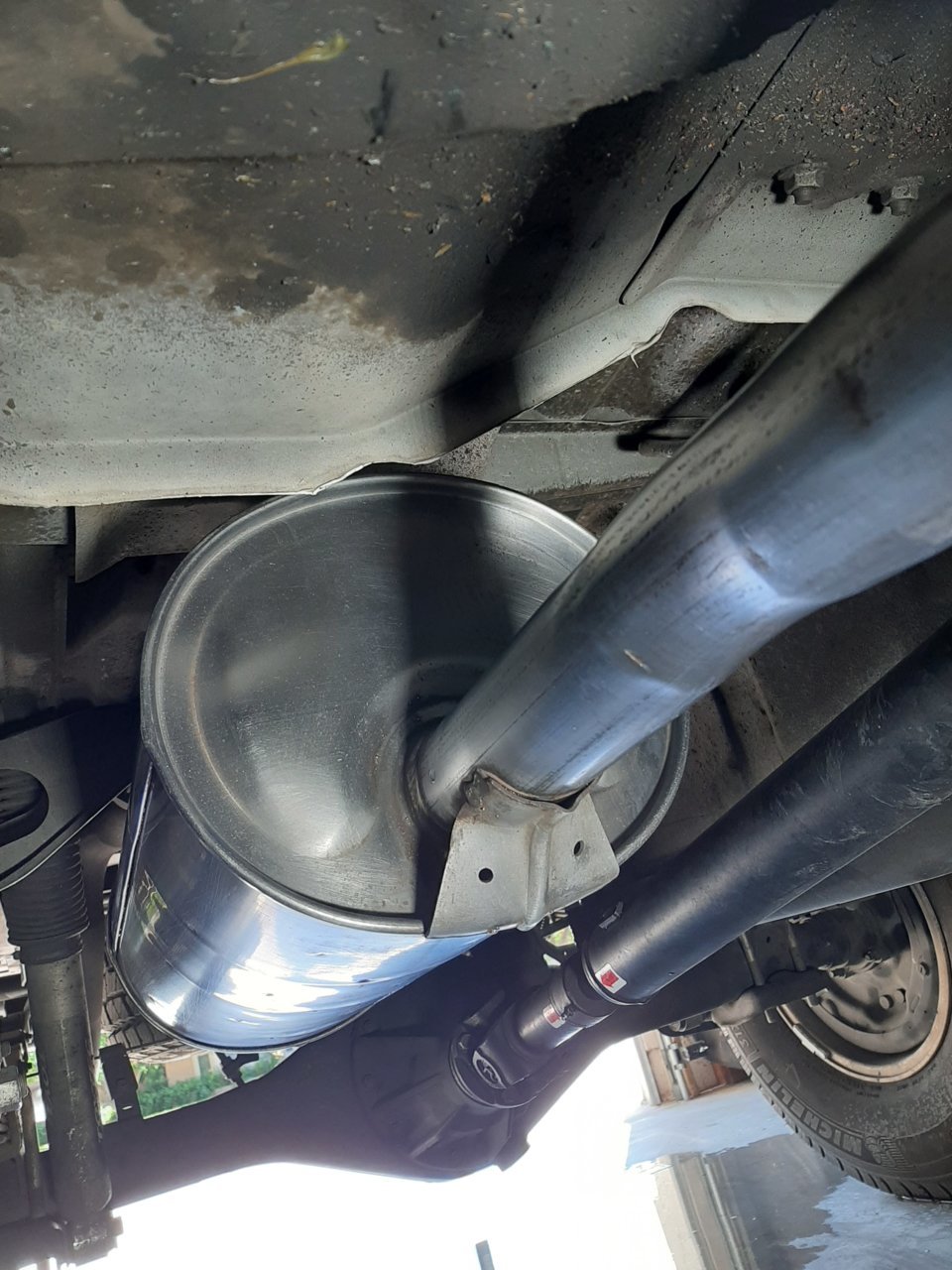

    I like my stock exhaust so much I polished it up with a scotch brite pad and some nitric acid. That's my vote.

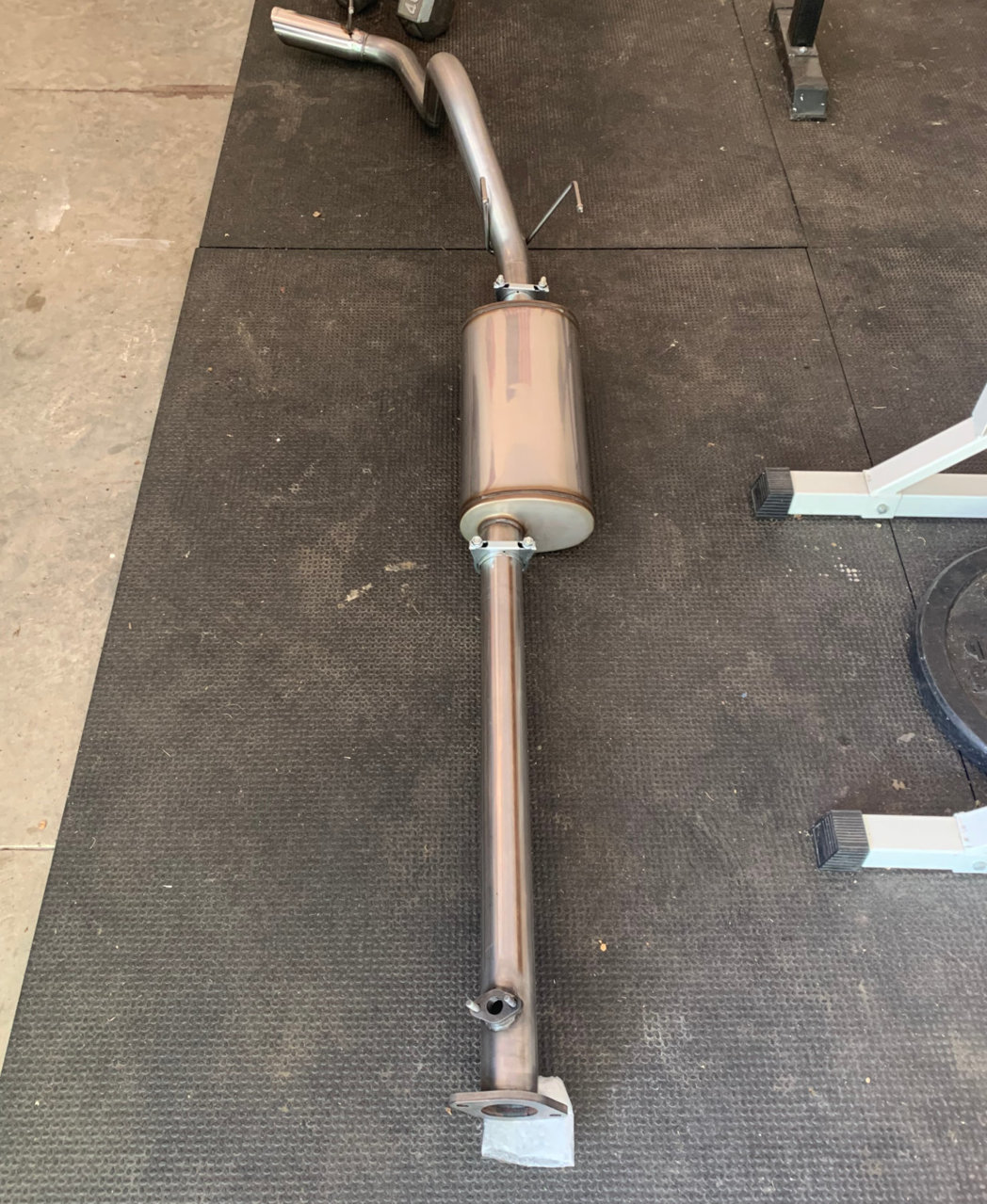

    I've been happy with the JBA catback (40-9015) I installed last year. Little bit louder than stock but not annoying.

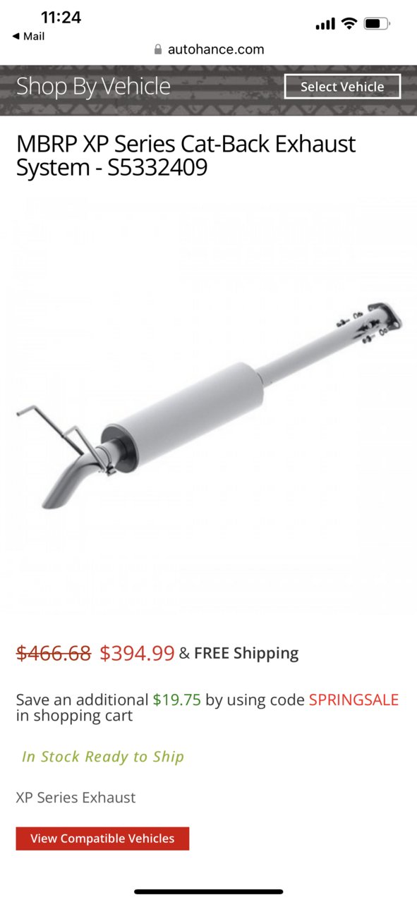

    Getting ready to install this one for my 3.4, nice low sound with my 2.7. simple and enjoyable to hear while driving. I expect a little more response from the 3.4 too

    Did you weld yours at the clamps? They recommend at least tack welding them but I was thinking of just welding the seams together.

    I didn't, I have a stick welder but I'm still not very good so I didn't want to risk burning through the pipe. I appreciate you asking though, I've got an appointment to get some sliders welded on in early May. I'll ask him to put a few tack welds on the exhaust and hopefully prevent any future issues.

    I’m getting my father in laws mig welder and I am going to do it with that. I want do a full weld and remove the clamps, but I can’t find anything that says to do it that or not..
    I do like the muffler though and it was fairly affordable and easy to put on.

    Good Afternoon John. That muffler looks brand new! Where do you purchase nitric acid and what does it do?

    That looks good I’ll definitely check it out!

    Thank you, not bad for a 24 year old muffler, eh? I bought the products from Amazon. Not to thread jack Mr. Kai's thread, but I'll just point you to this post I made about it. I'm glad I looked it up because it's actually phosphoric acid, not nitric acid. It's important to get the right type of acid so it won't strip the chromium in the stainless steel. I did not end up using the VHT Clear Coat because I heard it was stinky and it really didn't need to be clear coated. Two years later and it's still looking great, just some discoloration from the heat (purple/yellow hues).
    If you end up doing this make sure to wear some old safety goggles and long dishwashing gloves as it tends to drip when you're vigorously scrubbing. The stuff I bought is gel that foams up so it's pretty easy to work with, but it will irritate the skin and is obviously bad for the eyes.
