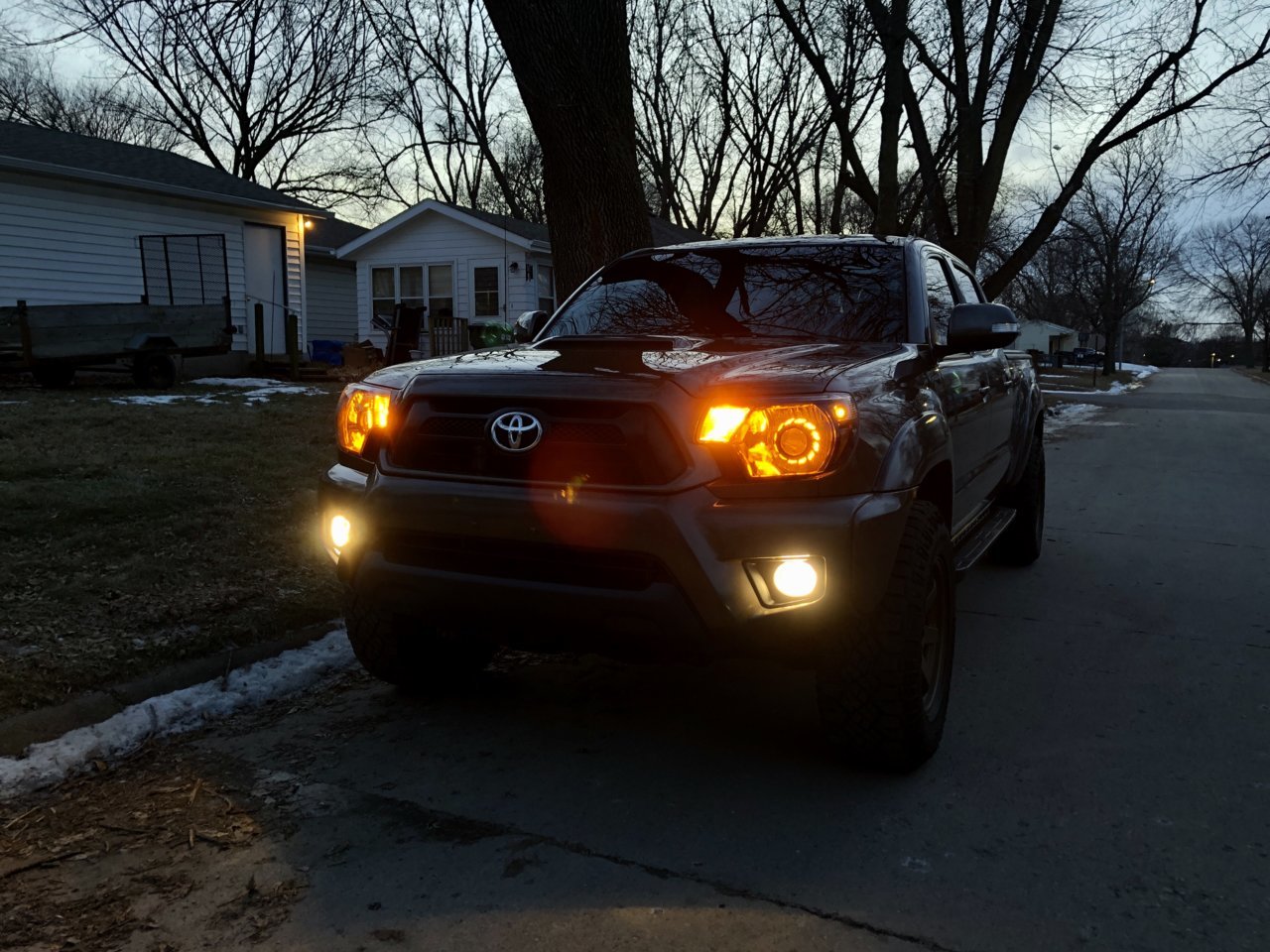

    These are what I have in my front and rear signals, they can be used in place of the 7443. They are very bright (higher wattage is the reason), a little deeper amber than a standard NA bulb and when off it has a pretty cool look. I also have these in my wifes Ford Fusion, which the bulbs I transferred from a previous vehicle. Those bulbs have almost 12 years on them and have never been replaced!

    Ooo those look like what I'm looking for. They work well for the drls and turn signals? I'd love a slightly darker amber light because my fogs are slightly darker amber!
