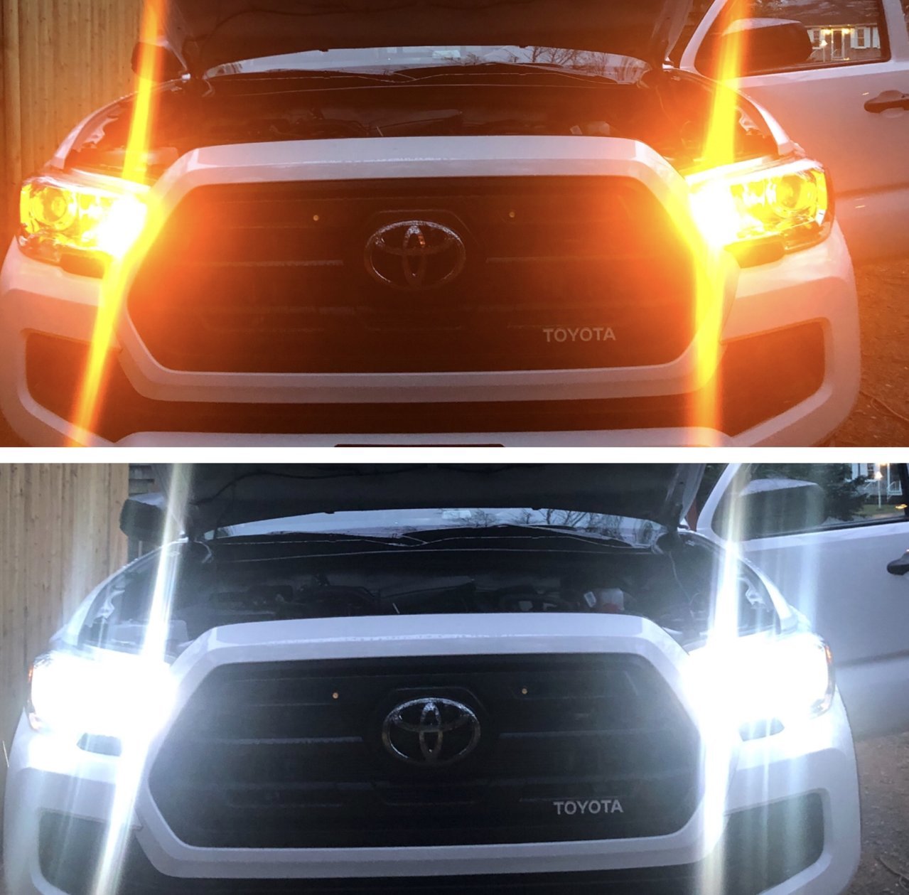

    i found them on Amazon search: Canbus 7444na. The only issue i have with them, when drl is in use they hyper flash **only** when you dont push the lever down all way when turning. (signal goes 3 times for highway lane switch) They are white led when low beams are on, and a rose mix color of orange and white when *parking lights* are on, other than that im cool with them.

    If you've currently got 7444NA halogen bulbs (which are 21W/5W) you would see a big difference by changing to 7442NALL halogen bulbs. (28W/8W)
    Oh yeah, it sounds like it works GREAT. o_O
