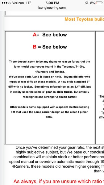

    The axle code is B03A

    Isn't that 2 pinion open 4:10 8 inch ring

    In a 1st gen, if you don't have the elocker, then you have the 8.4 rear diff and axle.
    The trucks with the elocker have the 8.0 rear diff and axle.
    These two diffs are not interchangeable in your axle assembly. To get a Toyota elocker like the TRD trucks, you'll have to swap out the entire rear axle assembly, from hub to hub.
