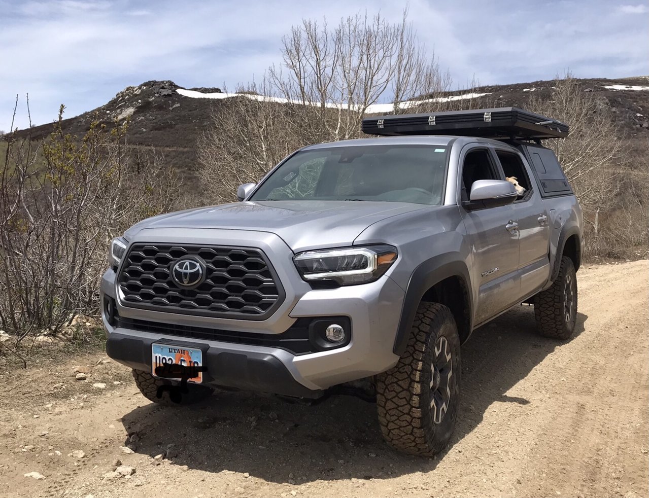

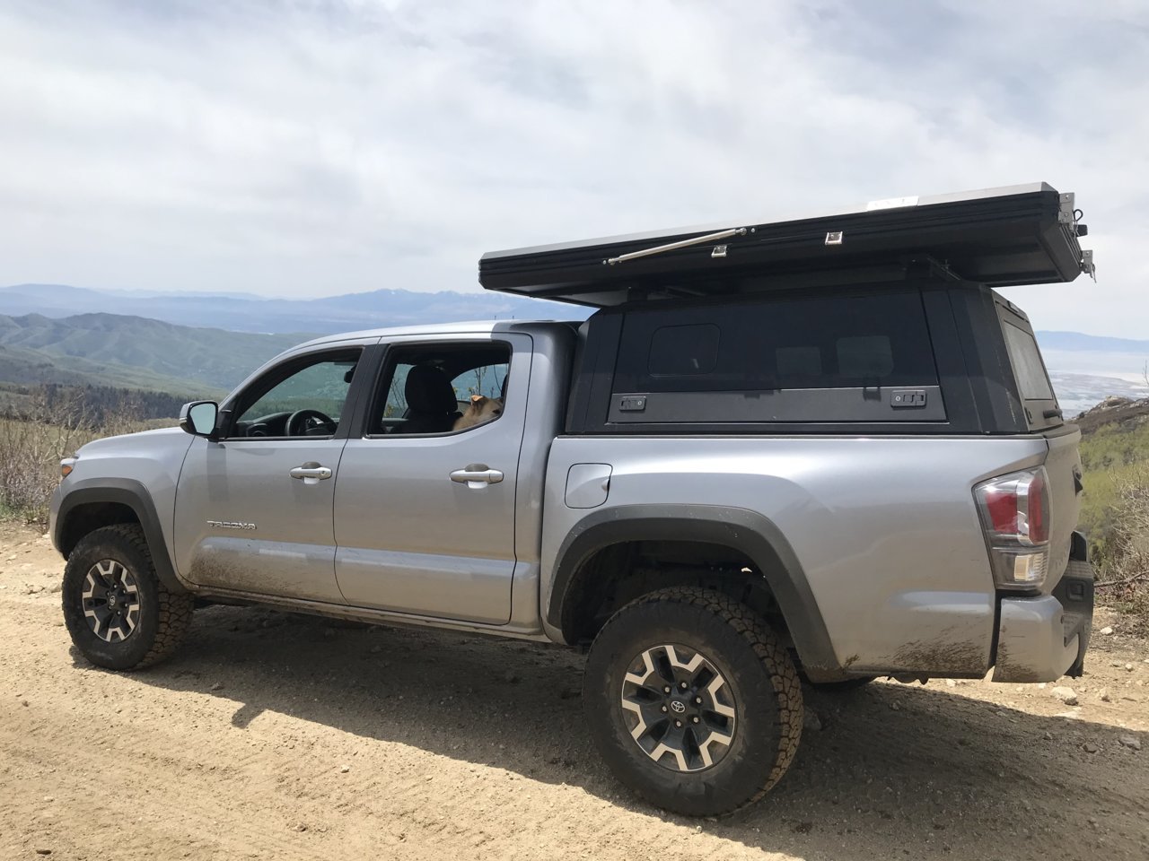

    This is she. Haven’t lifted the front yet... Only going to do 1”. I have a thing for being able to fit my head between the tire and the fender.... Proper clearance in my view. The rear is perfect. Debating sliders or a new rear bumper. Then maybe a skid plate for the fuel tank and that’s it.

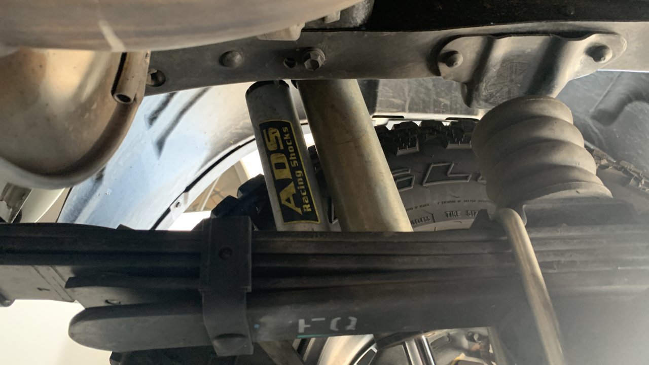

    I'm considering this set-up for my 2015. I have a set of 2021 TRD O/R OEM leaf packs with only 1700 miles of use. If I don't sell them I'll install them on my '15 TRD O/R with either a 2" tapered block or 2" AAL. I was also looking at Sumo Springs for the very few times I will be carrying extra weight. Can you post pics of your suspension?

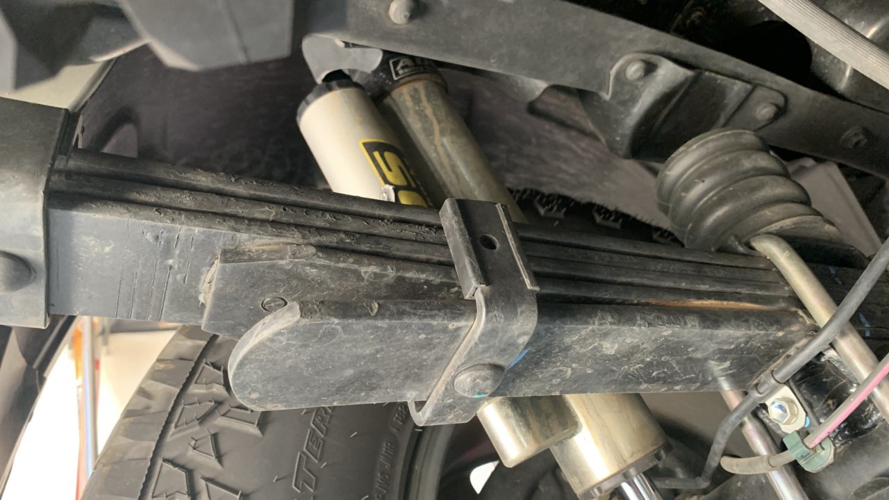

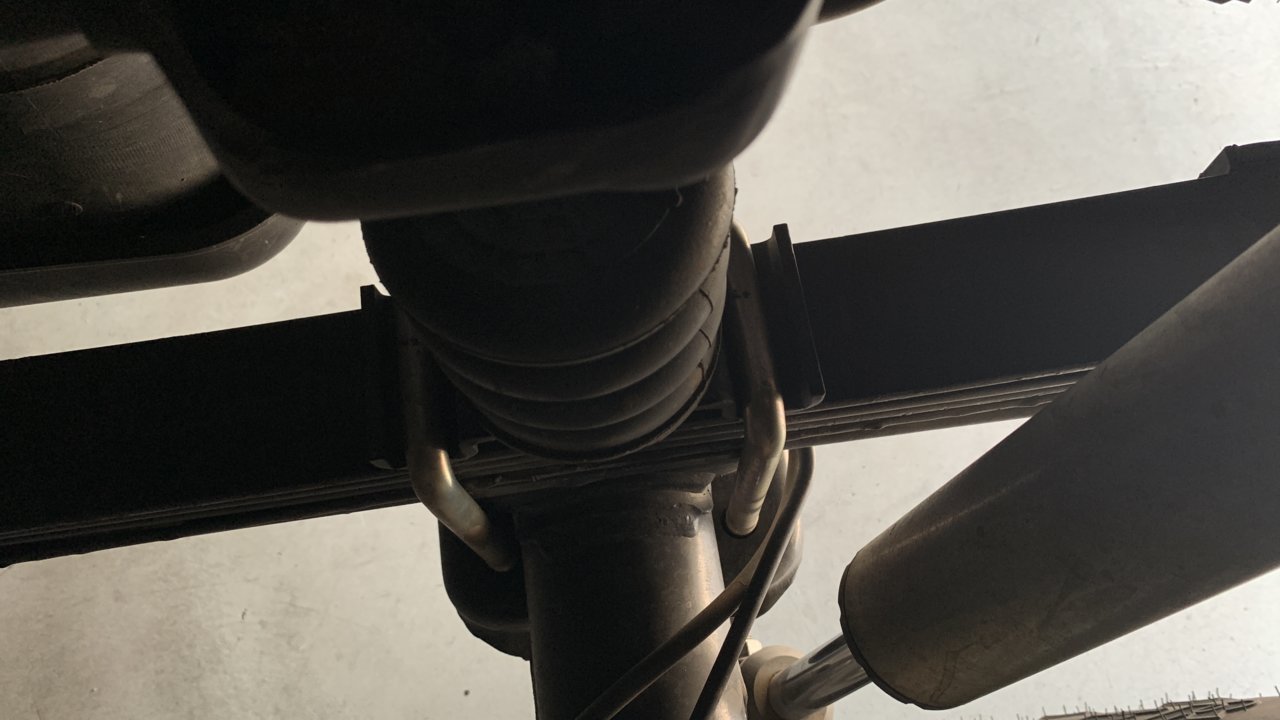

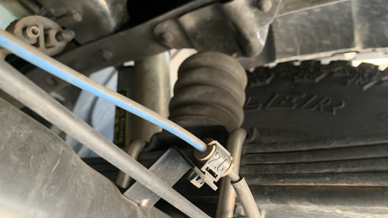

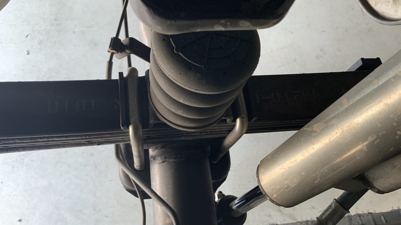

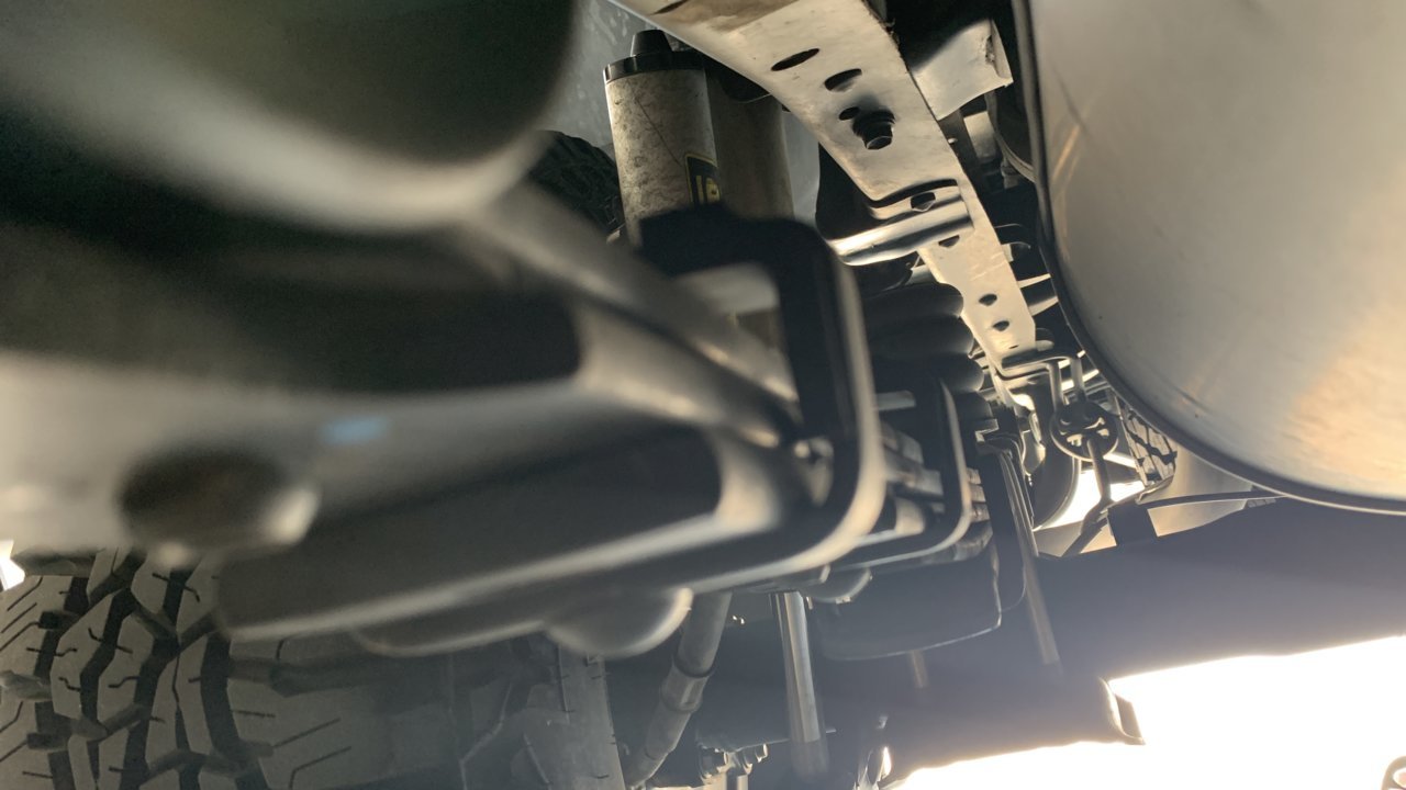

    618
    2020 DCSB OR

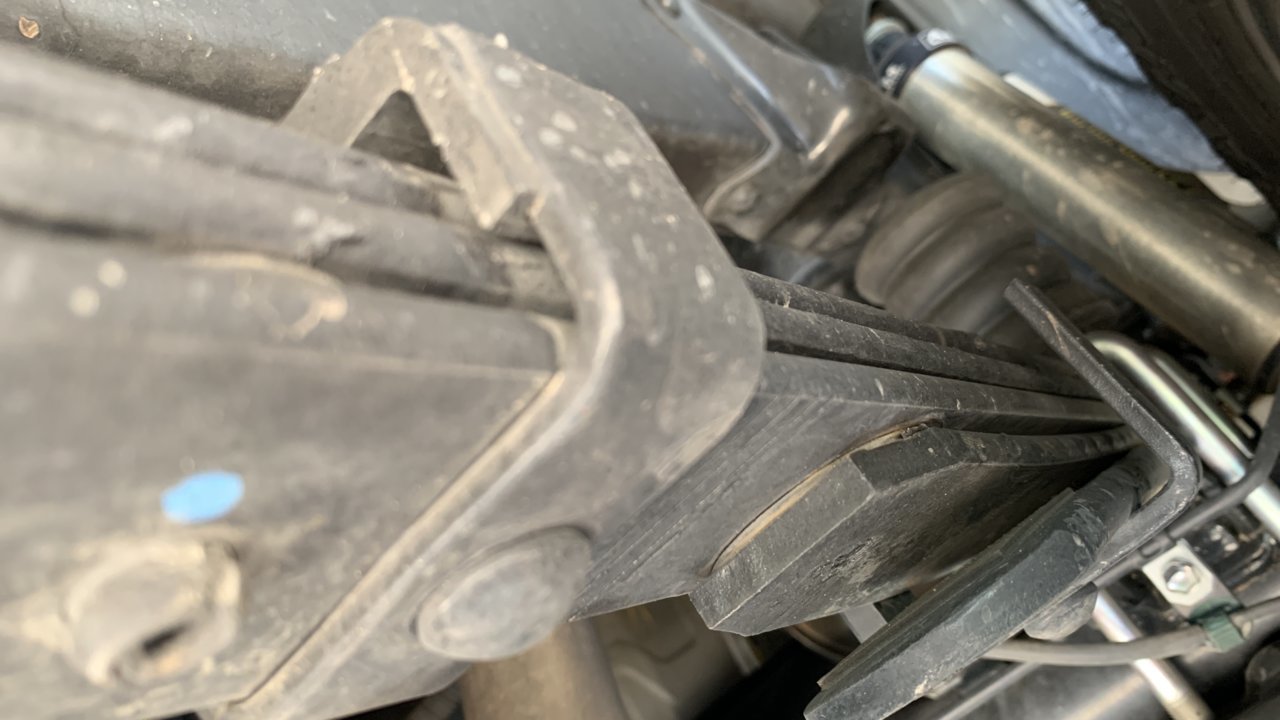

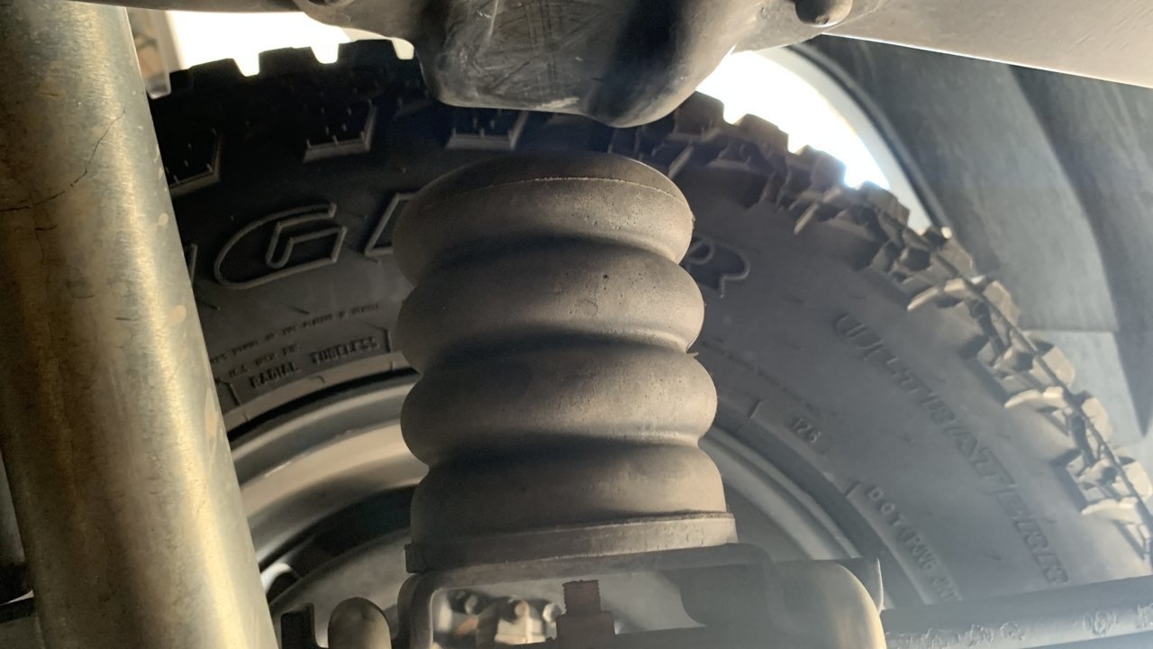

    Always willing to help. I didn’t pull a wheel, though.
    50FABDC4-9ACE-4130-A574-682297F531F8.jpg 87CEF182-D41A-4422-9D0E-D4E04627ED11.jpg C11E457E-B32C-47A5-83C8-92C3B25E1D44.jpg 524B3CC5-C401-47B4-A574-733F64919F11.jpg F68B238A-919F-4EED-903C-F756366B0F23.jpg FB92956C-EAED-4A3F-8D3D-BB4FD3B2C376.jpg B5832152-EC0A-4990-924E-547C0ECF5129.jpg 7088BA9B-9A3B-4B3F-A8F5-A3B8F970BBE4.jpg
    To me it’s the best setup around. Thanks to all the help from here.
    TAC1[QUOTED] likes this.

    Yes and no. Consistent with heavier coils and shocks, the ride on pavement will firm up. But off-road? It’s all right.

    Tac1
    Miami, FL
    2015 DCSB O/R 4WD
    Nice! Thank you!
    Looks like you have a good amount of space between the Sumo's & the frame. The Sumo's aren't as harsh as the Timbrens, from what I've read.

    618
    2020 DCSB OR
    Not harsh. Daily driving they’re not working at all, as you can see. I do like the support when articulating and moderate pulling/hauling.
