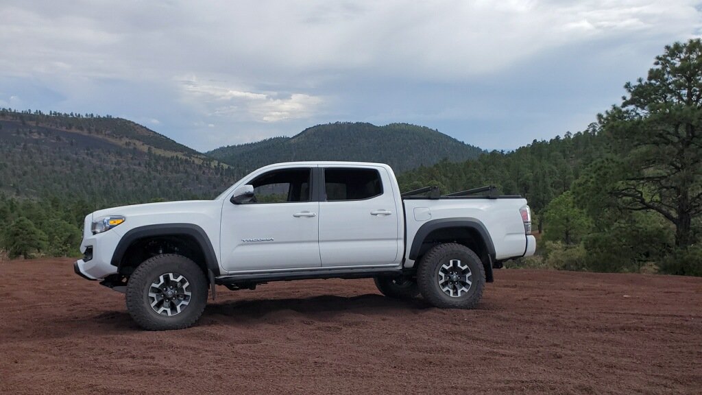

    #26
    gillies66
    gillies66 Just Passing Through
    Aug 18, 2020
    #338051
    618
    2020 DCSB OR
    No. No axle wrap. No other issues with my setup either.
    Dude. Look at my build. Around here, I’d say boring. Good for me.
    1.5” lift, whoop. In this regard, it’s essentially stock. But good shocks (sorry, no UCAs, front reservoirs or clickers), a bit heavier coils, and the simple, cheap and easily replaceable Deaver AAL, along with Sumos, gives exactly what I need doing.
    My truck is a DD - first and foremost. I haul light loads and I pull light trailers. For lack of a better term, I cross country my Tacoma. Lots. AZ is pretty darn good for that, and this setup hits the right balance for this truck.
    I don’t rock crawl. I don’t race. I don’t heavy haul. I don’t pull a large RV or commercial trailer. If I did, I’d have a different truck. No problem.
    It works for me, so I don’t see any bandaids here. I do see Cinder hills, though.
