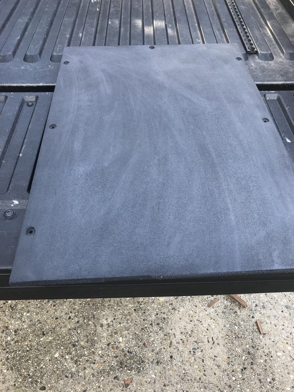

    What should I go with? Contact cement, 3M 5200, Roberts 2001, or liquid nails? I also used spray on truckbed liner for the wood, so wondering if that should be sanded back down as well?

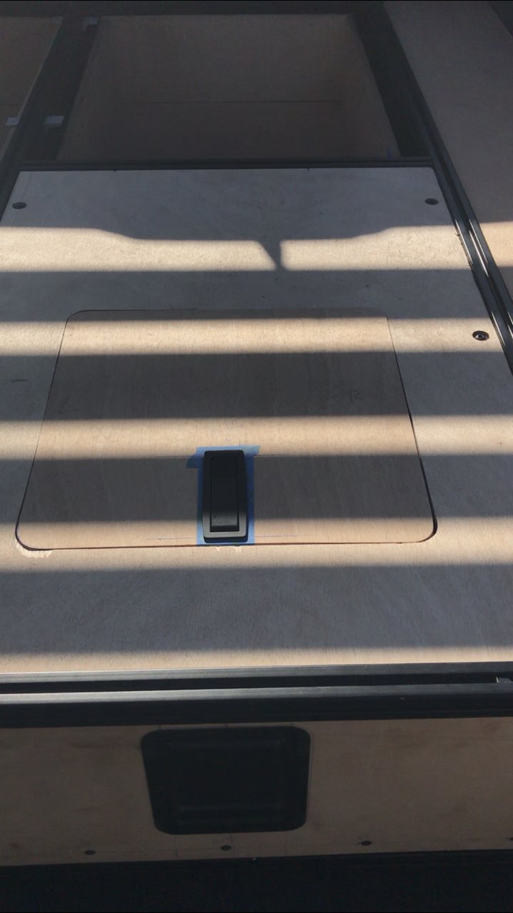

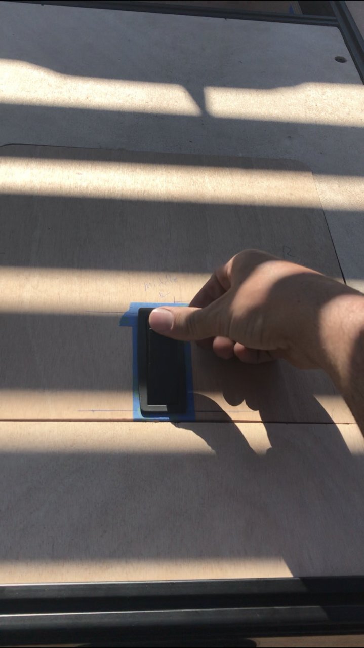

    Rgr that, yeah that’s my main concern with using rubber cement type adhesives, most of the rubber work will be on big pieces that simply require a good measurement or two. I do have some intricate work around the latches for my two top hatches in the rear compartments (attached.)
    thanks for the recs though! I’ll try it out on some scrap pieces to get my bearings first.

    A couple of tips when using Contact Cement, not rubber cement.
    Cut your bonded piece, not the base piece, a bit oversize. You can trim after its bonded.
    Use newspaper as a separation between the two pieces, pull out as you have sections positioned.
    Once both pieces are in contact with each other use a roller pin or similar to run over the surface. This will help to press the pieces together to help make 100% contact.
    To work around you latches, try the following.
    Remove the latches. Install the rubber, trim out the latch opening, install latch.
    The hatches can be treated like the main surface. Bond the rubber, then cut out the hatch following the gap btwn the hatch and main surface.
