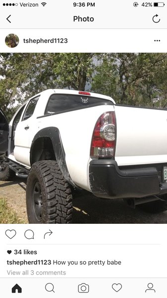

    It's deff possible on a 3" just maybe some spacers, here's an example of a guy on IG that spruce taco showed me

    Yeah I understand. I've talked with a few people with the same truck as me with 295/75r16 and 3in lifts and it's do able just a bit of trimming I'm going to have to do

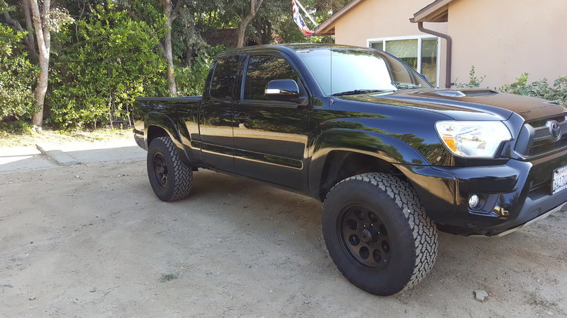

    Just get bilsteins and put them on the 3rd or 4th notch. If your just looking for a lift that isn't crazy expensive you can't beat it. As for offroading, it's definitely not the best but you'll be able to put tires on it. If you go larger get the can mount chop plates and trim away.
    I did 3rd notch and 285/70r17. Did all the trimming of plastics and the CMC. Its to hold me over until kings, spindles and uca next year. But that's mucho dinero

    Truck looks badass man. What rims are you running?
