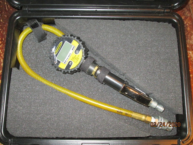

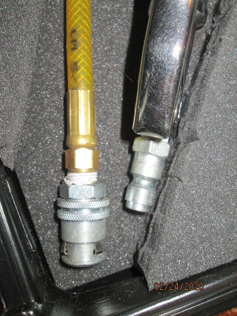

    Closed air chucks are just that. They are always closed (no air flow) until connected to a valve stem and then air will flow. Open air chucks are always open (unrestricted air flow, connected or not connected). I use open air chucks (Haltec H-5265-OP) on both my inflator gauges solely to allow me to bleed off air in the line to make disconnecting the air hose from the QD coupler easier......
