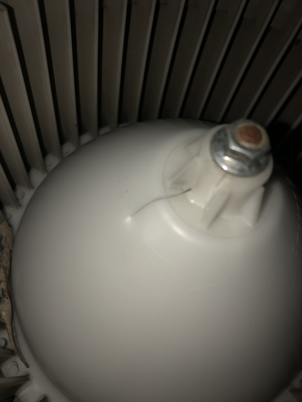

    Mine is making a crunching noise all of the sudden. I have had the resistor changed out a couple of times and now it is blowing at all speeds but it sounds like it’s going to eject through the dash
    I figured there had to be a critter inside it but it was clean.
