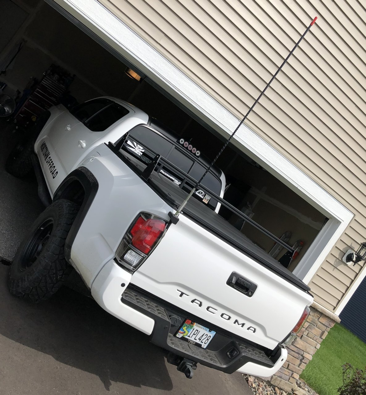

    4ft firestik heavy duty spring and quick disconnect. Running the same radio

    Minnesota
    2016 TRD OR DCSB 4x4
  12. Sep 29, 2018 at 8:23 AM
    That's why the pic looked familiar. Doh!
