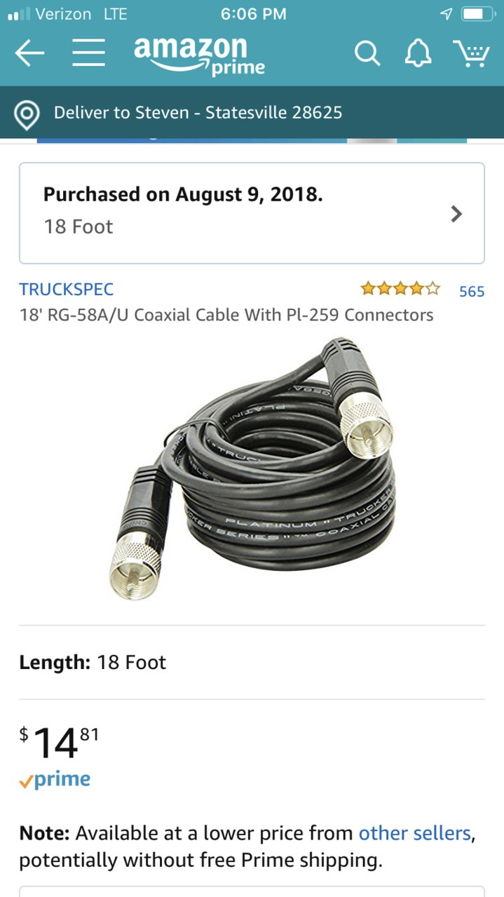

    What I used

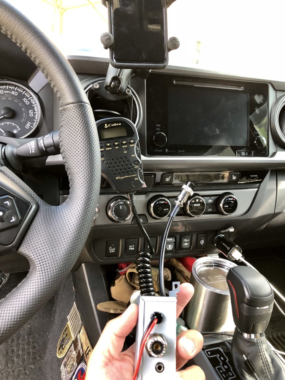

    Routed my cable to right under my drivers seat. People with the cobra 75, where are you guys mounting this box?

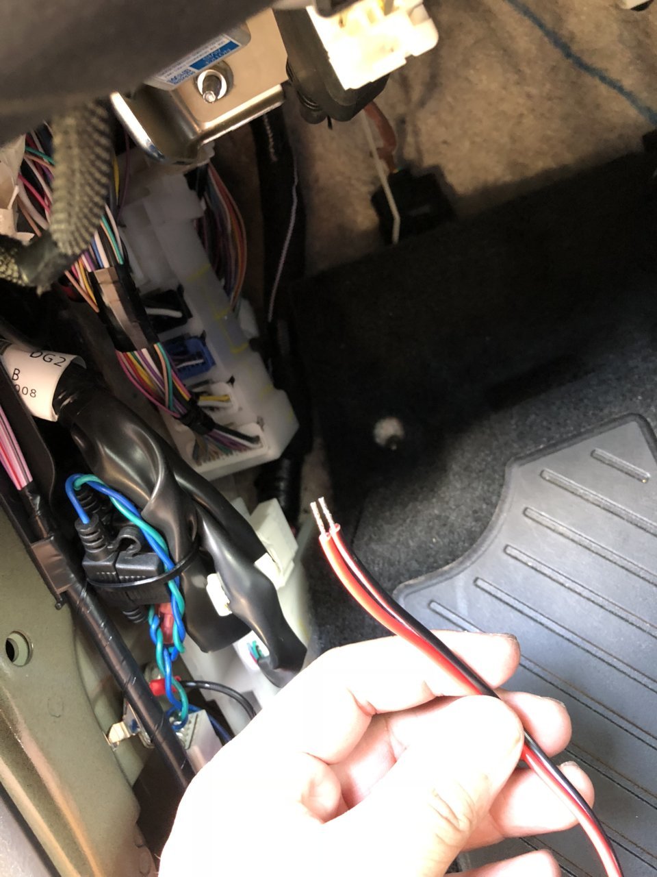

    This is why i hate electrical.. i dont know where to get power from

    why can't you mount the antenna up front, at the back of theca on the corner of the truck bed....

    Would be best to run directly to the battery - if you only want key on power, then run it through a relay, and power the relay from something like a fuse tap on the accessory fuse.

    That would also work just fine, but it's not the ideal location due to the proximity to the sheet metal of the cab. Also consider that if you're going offroad, it's going to be bouncing off branches, which means in that location, the antenna could be bouncing off your cab.

    You may get some brake interference, but you can just do the wires to a dc plug . One under the screen and one in the center console..
