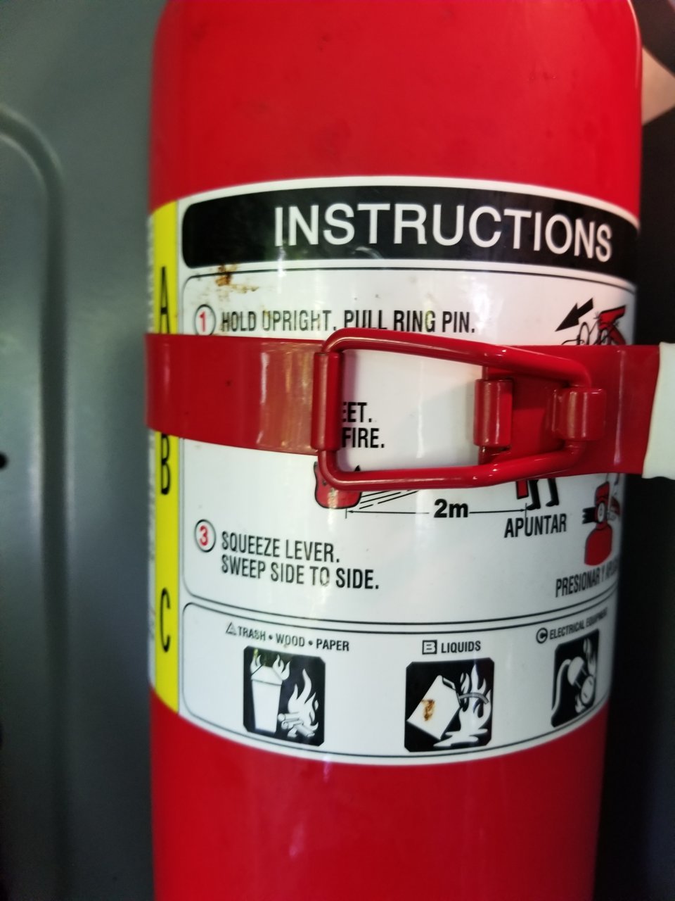

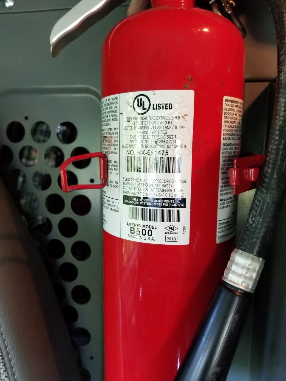

    Most auto extinguishers are only BC rated, as that is the typical, fire you'll encounter in a auto. B-Petroleum based(fuels, oils, plastics, etc), or C-, electrical.
    These are what we use in our Van's. In fact every service vehicle I've had used these. I HAVE used them before.20180930_095225.jpg 20180930_095301.jpg
