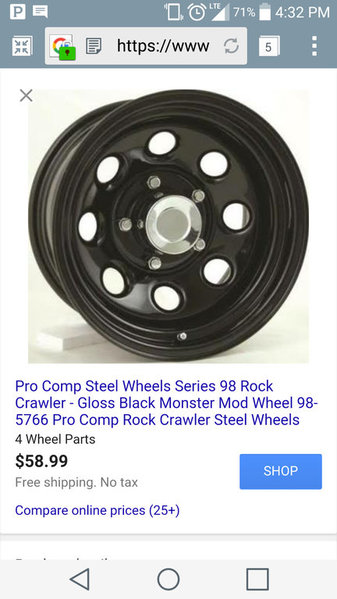

    Or will it be better to just buy something like this with cprrect BS?Screenshot_2016-02-01-16-32-38.jpg

    4.5 bs, but I've seen people run that size tire on stock wheels. you could go that route with new wheels too, 4.5 bs or 3.5 bs will do. your wheels will just be push out more which would give it a nice stance.

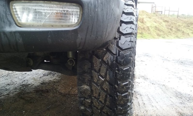

    Stock wheels and 11.5s clear but its close to uca and a little frame rub at full lock.

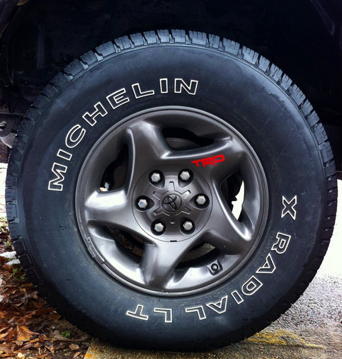

    What about sticking with stock rims and adding wheel spacers?

    285/75r16 Stock wheels 3in lift and .25 wheel spacer still runs on control arm at full lock but no frame rub

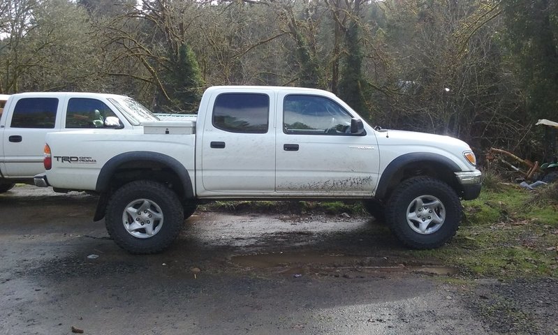

    I run 33x10.5x15 on factory wheels. With the 2.25" ish lift, they operate like OEM 265/70(75)/16 tires. The 33x10.5 should have been factory in my opinion.
