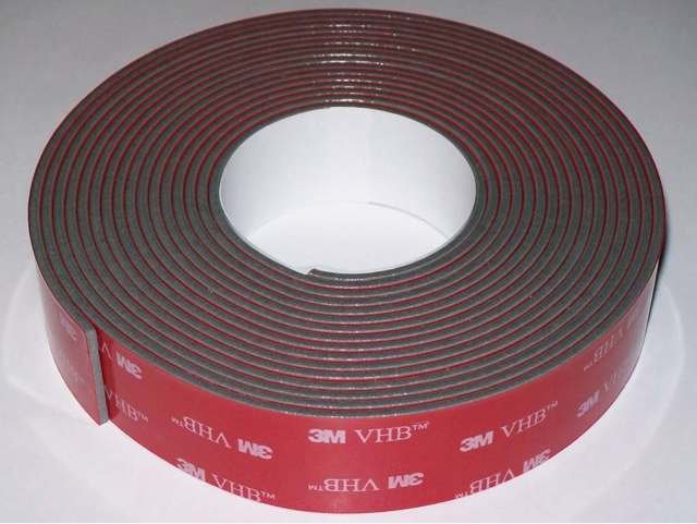

    There's been several posts about it, but I'm planning on blacking out the badges on my Taco, and wanted to get a better idea of the best tape to use, i.e. slimmest tape, stickiest, so on and so forth. Also, which paint is better? Plasti-dip, or Krylon's plastic bonding?

    I used krylon fusion & 3m tape like the stuff on vent visors. I've seen guys use plasti dip & they don't take off the badges. They just tape around it, spray then peel the excess off.

    I used the thick 3m tape with the foam
    It worked really well, i just stuck two long strips to the back of the emblems before paiting. Cut of the excess around the letters with a razor, then painted, clear coat, peeled the backing off and stuck it to the truck, used a hairdryer and some pressure and they are on there pretty solid. I used krylon plastic fusion, barely any prep work just cleaned the badges really well

    Tape: 3M
    Blacked: Plasti-Dip (adheres better than any paint, won't chip like paint can/will, and can be removed completely)

    Just clean it really well. Plasti dip is meant to be able to peel off i you want it to.
