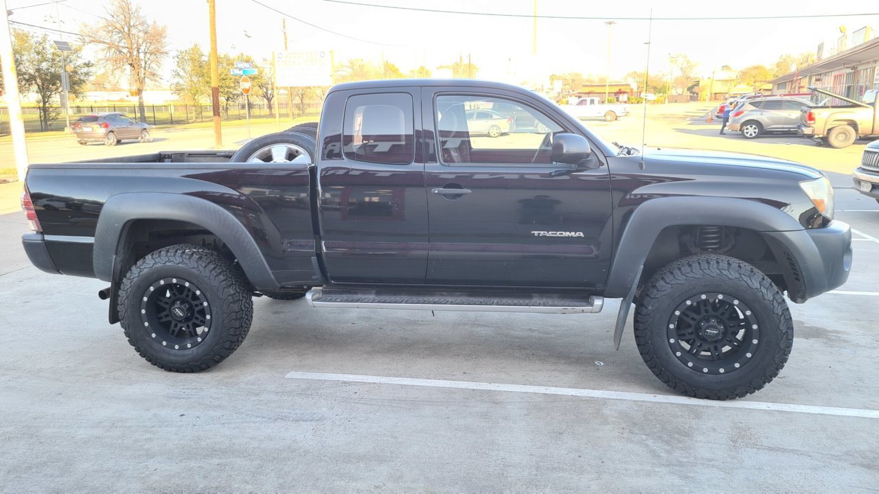

    So I had bilstein 5100 with toytec coil overs in front with bilstien 5100 and toytec add-a-leaf in the rear. For wheels I got 17x9 -6mm offset ProComp and 285 70 r17 BFGoodrich KO2 10ply tires. I am very satisfied with the look although the tires barely rub on the front plastic in reverse it is not a big deal.
    The only issue is that the kit raised my truck more than anticipated. I believe I got about 2.5 inches in the rear and 3.5 inches in the front which means I think I am going to have to install aftermarket UCA's. I wanted to avoid purchasing them because they went over my budget but the steering wheel drives extremely tight and on heavyyy bumps I believe my stock UCA's make contact with the front coils.
    I do not plan on going off-road! I want something that will keep my steering wheel from pulling so much while driving and something that wont break the bank. Please give me multiple options at different price ranges if you can. If you could also explain what camber and caster means for the UCAs' recommended that would be great. Also any other tips or advice will be great.

    I thought the toytecs were adjustable? Why not just lower the truck an inch in the front?

    might...might not. it will cost you nothing to try. but...it is the first thing I would do.
