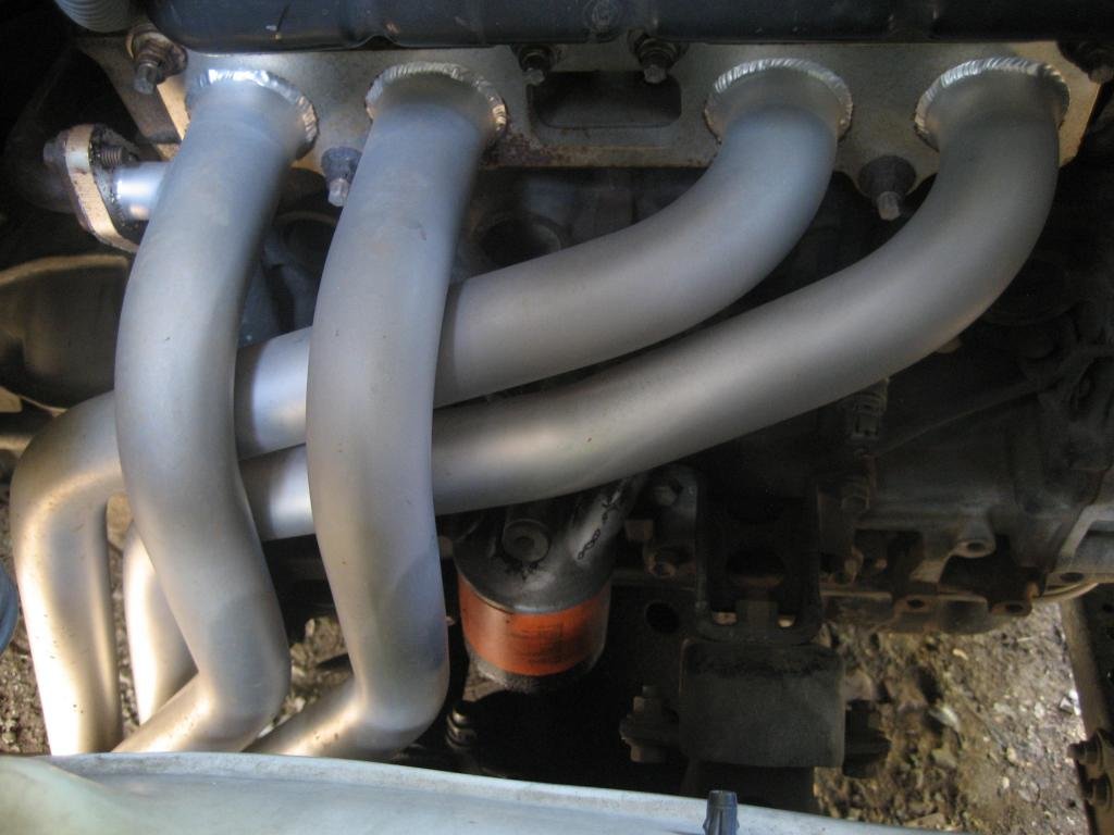

    LCE also makes a long tube header for the 1st gens. This what it looks like on my 1996 after running it for over ten years. The finish holds up really well...
    The runners are long enough to eliminate the down tube and to bolt directly onto the cat. Makes lots of low end torque. :)

    No. I left the stock cat alone so that it would pass smog inspections. Cats don't hurt performance.

    How many cats do you have on your 2012?
    My '03 has 2 which eliminated any thoughts on going with the long tube header.

    My 2012 has (edit) two cats, and they don't interfere with the exhaust flow. Long tube headers allow the engine to reach it's peak torque at lower rpms.

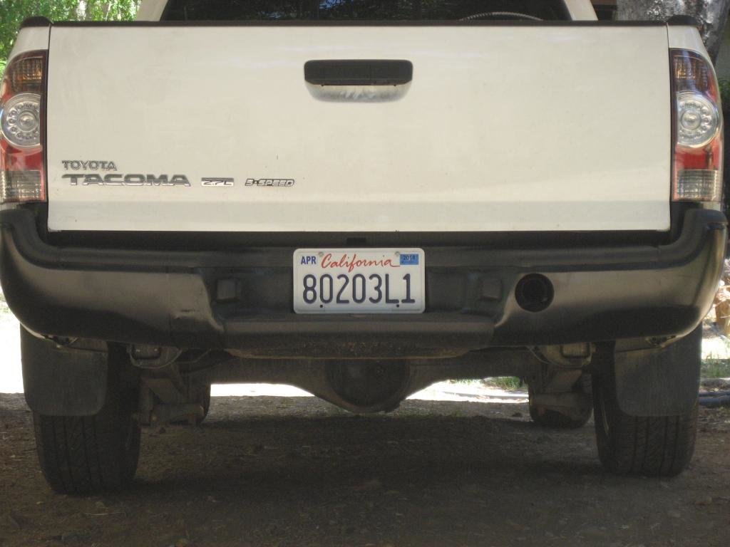

    I think the joints could just a little loose because of the odd tubing size, but you should be able to cinch down the U bolts enough to seal. I had a muffler guy do mine because he really knows his business. He fabricated a mandrel bent custom exhaust with all the hangers to fit a hole I made in the rear bumper. The installation was perfect. :)
    This is how it sounds...
    https://www.youtube.com/watch?v=cMv-imsBZLI

    I like the custom exhaust! I've actually decided on going with 2.25. I think it will fit better. I'm going to expand the pipe about 1/8" with an exhaust pipe expander and then fasten the joints together with butt clamps. Did you have your exhaust welded Tooter?
