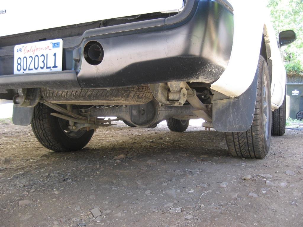

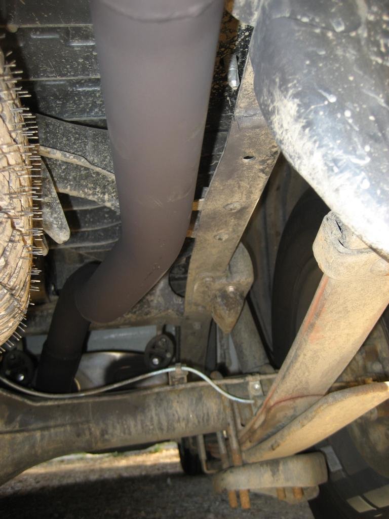

    Yes. I had a professional with a mandrel tube bender make up the whole system. The pipe needed compound angles as the clearance was really tight. The guy eyeballed everything and built it from scratch. It sounds great and nothing knocks on anything else. :)

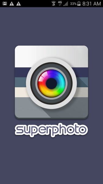

    Lol.. Thanks! It's a phone app.

    It's called "SuperPhoto."
    The filter is "painting."

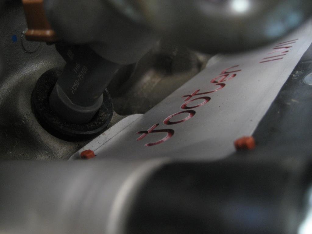

    Built for maximum low end torque, tooter II.VII intake manifold spacer, LCE long tube header, Injen long tube intake, 2,900 rpm torque peak.

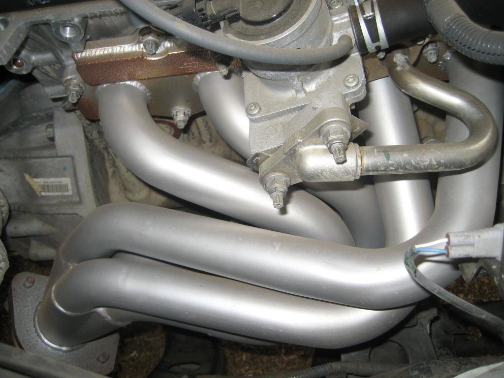

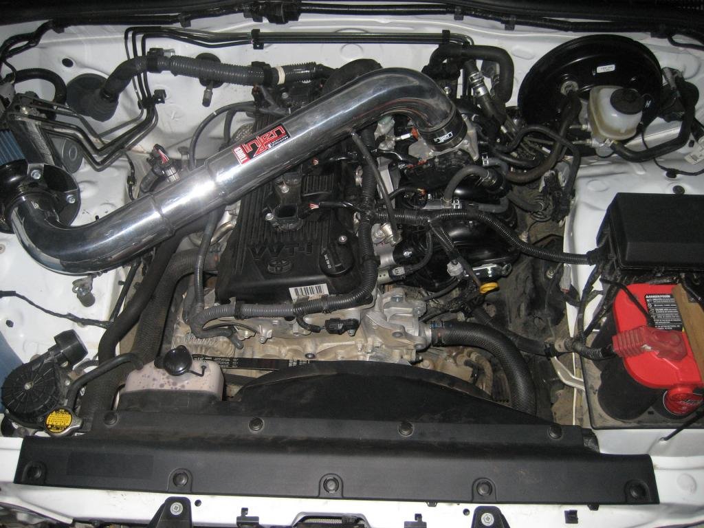

    All of the muffler dyno tests were done with exactly the same bolt on components installed:
    tooter intake manifold spacer
    LCE long tube header.
    The relative differences between them should still be about the same even on a stock engine since a muffler is the component which is the farthest away of the engine.
    Greg
    This is how much the torque peak rpm was lowered for each of the components so you can compare the relative improvements to each other
    Stock 3,800 rpms
    LCE long tube header 3,150 rpms -650 rpms
    tooter intake manifold spacer 2,900 rpms -250 rpms
    Flowmaster series 50 muffler 2,800 rpms -100 rpms
    The header yields the most improvement per dollar spent so it's the best investment. All of the testing was done with an extra long 2 1/4 inch diameter exhaust running all the way out the back bumper.
    This is slightly smaller than the stock 2 3/8 diameter exhaust. Large diameter exhausts kill off low end torque in exchange for high rpm horsepower. I don't care about top end performance, only low rpm pull from idle to 3,000 rpms when the exhaust is underutilized. So I lengthened the plumbing in four places on both sides of the engine...
    1. intake,
    2. intake manifold
    3. exhaust header
    4. exhaust pipe
    ...in order to enhance the low end torque. In my work, the truck is crawling around steep winding roads carrying a heavy load at very low rpms all the time so this setup is perfect for my needs.
    Producing more torque while reaching peak output at only 2,800 rpms makes for quite a different engine. ;)
