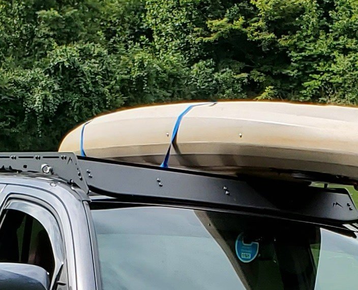

    I use a Martin offroad rack to carry my kayaks. Works like a charm and maintains a lower profile than a J rack attached to the cross bars. 20200725_061842.jpg

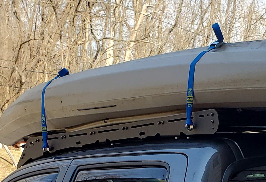

    how do you secure them? I’ve got a prinsu, looking to haul my kayaks too

    I use NRS loop straps now, that was an older picture with ratchet straps.
    I have eyelets attached to each side panel and I attach the straps to those. 9ft works for 2 kayaks and 6ft straps for 1.
    When I only take 1 kayak attach the strap to the cross bar in the middle of the bar, across the yak and attach it to the buckle that is attached to the eyelet 20210310_114423~2.jpg 20200827_113009~2.jpg

    looks awesome!
