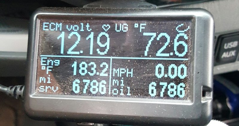

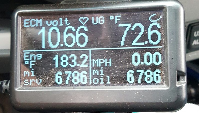

    So my stock battery is almost dead from taking infrequent very short trips. Resting voltage 12.2v, when I crank starter it drops to 10.5v per my scanguage. Can this be bad for my truck? It still starts with no problem. Should I squeeze the last life out of the battery? I carry 2 LIPO jumpers so having the battery die away from home is ok ...

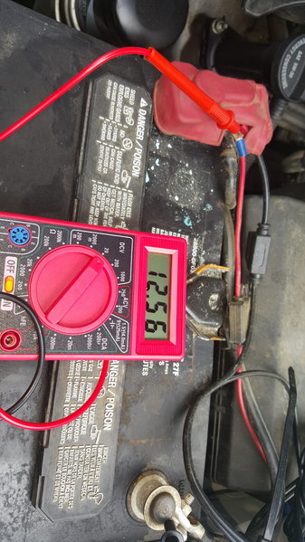

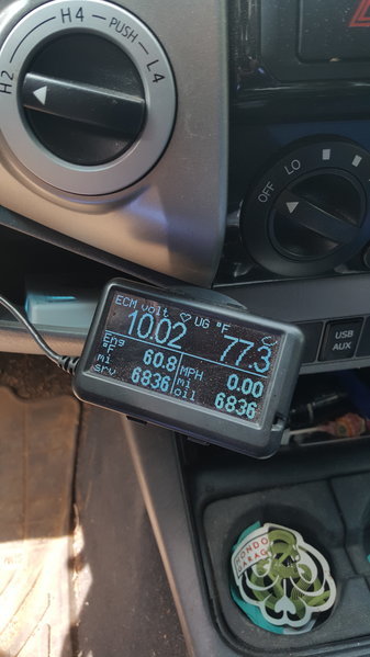

    So I tested my resting voltage again today after 24hrs sitting and it is 12.55v , but still drops to 10.5v while cranking. I have an appointment at the dealer to have the battery tested and they said since under 3yrs/36k they would replace it if faulty. Neither walmart or costco carry the 27f, only 24f. All 3rd Gen come with 24f but I am hoping the dealer gives me a brand new 27f. Wondering if trip to the dealer is a waste of time because > 12.5v...? Or is the cranking voltage a good indicator of battery health/failing ?
    Recently after short trips my resting voltage has been as low as 12.2v.

    The no-load resting voltage of a flooded cell lead-acid battery is a nearly meaningless value, it's not until a load (any load really, even 1 or 2 A) is applied that voltage readings as a measure of condition have any relevance; that said 12.55 V is lower than I would like to see it.
    A (battery should hold 11.4 to 12+ V), or preferably rating (battery should hold 10.5+ V, will tell the real story. A (most reputable shops and FLAPS use these) can be very reliable, when a battery falls off to 80% or less of it's CCA rating it's time to start shopping.
    10.02 V while cranking If tells it all--the battery is toast. If all the dealer does is measure the no-load voltage and say all if fine tell them they are full of crap; and demand to see the service manager, or owner if necessary--or give them my number and I'll chew them a new butt hole...

    Great thanks for your answer it confirms what I thought. With the key in the on position , stereo/headlights/climate control/dashcam /overhead light OFF, the voltage drops to 11.95v, so even the smallest of loads drops the voltage significantly
    Also while cranking I saw 9.50v, but was unable to capture it with my camera, even with rapid fire

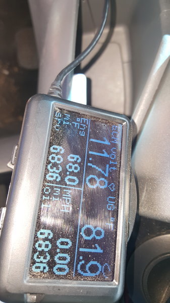

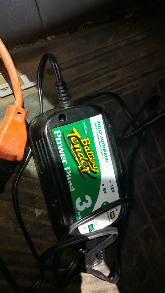

    I just charged the battery for 3 hrs from the above resting voltage of 12.55v with my 3a battery tender. Unhooked the charger, turned key to ON position with headlights ON. Voltage immediately dropped to 11.78v.. this is still within the parameters of a healthy battery but I think the cranking voltage and that I have seen 12.2V resting on several occasions tells me that it's time for a new battery. Hopefully the dealer agrees and this is pain free wallet wise..
