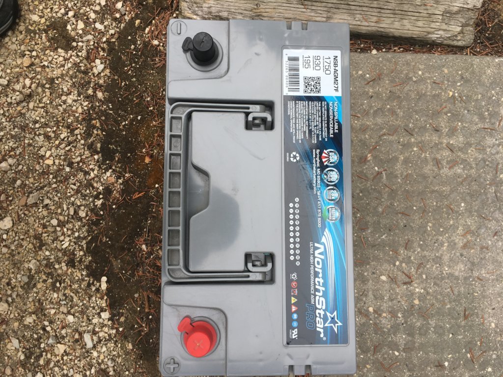

    Have a 2nd gen 07 Tacoma and live in Montana, temps can get down to -40F at times. Currently have a x2power battery (https://www.batteriesplus.com/product-details/auto_light-truck/battery/x2power/sli27fagmdp), which I got in October 2023 but it stopped working due to cold weather in January of 2024 and had to get replaced. Weather has gotten colder (-30f) similar to when it broke last time and have been unable to start my truck without someone jumping it even if I ran it a few hours prior in 10F. The battery is still under warranty and could get a replacement. Although I am wondering if anyone else has experience with these cold climates and found a battery that will hold up.

    I’ve got one of these. Hasn’t let me down once.
