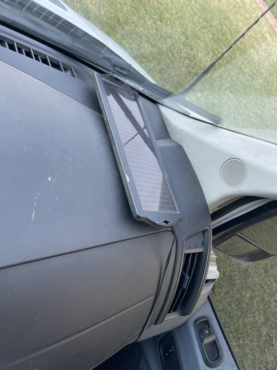

    In my work truck I stuck it up on the dash with double sided tape. In the picture, I just set it up there for temporary, plug it in Friday after work so it’ll start Monday morning. In my other work truck, that got smashed and had a hole on the battery, it charged enough to charge my cell phone and tool batteries.
