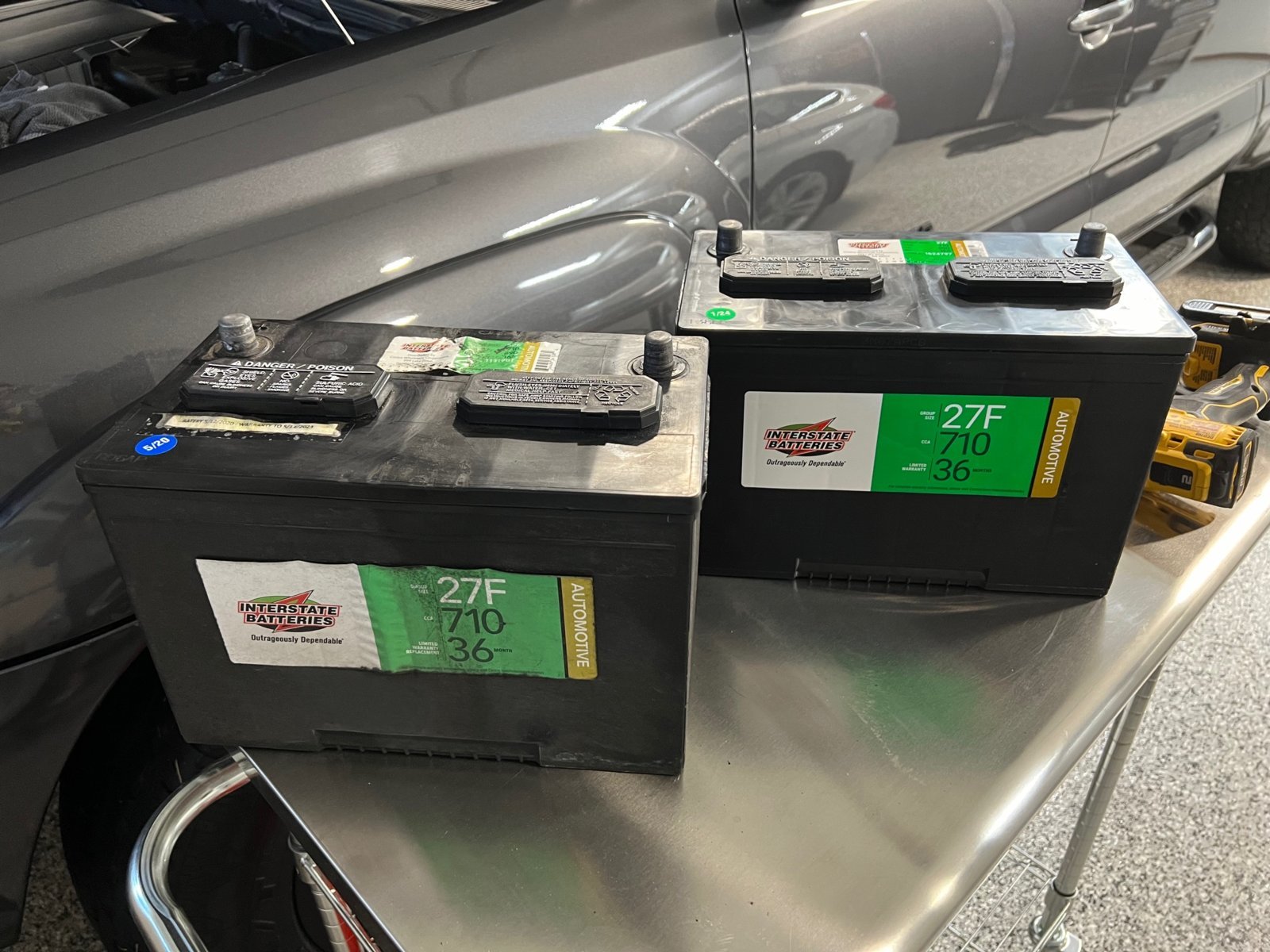

    My original lasted 5.5 years.
    Replaced it with an Interstate 27F from Costco. At 3.5 years old the sound when starting was a little different, just slightly more strained. (You folks and I would notice it, but most people wouldn't!) It never left me stranded/needing a jump start. Stopped by Interstate and they tested it, said it was down a bit but I didn't get the numbers. Said I should plan to replace it soon.
    Proactively replaced it with the same thing as it's only $110 at Costco. Not worth it to me to wait for it to die.

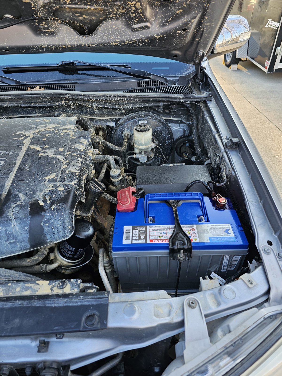

    My '09 Tacoma was built in November of 2008.
    In October of 2014 (6 years) the OEM Group 27F battery died. I almost died when I saw what Toyota wanted for a replacement. That day, I spliced 2" of AWG #6 wire onto the negative lead (which, according to my notes, cost me <$20 for wire, the correct size butt splice, and heat shrink tubing), which enabled me to use a non "F" battery in my truck. The next day, I bought a Walmart Group 27 Deep Cycle Marine battery for $87 in Massachusetts, and I changed the battery in the Walmart parking lot. In November of 2021 (7 years later), while the battery load/resistance tested OK at Advance Auto Parts, I decided that I was pushing my luck, and bought my second Group 27 Deep Cycle Marine battery from Walmart. This time it cost me $92 with Florida's state tax. I am still running that battery today.
    [EDITING TO ADD]
    EverStart Lead Acid Marine & RV Deep Cycle Battery, Group Size 27DC 12 Volt, 740 MCA = 937.5 CCA - I see that the price is up to $94.
    [/EDIT]
    You do you. However, despite the forum-know-it-all predictions of short circuits and the need for a $300+ AGM battery every 5 years in every vehicle (you guys crack me up); in the 10 years that I have been running with the extra 2" of negative lead, and Marine Deep Cycle batteries in my truck, I have had no DC or battery related issues! MY total cost for batteries in the 15 years that I have owned my Tacoma has been <$200.
