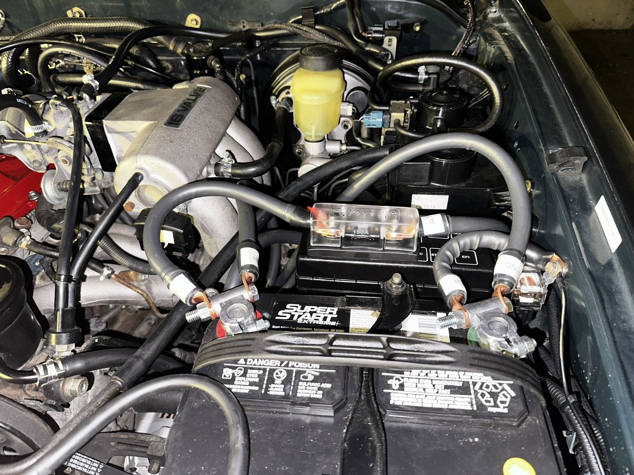

    Who makes that hold down/mount?
    I was going to rig something to attach to the oem mount to hold an mrcb.....but a lot cruder!

    @paranoid56 made it for me. He does some awesome stuff, and his pricing will make you feel like you stole it :rofl:. It holds LMI fuses
    https://www.mouser.com/new/eaton/eaton-lmi-bolt-in-fuse-holders/ As configured, I could fit 5 fuses on there. Right now it has 4, one of those is a central post that connects to the battery. Hit him up, and I am sure he can customize something if you wanted, or he can cut another one like he did for me.
