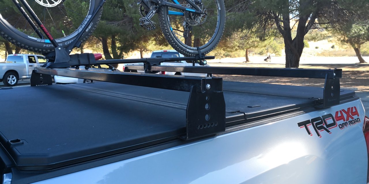

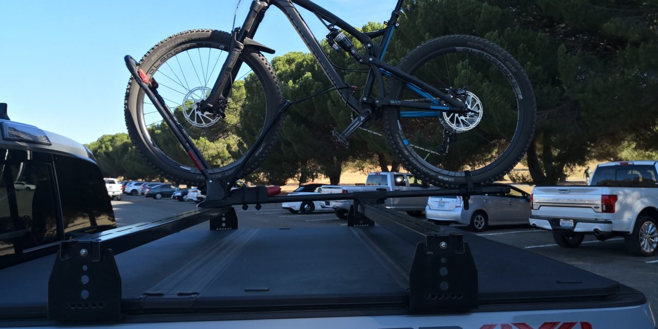

    OEM trifold cover with voodoo Fab hi-rise bracket with crossbars and Yakima bike rack
    primodude, Alden, hossler1788 and 2 others like this.

    They can either use thumb screws, or in my case it was tamper proof screws (need a special allen to loosen). If you use thumbscrews, they'd be on and off in minutes and will give full use of the trifold
    Frsh2df likes this.

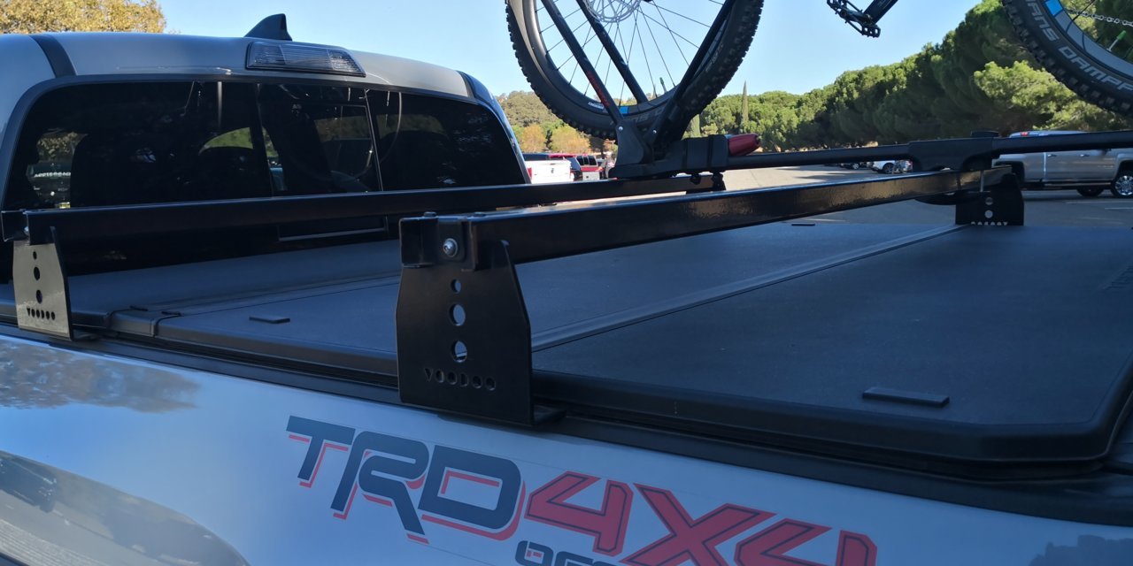

    I'd love to see a closer up pic of the rails and bike mount. Thanks!

    2019 Tacoma OR DCSB
    The yakima rack is fairly narrow. So my guess is yes, you can possibly squeeze 4 in there, but the bike handbars will be getting in each others way, unless you stagger every other bike rack (front, back, front, back).

    I'll take more pics for you this afternoon. I daily my 04 Tacoma and leave my 3rd gen for the weekends :D

    Any closeup pics available? I like the look of this setup. Thanks in advance

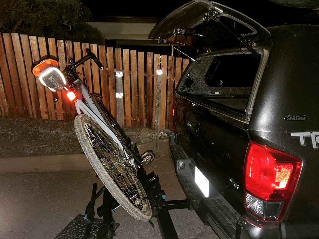

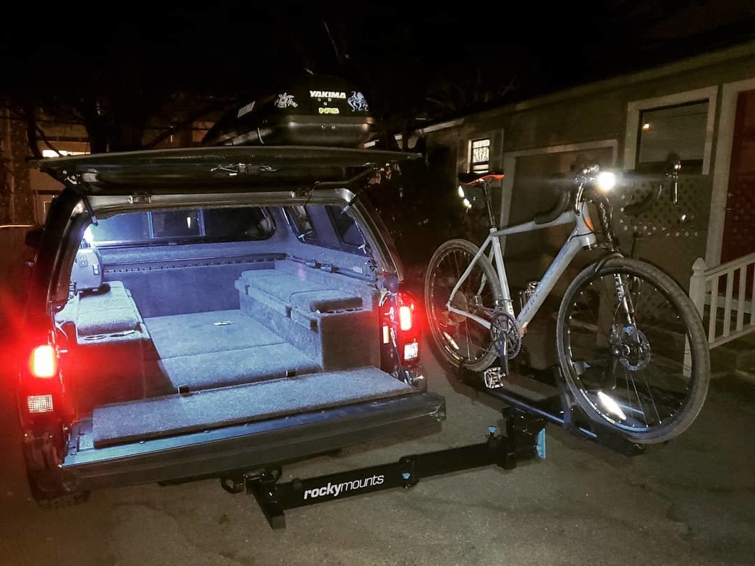

    I just got the Rockymounts Backswing and I'm liking it so far!
