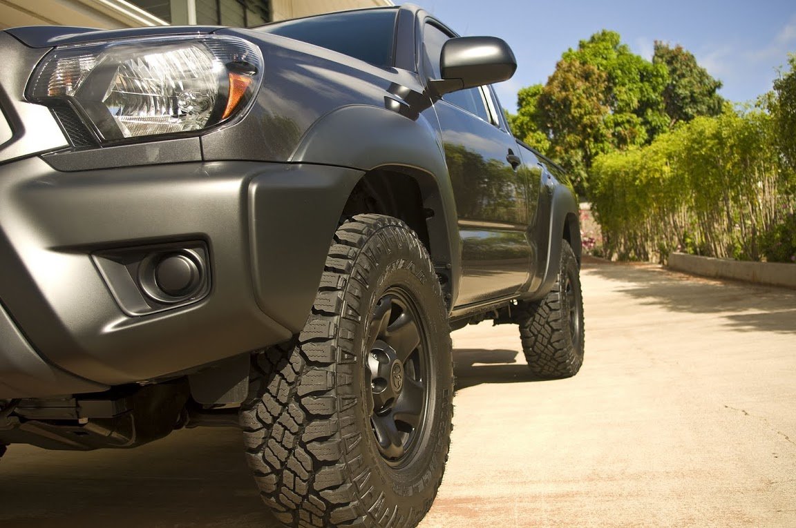

    krylon satin black (over primer, after sanding/scuffing), no clear:

    See I like that satin look but your (plural) tires are nice and clean and deep black. Looks great.
    I'm just worried that my tires have that grayish/light brownish hue to them most the time and the negative contrast is something I really don't like.

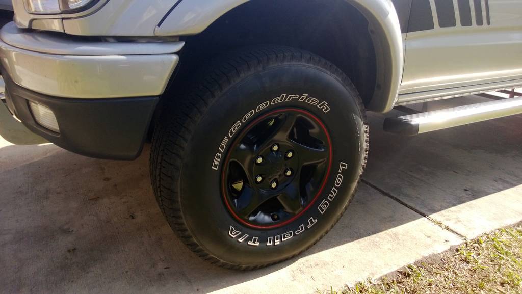

    Plastidip :anonymous:
    Don't mind the wheel weights, I just had the tires mounted and balanced before this picture.

    Did you plastidip over the weights eventually?
    And how does it hold up for wheeling?

    Yes I did, I don't think I have any recent pics of the wheels though. I would say they hold up very well and you can easily apply another coat over spots that get scraped. I think plastidip is the better way to go for painting wheels on a rig that gets wheeled personally.

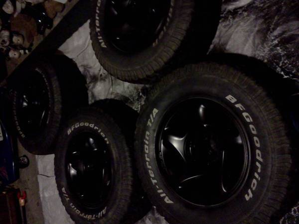

    I think 1-2 cans for all four wheels iirc. I would maybe buy 3-4 to be safe so you don't have to drive back and forth to the store if you run out.
    The best way to do it is to take the wheels off, wipe down, allow to dry then spray them with plastidip.
    Here's a pic of my old wheels.

    Did you do the index card trick (between the rim and tire)? And did you mask the actual tires to prevent overspray getting on the tires?

    I didn't mask at all, overspray can be peeled off easily so I wasn't too worried about it.

    That does. Love the wheels. And it's not so bad with the faded tires truthfully.
