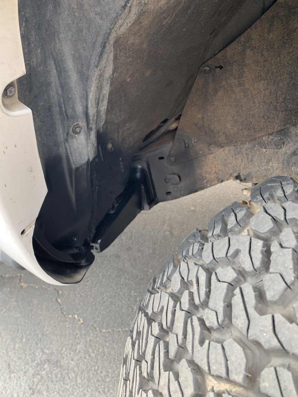

    Oh man, I bet it was one of these styles. I never liked those.

    The ones I was approached about were from two seperate companies. But both attached just like that one does.
