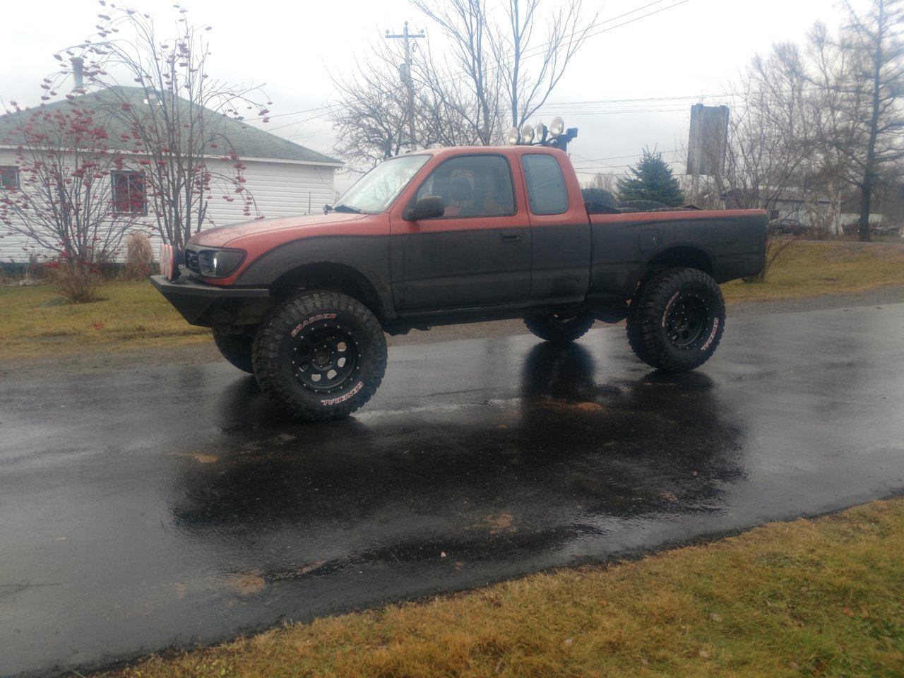

    im tubbed and 1.75" cut from the fenders.

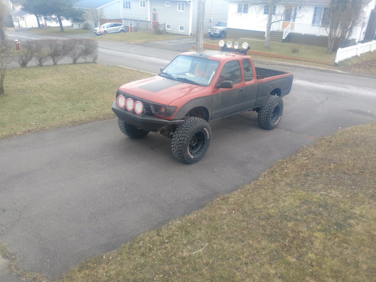

    Looks like you have a nice stance. BTW, is your washer reservoir even in the wheel well? My buddy Todd's '95.5 has it on top of the fender well under the hood. I'm not sure what year they started putting them in the wheel well where the tire could grab them.
    Did you do your tubbing with a BFH or did you actually cut and weld (or fiberglass like one guy I spoke with did)?

    you need to cut. no way your beating the inner fender in that much. i used fiberglass

    Been done on a 3rd Gen T4R I know of personally, so I don't see why it wouldn't work on a Taco. Just need a big enough hammer. :devil: I'll burn that bridge when I come to it though. I won't be on 35s until Interco introduces the tires I want which will be late February at the soonest. With a 2" body lift, and all else being equal with my tire width and Set Back, I should clear them just fine. It'll only be a problem if I want to widen the stance for more side hill stability. I've had it leaning a little over 30* with my current configuration and it's felt pretty planted...at least the truck did. My butt in the seat...well, lets just say I was leaning on the door pretty hard with my elbow, lol.

    with more backspacing and alignment cams moved to bring lca forward maybe. but with just the pinch weld mod for 32s i couldn't even turn the steering wheel a full turn without tire bringing up.
    heres before cutting the fenders. about 3.5-4" of lift
