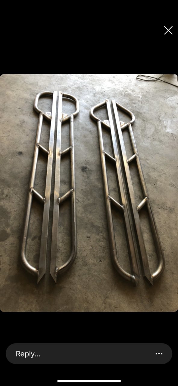

    Having one of my fav fab guys in in SoCal build me a set of sliders (beast fab) and I’m torn between the two kick out styles. I thought I really wanted the less archy style but after seeing some pics I’m completely 50/50. Any technical advantages to either one?

    Are those your only options? A one piece outer tube with a more gradual kick out will be the most beneficial. It’ll allow it to slide around stuff easier. And this design is stronger, with the one piece and straight legs

    Ya there is a one piece design with no kickout. I opted for the one on the left. I’ll post when installed. $680 powder coated and installed
