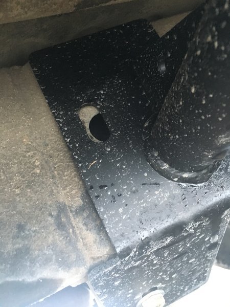

    And did they tell you the design changed from what is shown on their website? I purchased the straight 2nd gen ones and the mounting design I got was totally different than what's pictured and described on the web page. I paid for a shop to do it since the description said drilling was required.. which wasn't so.

    That hole location does not change between access cab and double cab from 2005 to current Toyota Tacoma.

    Wish I had the hardware to know if the bolt fit, didn't fit, or if they gave up because it's hard to get the nut back in there.

    That hole is at the front of the slider where the chassis is boxed correct?

    Yep

    A trick if you don't have the hardware is to do this.
    Get a 3/8-16 x 1-1/2" Long Bolt, Grade 8 preferably and tape the head to the closed end of a box wrench.
    If you have thin arms you can reach up in the boxed portion and stick the bolt thru from the inside facing out, then slip a lock washer and nut on it from the outside. If you got big arms, find someone with small arms.

    Back from the hardware shop.. a 3/8 x 1-1/2" bolt fits like a charm. The install shop was just lazy. This is the 2nd time for me you've helped support a product that isn't your own.. I'm keeping you guys at the top of the list for future mods ;)
