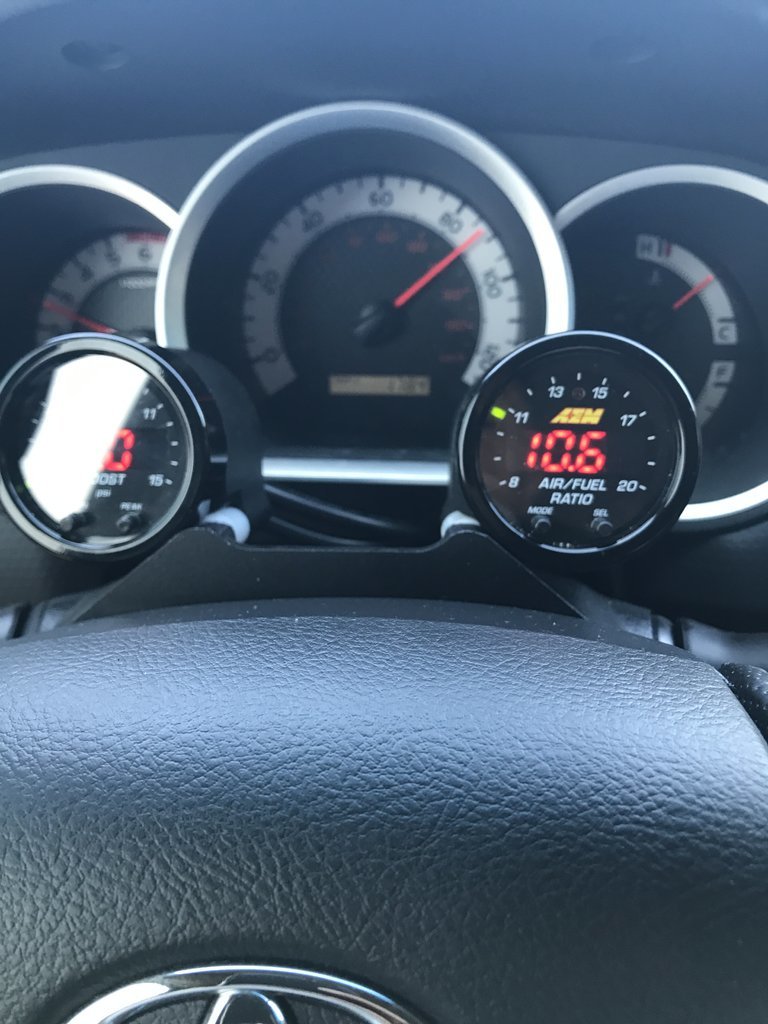

    for the boost gauge, did you just use the Red 12v wire and black ground? Or did you use the AEMnet and Analog (for datalinking) wires?

    Yup .. red 12v and black ground.

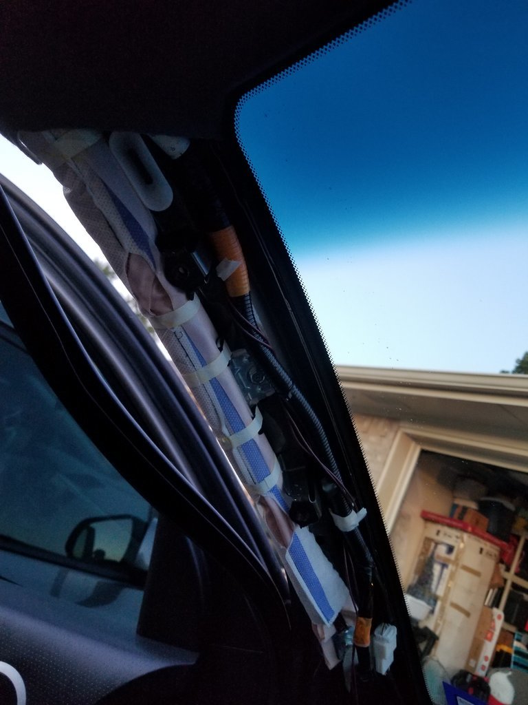

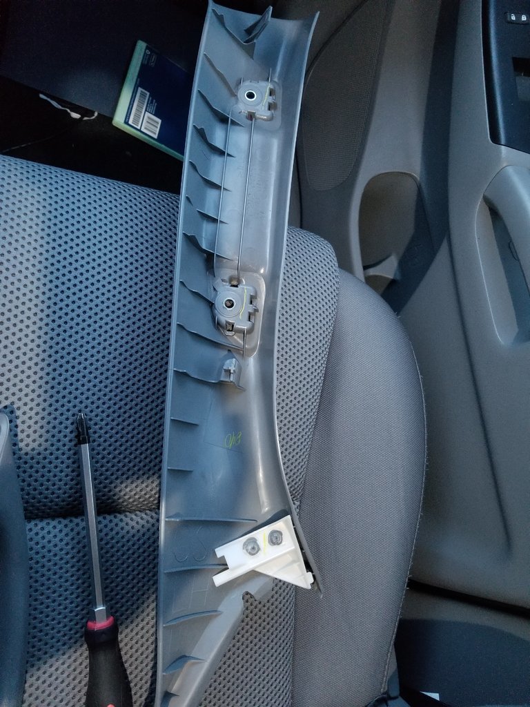

    I will go with the Lotek and notch the backside if need be to allow the airbag to deploy properly. The handle is bolted to the pillar so it won't move. If the airbag deploys it will force the bottom/rear portion of the pillar cover to bend out of the way.20170815_202321.jpg 20170815_202335.jpg

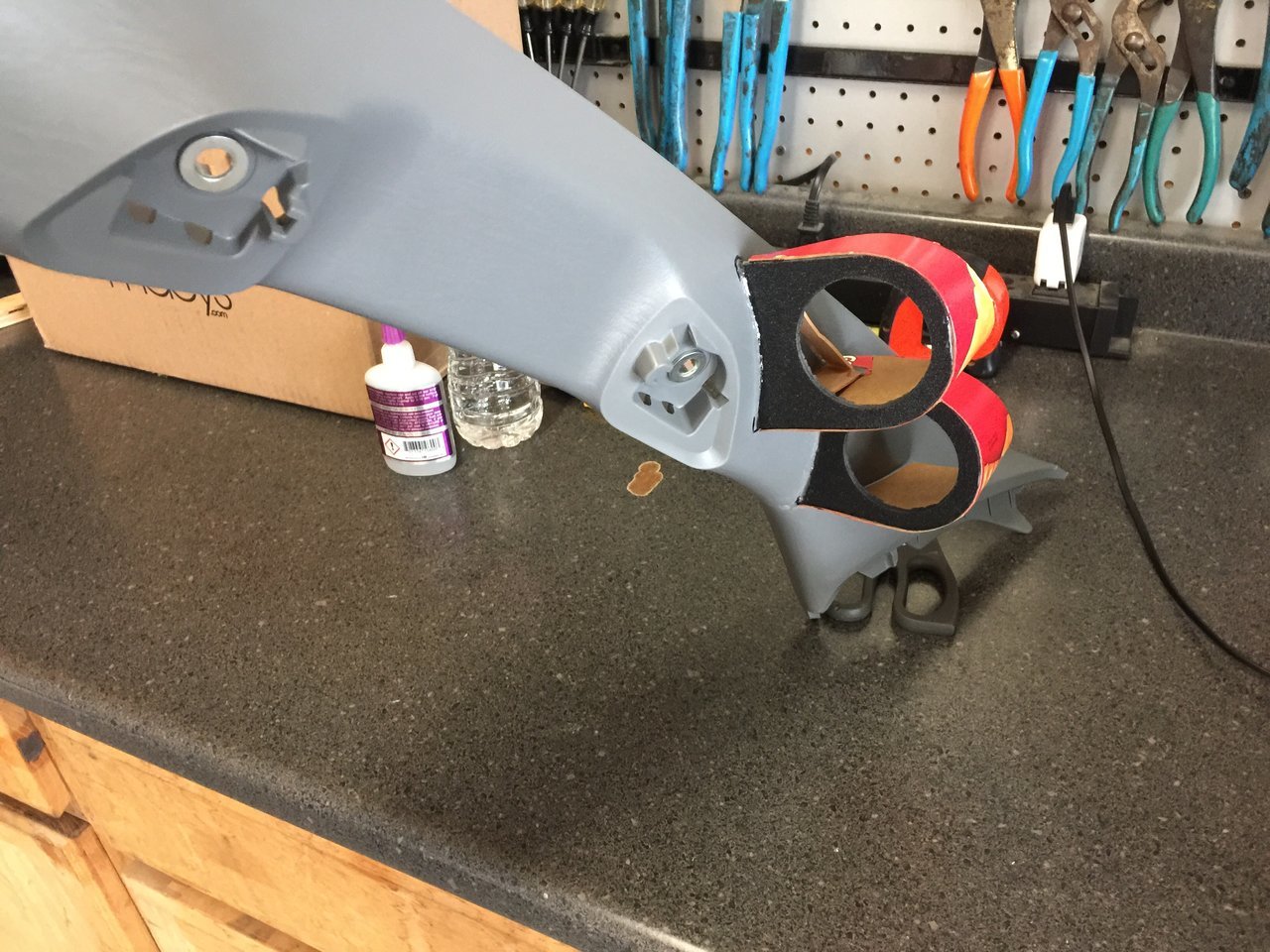

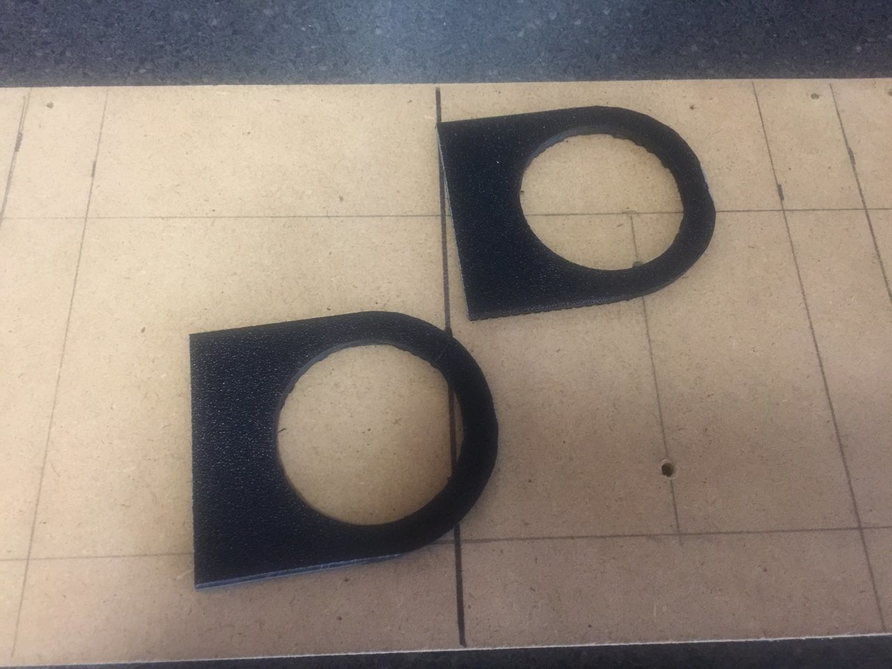

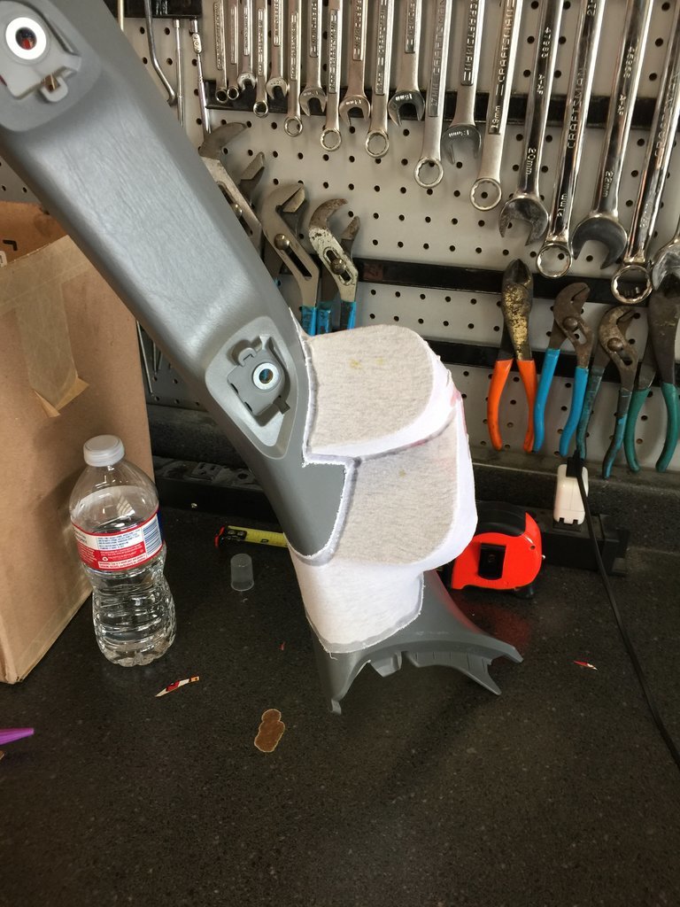

    I'm thinking of just modding my existing a-pillar to house a couple of gauges.
    Test fitting the gauge. Here it looks like an oval plate but it will be cut in half and the attached to the pillar trim.

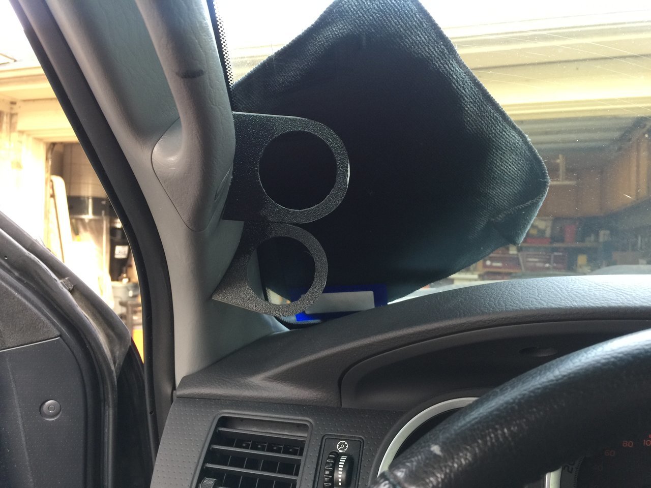

  15. Sep 3, 2017 at 6:53 AM

    Seems like it should work. Some fiberglass, body filler and primer/paint.
    I'll go ahead and get this out of the way...
    BUT, SIDE CURTAINS! :D

    hmmmmm...wires going to be hidden?
    loginfailed likes this.
  17. Sep 3, 2017 at 7:32 AM
    #77
    loginfailed
    loginfailed Well-Known Member
    Aug 29, 2016
    #195923
    5,156
    Dwayne
    Houston, TX
    2014 DCSB 4WD
    Of course!

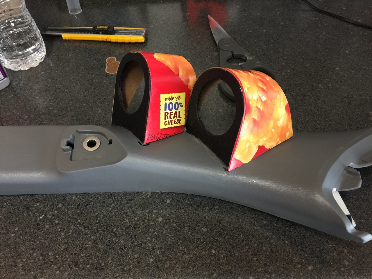

    Cheez-It

    Should work fine. The side curtain air bad deploys behind the handle so your gauge placement shouldnt affect it.

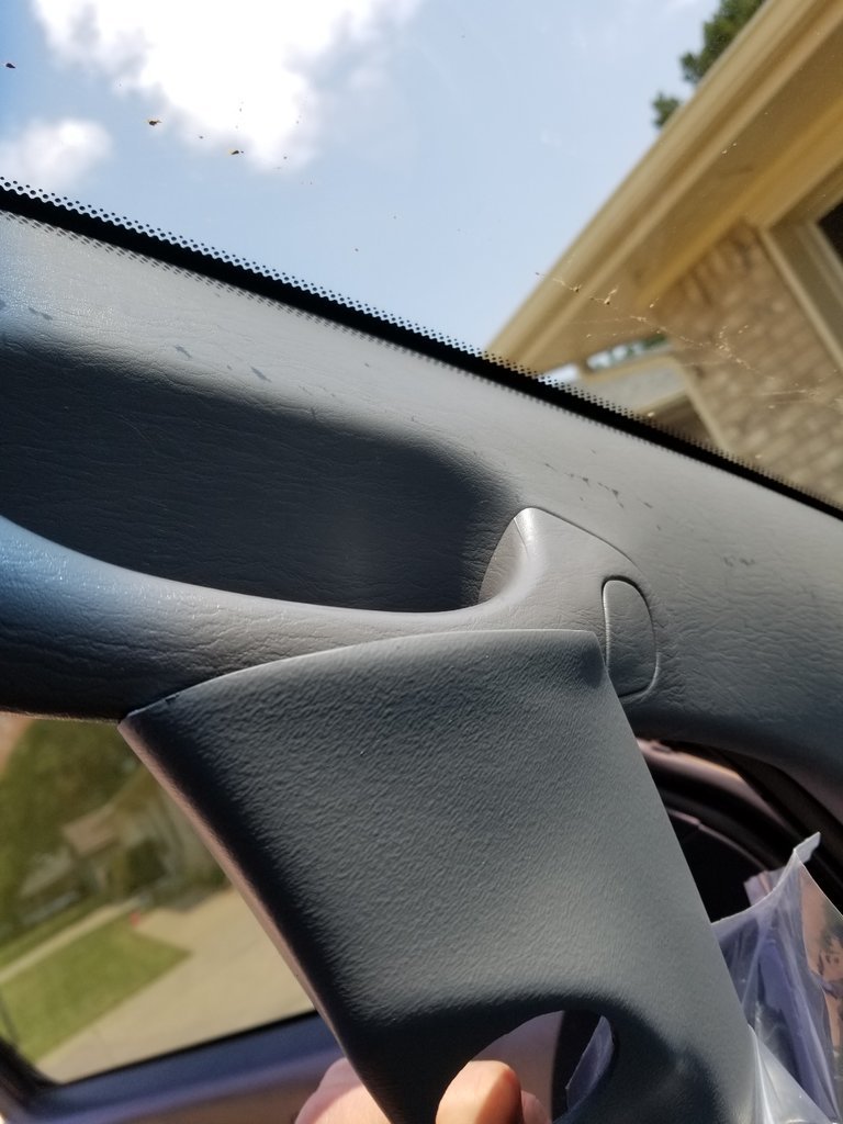

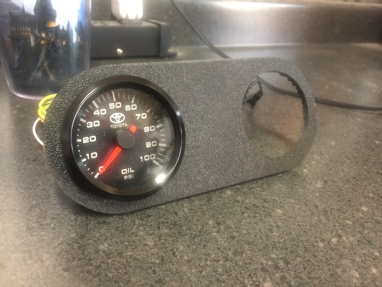

    I did get my gauge POD but am out of town for the weekend so no install. It is painted from Lotek and I thought the gray color was molded into the plastic. Here is a quick pic to check for color match. I wont have time to install it for a couple weeks to determine modifications for fitment.
